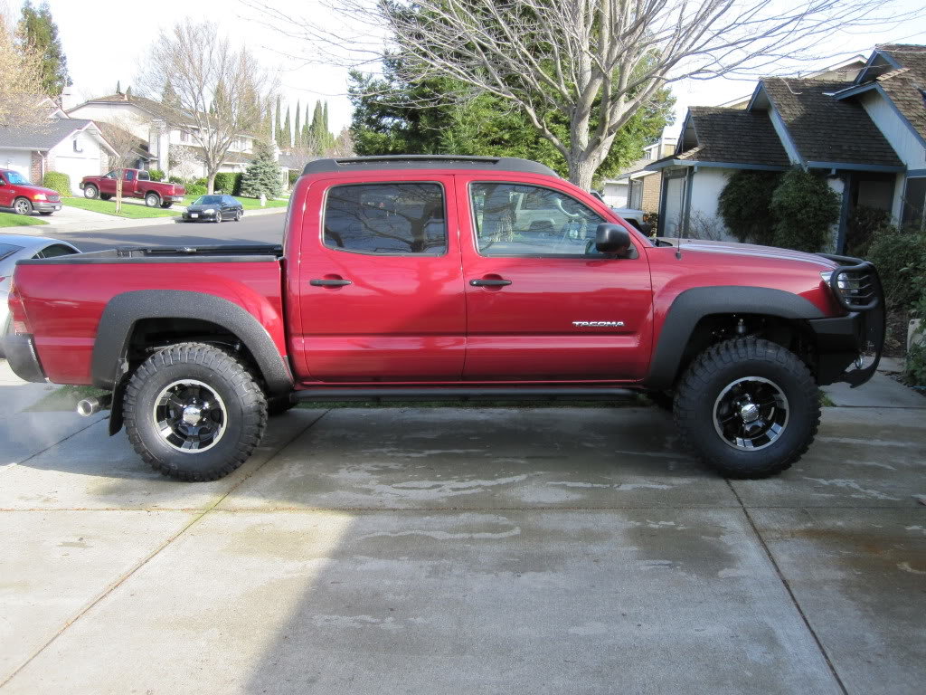

    Side shot:

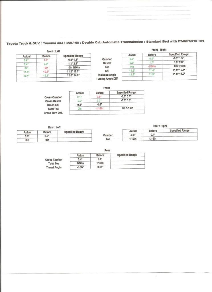

    Thanks. I need to get an alignment done.

    Alignment done, but I still have a steering wheel shudder at around 50 - 60 mph . . . the steering wheel moves back and forth about 1/2" very fast . . . I guess that's what I get for modding.
    I dont' think it's driveline vibration or driveshaft issues, but maybe. It seems more related to vehicle speed than anything else.

    Steering wheel shudder/vibration solved. I had the tires re-balanced . . . problem solved.

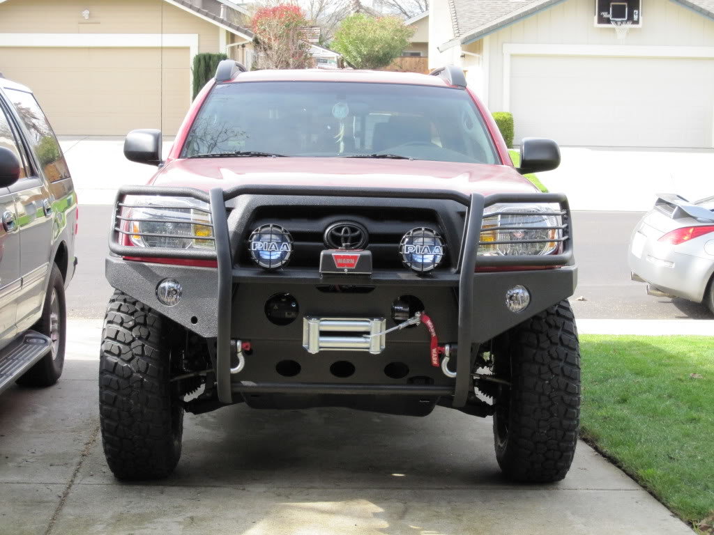

    awesome truck. nice work. really like your creativity with the bumper +1

    Thanks . . . I wasn't sure how it would turn out when I started. I liked the look of the Steelcraft grill guard on top with the function of the All-Pro on the bottom. I did sacrifice approach angle, but overall I'm happy.

    Your front bumper is cool, nice job!
