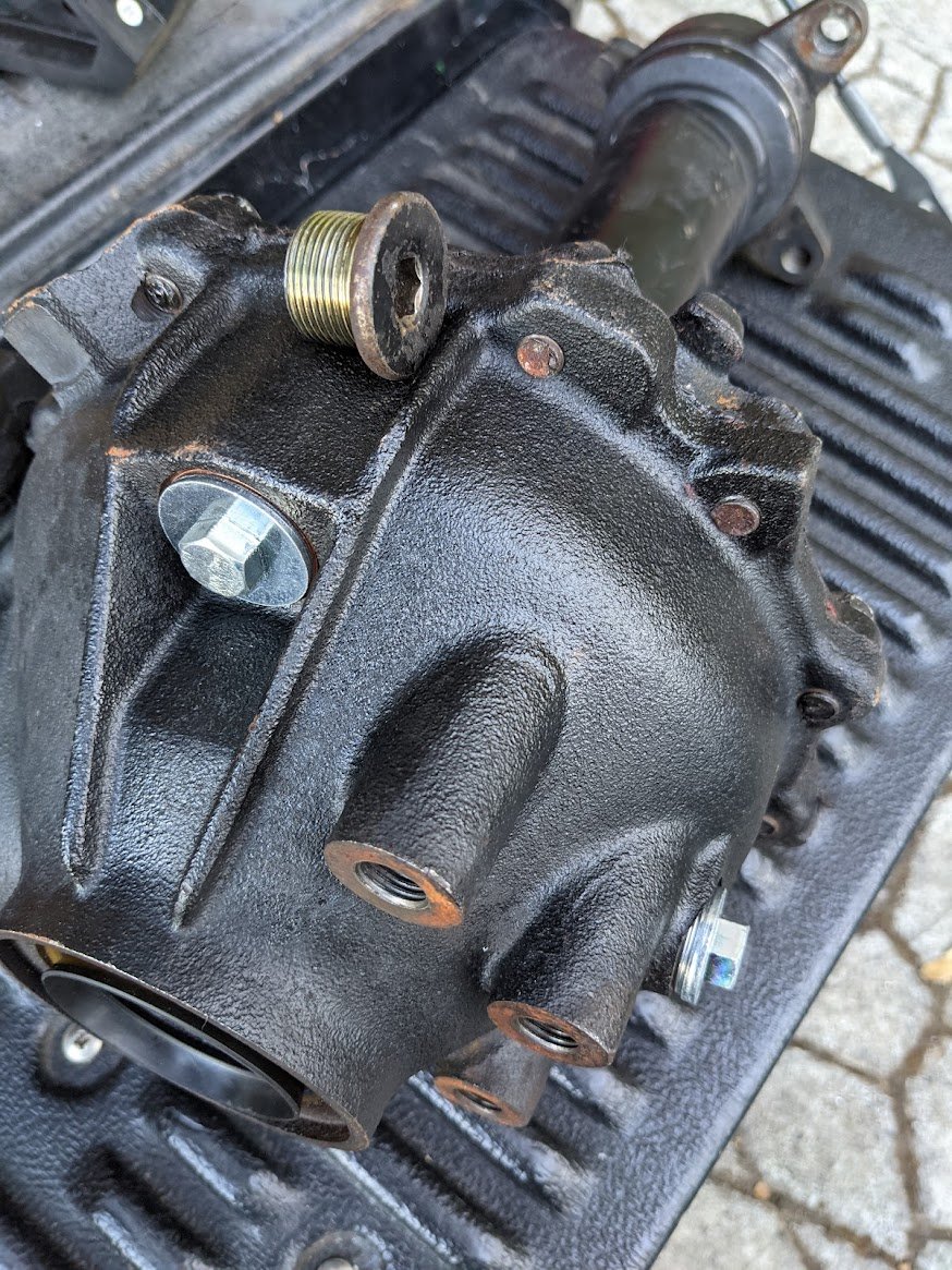

    What is the popular combo of plugs to upgrade all of the 1st gen 4x4 diff/cases/etc drain plugs? Fixing on replacing the beat up allen style ones with good ole' hex nut style. My OEMs are so beat they need air chisels to get taken off.
    I have a 90341-24016 for the front, but curious what people have for the others. Heck for the fill ones too.

    Right, when everything is done correctly, there isn't an inherent issue with the bolts. But this is real world, for my vets out there, I'm looking for sailor proof, not "if you followed the instruction..."
    I already have the one I listed, it is Toyota OEM, has the right thread, pitch, length, magnet etc, but simply is a bolt head style and not allen. Looking for the rest. Sailor/Soldier proof. Murphy likes to be in my life way too much, so I love me some mitigation.

    I used Toyota parts to replace the fill and drain bolts on my front diff while I had it out and empty. Can't hurt.
