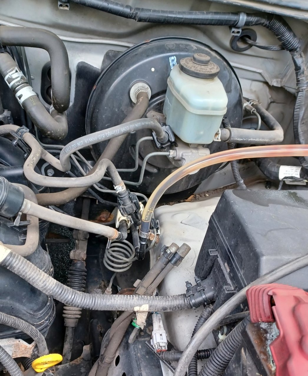

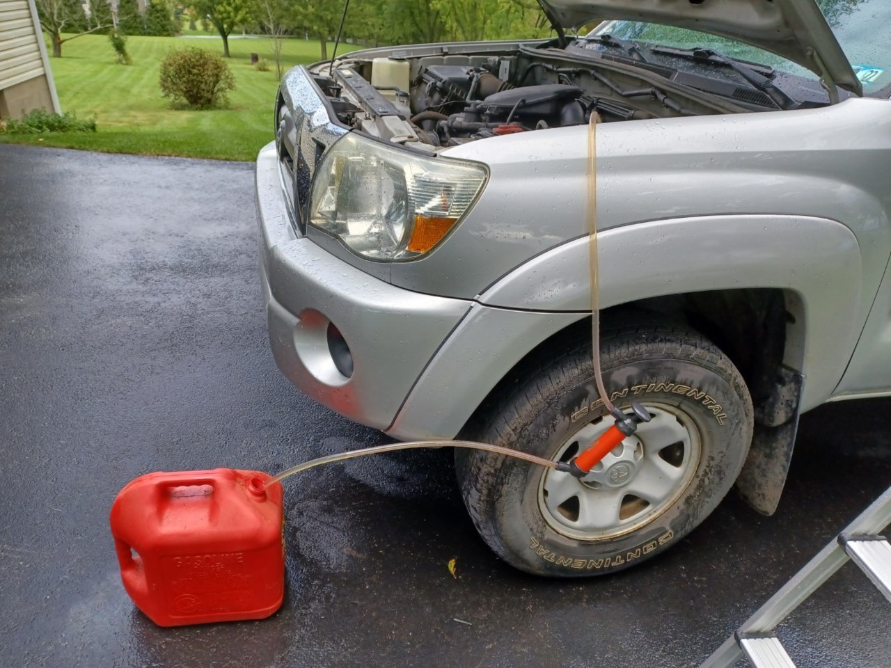

    My 2007 Taco has 197,000+ miles on it so it was time to trade it in. The new Taco arrived unexpectedly at the dealer's yesterday - right after I filled the gas tank in my 2007. The sales rep said the 2007 would go straight to the auction, so I feel no qualms about leaving it with minimal gas in the tank. I couldn't figure out how to get the fuel pump to turn on and pump gas into my gas cans, so I connected a cheap Harbor Freight pump to the fuel line as seen in the photos below. The 'guard /cover' on the rapid connect clip had me fooled for awhile. I spent an inordinate amount of time removing about 7 gal of gas and would like to remove a little more. Is there an easier way? I am aware that some advise removing the bed and going straight to the fuel tank, but the bolts to to the bed are pretty well stuck so that would be more effort than the crude siphoning method. Again, is there a way to get the pump to do the work?

    That's what the internet would suggest too, but I couldn't make it work on mine. There are two relays labeled EFI and each has 4 pins. I tried jumping each pair (one at a time) in both relays and couldn't make mine work. Somewhere on the net I read that it can't be done on Tacos because of some other sensor or circuit, but I can't find that thread again. My recollection was that whoever said that said the "ECU" prevented jumping it with a paper clip method from working, whatever the ECU is - and I can't confirm that that's even true. I was hoping someone here had done it.

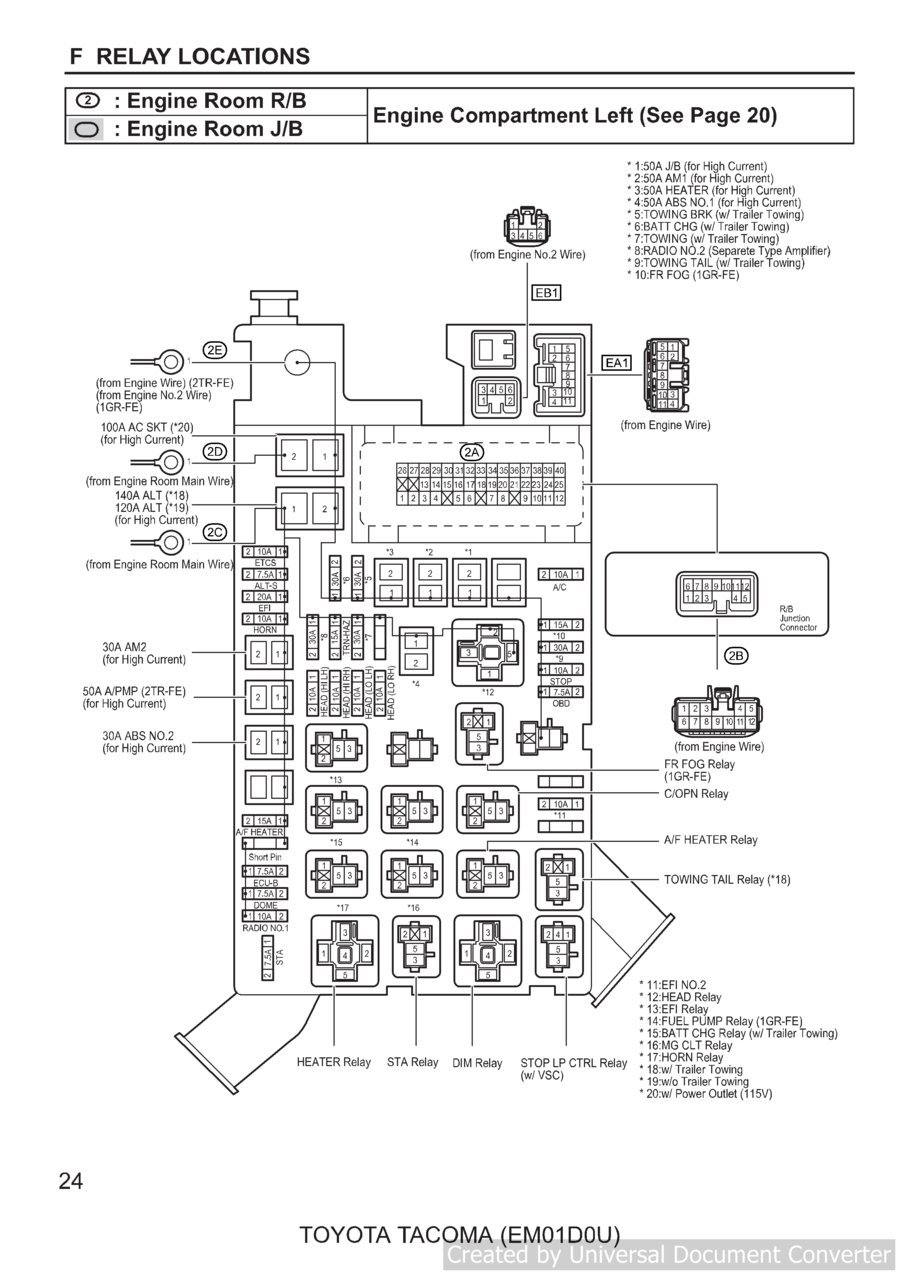

    It is labeled COPN relay on Toyota's, jump the 2 larger pins (3 & 5) together with the key on to run the pump.

    The C/OPN was one of the two relays I tried although I had called it an EFI relay. The 10A fuse immediately next to it is the one for the fuel pump and I can hear a click somewhere when I pull and insert that fuse. I thought I had tried jumping both pairs of pins (separately, not both at the same time) but maybe I forgot to try the other pair. I looked on the relay and the socket for the pin ID but there isn't any. Which ones are 3 and 5 - the pair of pins at the top of the "T" or the pair in the stem of the "T"?

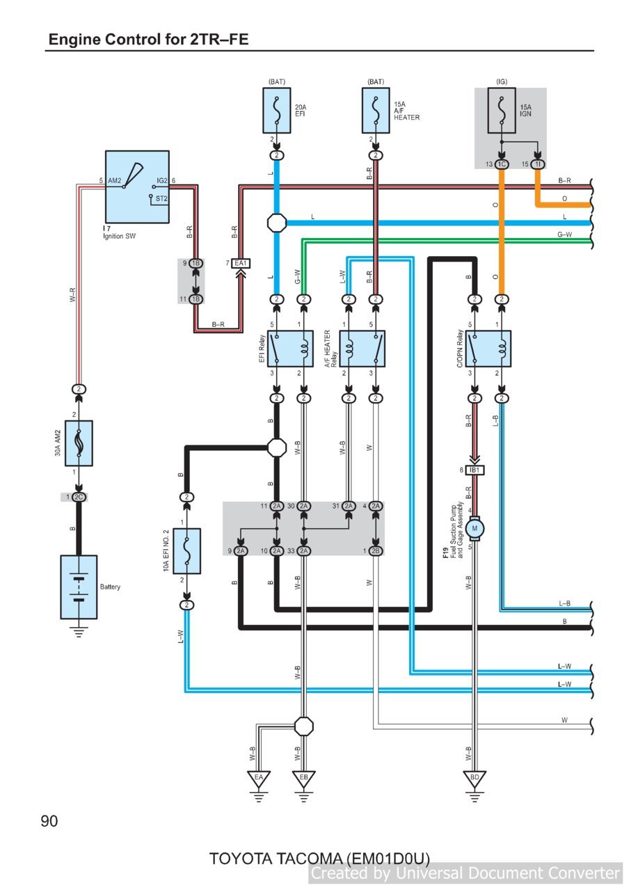

  20. Sep 22, 2022 at 5:15 PM

    Thanks DM93. Pins 3 & 5 are the ones in the stem of the T in both the C/OPN and EFI relays for those looking at this thread in the future. It's dark out so I won't try it any more tonight but I will tomorrow afternoon. I'll start with jumping the 3/5 combo on the C/OPN Circuit Opening Relay first. If that doesn't work, I'll also jump the 3/5 on the EFI - Fuel Pump relay and see if both need to be jumped. Surprisingly I couldn't find this information on how to drain a Taco tank elsewhere on the net despite this generation of Taco being around for over 15 years. Nobody else seems to have described how to drain the tank on Tacos using the fuel pump. Thanks to all who contributed to the knowledge base.
