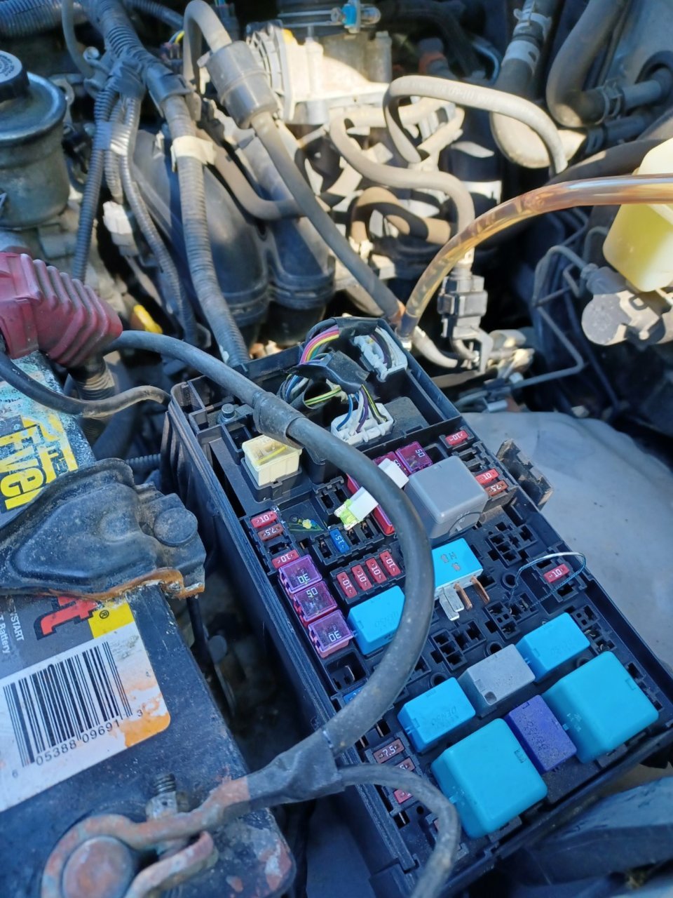

    If you had a V6 all you would need to do is unplug the fuel pump resistor and apply power to the Black/Red wire but the 4cyl doesn't use the resistor.

    HOw about a drill pump?

    Remember you have to have the key on or the EFI relay will not be energized and there will be no power at the COPN relay.

    It's very difficult to pull fuel through the factory pump no matter what kind of pump you are using, you may get a slight trickle but that's about it.

    Although I'm working outdoors, I'd be a little concerned about the sparks from the drill motor. The risk is probably low however. The pump in the truck is already there and it seems like that's what people who own vehicles from other manufacturers are doing to drain fuel tanks since you can't get inside the filler neck to siphon gas any more.

    Yup. I had the key on. I was following the procedure I saw in a couple of videos on youtube. They're all similar, but none of the ones I found were dealing with a 2nd gen Tacoma.

    At this point I have enough out of the tank that I wouldn't feel too bad if I don't take any more out, but I'm curious if it is possible to use the fuel pump to remove fuel from the tank on Tacomas like it is on other brands and what I may have done wrong when I tried to do it. I'll follow DM93's suggestions tomorrow to see if I can make it work just for the proof of concept at this point. Someone else will make use of the information in the future and I will have learned something.

    I know it can be done, I do it fairly often on vehicles with easily accessed fuel pump relays to empty the tank when replacing fuel pumps if they will still run at all.
    Only difference is I use dedicated relay tools instead of shoving a pin or wire in the slot.

    Crimp a male spade connector to a 2ft piece of wire. touch one end to the positive of the battery and take the spade connector and For a:
    • V6 truck - pull the fuel pump relay - supply 12v to pin 4 of the socket
    • i4 truck - pull the cpon relay - supply 12v to pin 3 of the socket
    The fuel pump will turn on and start flowing fuel.
    Literally as simple as that.

    For proof of concept I just wanted to verify that jumping pins 3&5 on the C-OPN relay works. The fuel pump activated and fuel started flowing. The 20A EFI fuse is the one that controls the pump and I used that as my under the hood switch. The procedure is remove C-OPN relay and jump pins 3&5 [the stem of the 'T'], remove 20A EFI fuse, turn on ignition. Put fuse back in and fuel pump is activated. It took a few seconds until I started to see the fuel coming up in the hose. Photo below. You can see a few bubbles in the tube. Thanks to all with experience who added their knowledge to the discussion.
