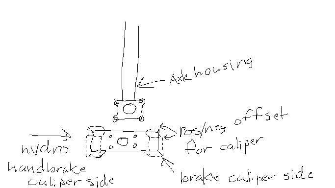

    Ive been thinking about this for a while myself. The biggest hurdle is building the bracketry for the extra rear brake caliper, a hydro handbrake needs a dedicated caliper. It wouldn't be terribly difficult to make the bracket itself, its more getting a truck to take apart and get all the necessary measurements. You would need a one piece back plate with 4 holes drilled to mount to the axle, and then two sections coming off in opposite directions for mounting each caliper with two threaded holes on each section, or two through holes and some nice hardware. The backing plate part is easy, but the outer sections would need the proper offset for whatever rotor you plan to use. Here is a rudimentary paint drawing to get the idea across:untitled.jpg

    Also, that prerunner does not have a hydro handbrake just for the record. It has a manual T-case shifter with a green handle on it.
