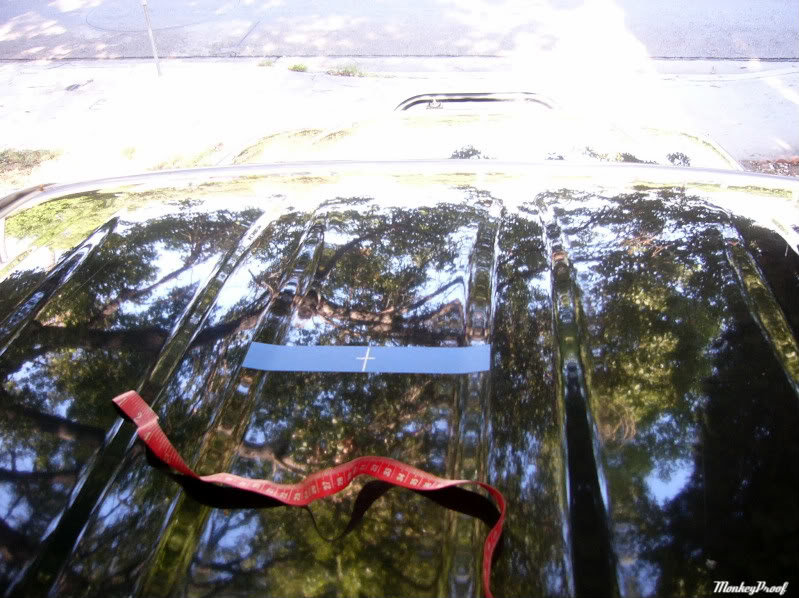

    when i run my 5/8 wave antenna that sucker flops around and will hit my mag mount CB antenna, it's annoying when they hit each other..when it's really flopping around i can hear the sheet metal buckling as well. so i wouldnt recommend hard mounting a CB antenna on the roof unless it's a mag mount such as the Wilson "Lil Will" antenna.
    EDIT: here's how i marked and lined my hole i drilled..
