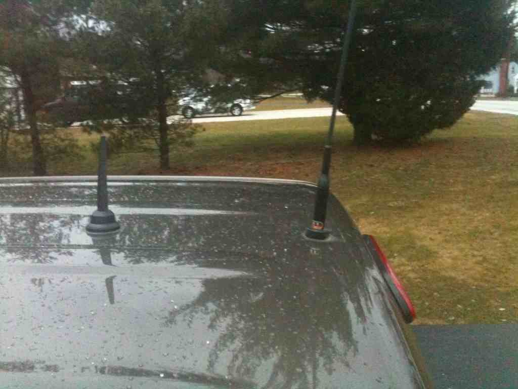

    They won't inspect it, but often the vehicles come back for other reasons, such as radio programming or swaps, power issues, etc. At this time we do inspections of their cabling to head off future problems.
    It is not a scientific study, it is just, there is a TON of unprimered, totally bare metal inside your cab. If you ever look under your dash, you will see piles of it. None of it ever rusts, or at least very rarely.
    If you do it properly and keep the elements out, it should not rust without the presence of an electrolyte (like non pure water). If you mess it up and it rusts, well then thats your fault, not the fact that you did not primer the bare interior metal.
    I've seen the outdoor NMO connector corrode like crazy after years in the elements etc, but I've yet to see any real body rusting on the inside on a proper install.

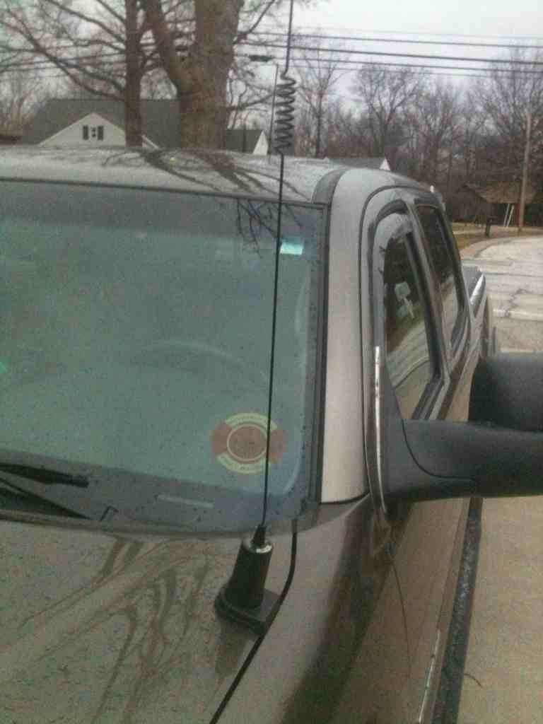

    I have had a matrix and now my taco and had multiple nmo mounts in each and never had an issue. The matrix was 3 days old before I drilled 2 antennas for CB and HAM stuff. Those were in for 8 years. Never any leaking. The taco was a week old drilled 2 for HAM and a cell repeater. Also have a lip mount on the front driver fender. I have done all mounting myself with a standard 3/4" hole saw. Just take your time
