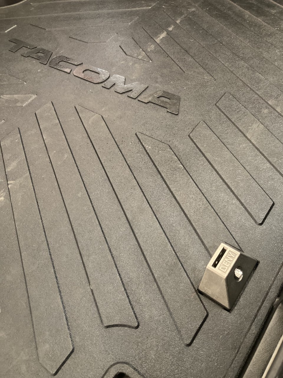

    Drilled mine and cut bed mat for a DENY lock.

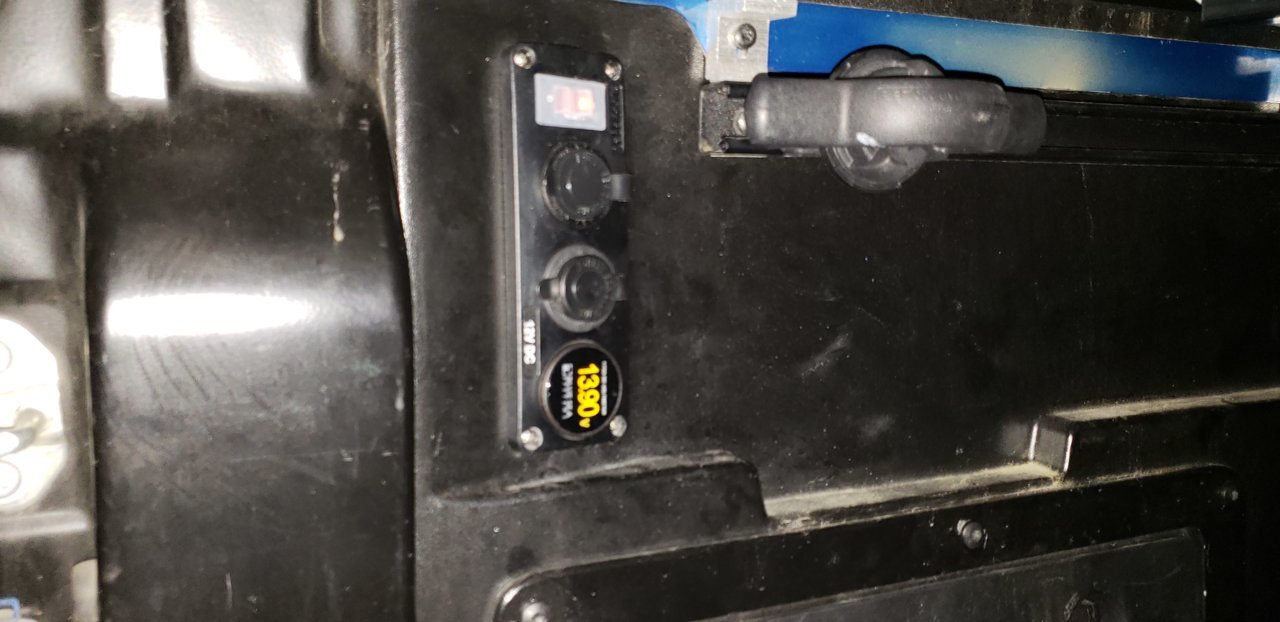

    I put a hole in the left side rear to mount a Bluesea power panel. And two drain hole at the front for the tonneau cover drain tubes.

    Can you post a photo of your mounting location? I assume you ran power lines under cab and up to battery?

    I ran a bundle of wires a while back when I installed my tailgate actuator. So I already had a 10 gauge power and ground I just had to terminate to complete the install.
    Originally there were 2 usb charge ports and the 12 volt accessory socket. I replaced one of the USB sockets for the voltage gauge. Always good to know battery state of charge while using the ports out camping.

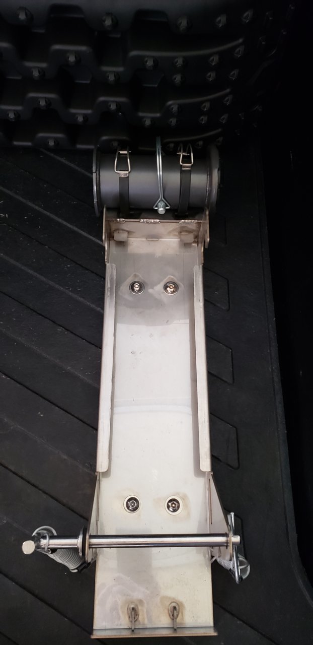

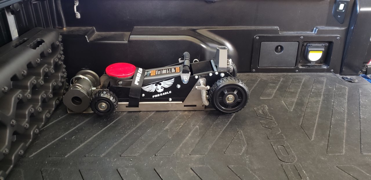

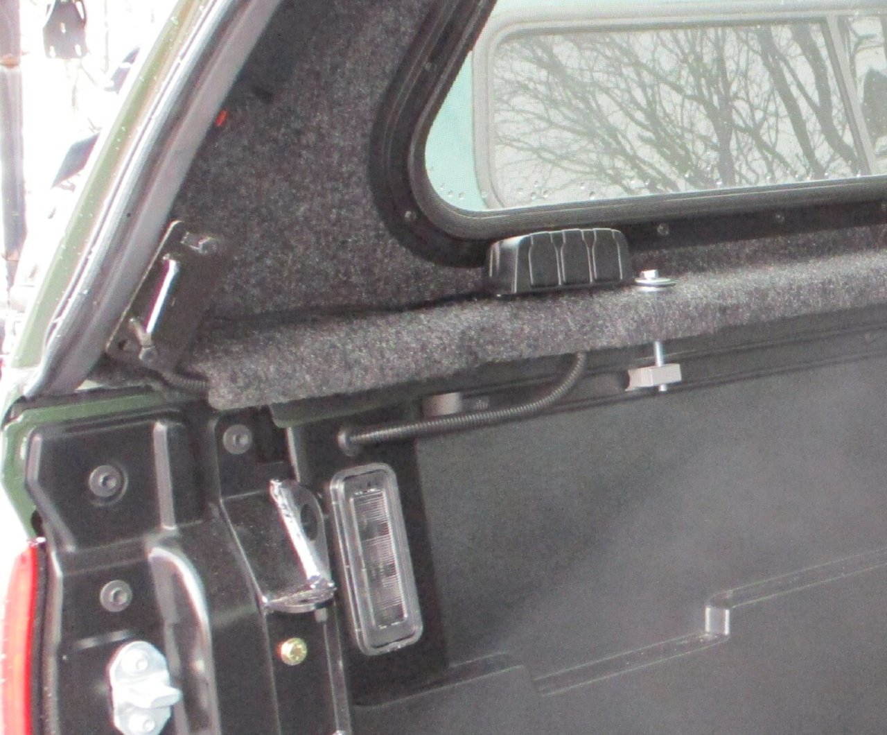

    I drilled one hole for the camper shell wiring. Protected it with a grommet. The bed material is a little tough to drill, since it is reinforced with fiberglass.

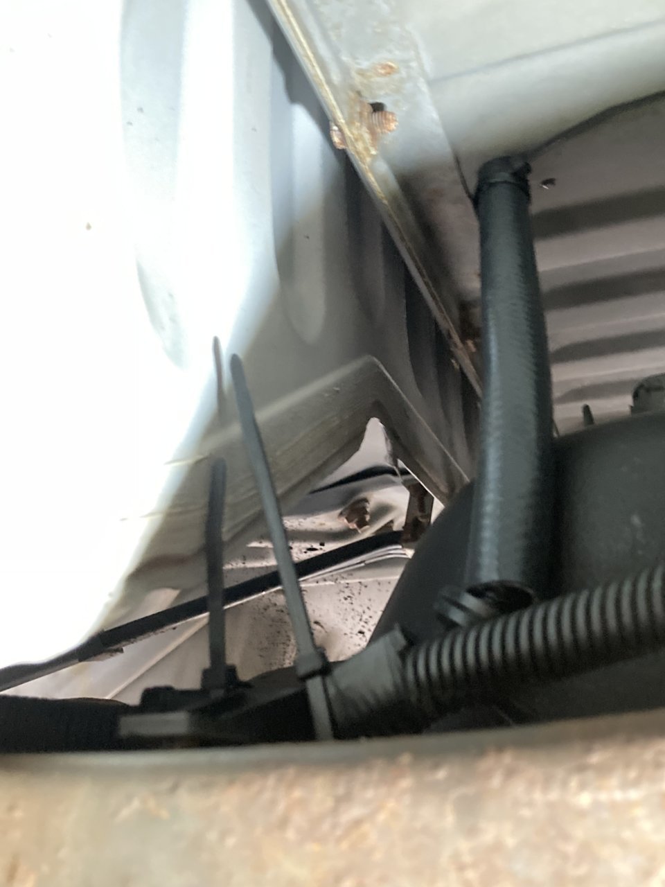

    Timely thread. I just drilled a bunch of holes in my 03.
    To anchor custom bed compartments/frame… I had a tri-fold ATV ramp from my trailer conversion to use. So two ‘wings’ will lift up on either side. Going to diamond plate with security screws both, then figure out locks. Plus working on a back fold down door/panel that is about 11-12” inside the tailgate. Oh, this all fits under a tonneau cover, with about 20-30 snap buttons drilled through the fenders/tailgate.
    Then I ran a beefy wire up from the battery (probably #6 AWG or larger) as I am going to install a 20amp DC-DC charger for my THOW. I have 100amp CB on each end (overkill, but I had them already). I wrapped in plastic wire loom and followed brake/fuel lines back. Added a section of garden hose going through the bed. I had a rubber grommet, but I gave up and just used the hose.
    I added a 100amp/30amp 6 blade panel also.
