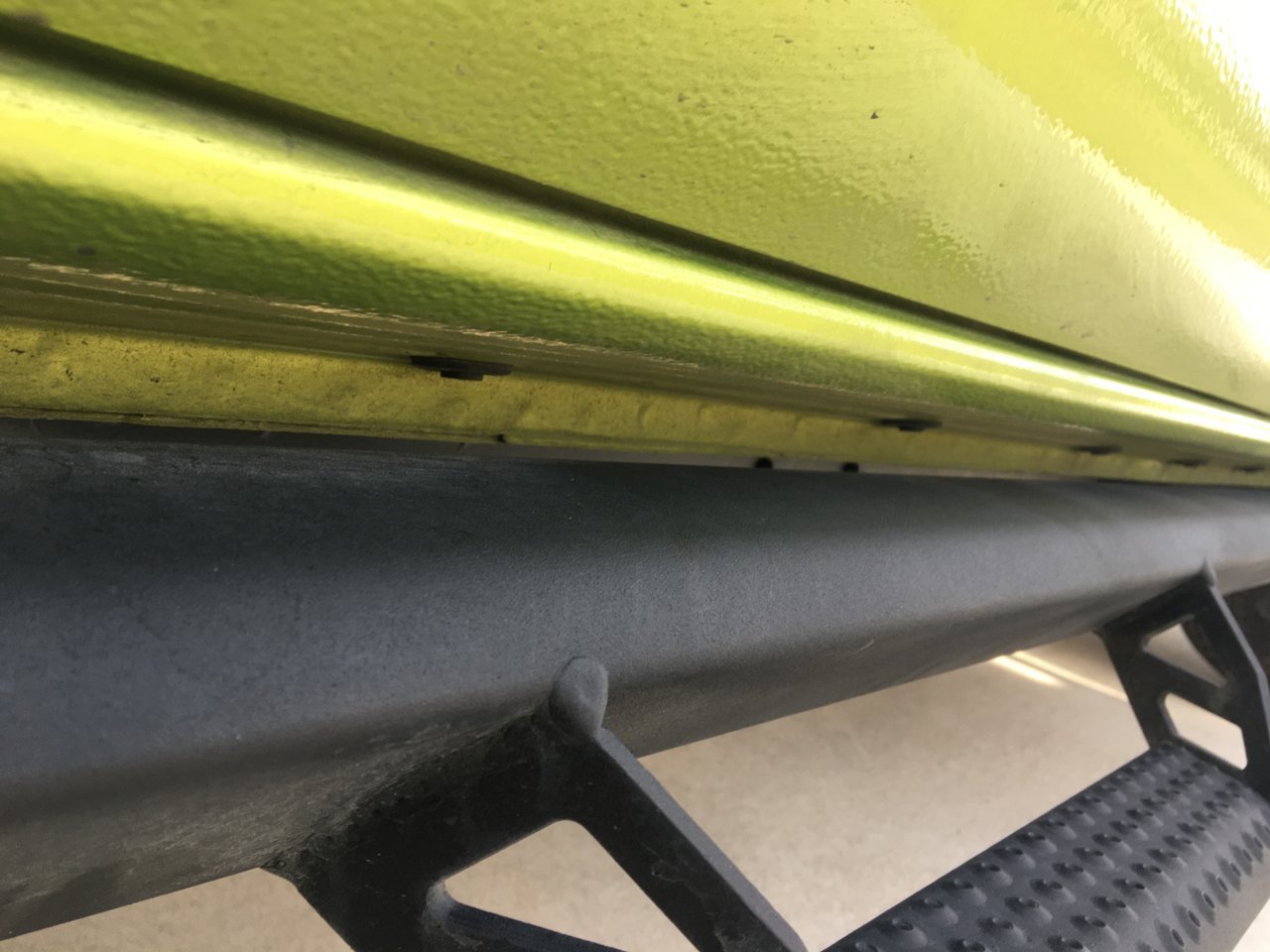

    Got my Tacoma treated for rust prevention yesterday. Was kinda shocked that they drilled holes into my brand new Tacoma. Is that common practice? Does it impact on the structural integrity of the chassis? Any technical experience here?

    What brand of corrosion protection did you get? Generally speaking, any decent corrosion protection process requires drilling access holes in the body (not the frame) structure in order to insert the wand that applies the product. The holes are then sealed and plugged. No, this does not affect the structural integrity of the body.

    Thanks for your response. Just puzzled why they did not take all the existing holes at the bottom of the door well (see pic). If Toyota wanted folks to drill around, why did they provide holes then?
    Hope I can still get it through German specs… they are sensitive when it comes to things like that.
    I had the rust prevention and undercoating done at Ziebart with their products.
    Thanks again for your take on structural integrity.

    Toyota doesn't want anybody drilling holes in their structures. Truth be told, they would probably rather have your vehicle rust out - in a reasonable amount of time - so you'll buy another one. Why don't they provide holes for this purpose? Two reasons. First, only a small percentage of buyers ever get corrosion protection applied. Second, cost. Every extra operation has a cost. Like I said though, the small holes drilled for corrosion protection application do nothing to affect the structural rigidity of the body structure.
    As for why folks applying corrosion protection don't use the holes underneath the rocker panels on a Tacoma, I don't know.

    No reason to even drill holes in the taco body to get decent coverage. Like pointed out the holes along the rocker provide good access in addition to any blasting anyone wants to do in the few large grommets under the footwell carpet up front. Most Tacoma frames will rust out before the bodywork becomes an issue let alone any bodywork that requires drilling a new hole to spray.

    Tried to follow up with Ziebart and the Ziebart rep who drilled my rocker panels - very uncooperative! Rep sys it is company manual to drill holes and that the 9 holes at the bottom of the rocker panel are drain holes-not sure if the rust proving nozzle cares what the holes are called and what the original purpose is…. The company says that they need to drill to access the rocker panel- 9 existing holes don’t do it, but 4 drilled holes do? Cannot recommend going there! Not only poor service, but also not smart.
