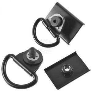

    I want to add large D rings in my truck bed to use as tie down points for my 400lb motorcycle.
    The best spot I found is in the sidewall of the composite bed about half way down the bed (just behind the wheel well).
    Is the plastic in that region thick enough be drilled through and reliably anchor the rear of a motorcycle?

    I'm going to disagree with everyone so far and say you'll be fine, just use a large washer to distribute the load.
    The factory D rings are mounted in the composite bed, this is no different. They are more than up to holding a 400lb bike down; that is a fairly light static load.

    He's drilling into his own truck, I'm pretty sure he's got this. I'm not sure how I could be considered responsible.
    Look at the factory hooks:
    People anchor motorcycles heavier than 400lbs with these all the time. As long as he uses a big washer or plate on the opposite side like the factory hooks, he will be fine.

    In my mind, securing has 2 factors: the ring itself, and how it's secured. Those rings look legit, but how are they secured? anchoring into plastic just sounds like a bad, bad idea.
    I'm obviously bored at work this morning and thus participating in this kinda silly thread... again I ask, why not just use the existing d rings? I have secured 2 bikes with the existing 4 rings, no prob.

    A friend of mine has those exact D-rings and they were I stalled by the dealerships in the side of the bed. He uses them for his MX bike regularly.
    I bought the same set but installed them using the front bed bolts instead. They're SOLID... had to step drill them just a bit but again, its a solid anchor point. There's a thread for it somewhere... Also had links for a cheaper D-rings from Amazon. *One con for the bed bolt D-ring mod, they don't rotate.

    I've done sth similar but to make it sturdier and distribute load I put an aluminum backing plate behind it.
    You can pop out the little cubbies over the wheel wells for easy access
