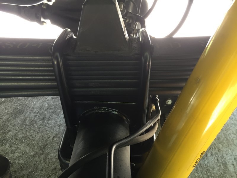

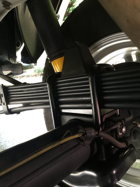

    I installed the 3* shims and my shudder/vibe at roll out is much better. I kept the CB drop in place, and installed the shim with the thin end facing forward.
    I still have to measure my driveline angles, but the transmission shift lever doesn't shake and the truck doesn't shudder on roll out anymore.
    Now if I can figure out why my U bolts nuts are flush with the threads...
