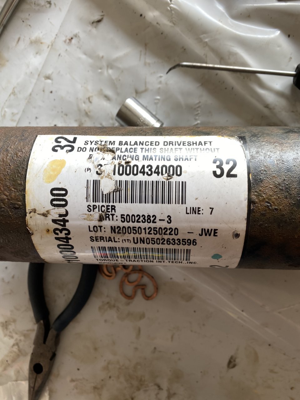

    I have a 2005 double cab 4.0L tacoma. I noticed some shaking and decided it was tome for a U joint replacement. Well I got all three U joints out and the middle one was destroyed with a warped connection as well as a crack in the shaft where the joint was. I’m now looking to replace the shaft entirely, but need help identifying the part number.
    Stock is splicer, but does anyone have any suggestions on other brands?

    Just take it to a driveshaft shop and have them repair what needs repaired. They can cut the u-joint part off and weld on a new one and rebalance it for you. New ones cost ~400 bucks for an aftermarket one. Toyota genuine I don't even want to know what that would cost.
