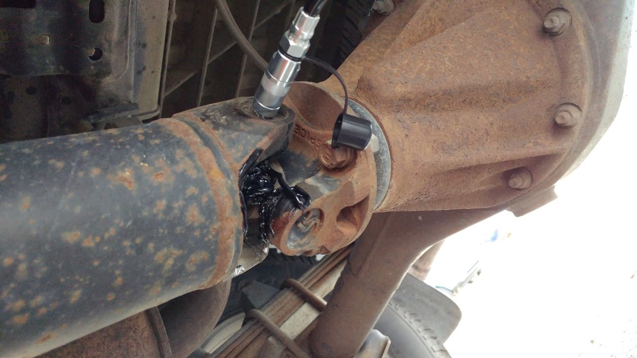

    Just finished my chassis lube on my 2013 dcsb 4x4 at 29k and most of the zerks were bone dry. Some black grease came out of the 3 zerks on the rear driveline but the front 2 were virtually dry. If you are having a hard time finding the front zerks, just get on your back and go under the drivers door and they are easier to see right above you. As others have said, you can rotate the forward drive shaft with your hand but the rear driveline you might have to back the truck up a little. It took about 10 minutes to do the rear driveline and 20 to do the front (once I found it). I had to take the heat shield off to reach the rear zerk on the front shaft but the zerk farthest forward was easy to get to. Use a 12mm socket on the heat shield if you have to take it off. I used nearly all of my 3 oz grease (Lucas green x-tra heavy duty). I got my Lubrimatic 3 oz mini grease gun from Home Depot and had to go to O'Reilly Auto Parts for the grease needle. I almost decided to shave the grease head on my grease gun so that it would fit. It was really close, but decided to go out and get the grease needle.
    I'm guessing that nobody greased my zerks during the 2 year free maintenance from Toyota. It would be easy for the lube tech to do the rear while he is doing the oil change but I doubt they touch the front since they are harder to get to.

    Yeah the front 2 are always rough. Great idea with the needle!

    Just did this myself on my 2015 which is about to roll 10K miles. After hearing how dry some folks were at 30k I figured I'd take a look before then.
    Each zerk took about 6-7 pumps of grease until I could hear it coming out. One took 8 or 9, which seemed pretty dry. I used Lucas oil #2. This is a new mini grease gun and obviously a new truck.
    Only issue I had - once done, it was almost impossible to get the grease fitting off 2 of the zerks...I had to pull like hell on the rear most zerk and the very front one. Not sure why. Thought I might pull the zerk off the back - took 5 mins of swearing and wiggling. Middle 3 zerks weren't too bad. I did take off that little heat shield to get to the front one closest to the transfer case - no way my stubby fingers were getting to that one.
    My experience with greasing prior was with a well used grease gun and on well used lawn equipment, so maybe it gets easier once the gun and the zerks are used a bit. I may do this again at 15k just to see how much grease they take.

    Yeah I had the same problem getting the fitting off. I ended up just pulling off with pliers. It's easier to do that as there is no leverage to yank of the grease hose. Just pinch the fitting and tug with pliers.

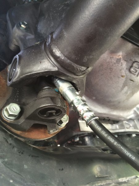

    What's the deal with the needle? Is it meant to depress that tiny check ball in the zerk fitting? I've never used a needle attachment, I only have experience with the socket type that fits over the zerk.

    One of the front drive shaft zero is tight to get at, so the needle fitting makes it easier to get into tight spots. It pushes the check ball back. image.jpgI believe it was this guy here

    cool, thanks!
