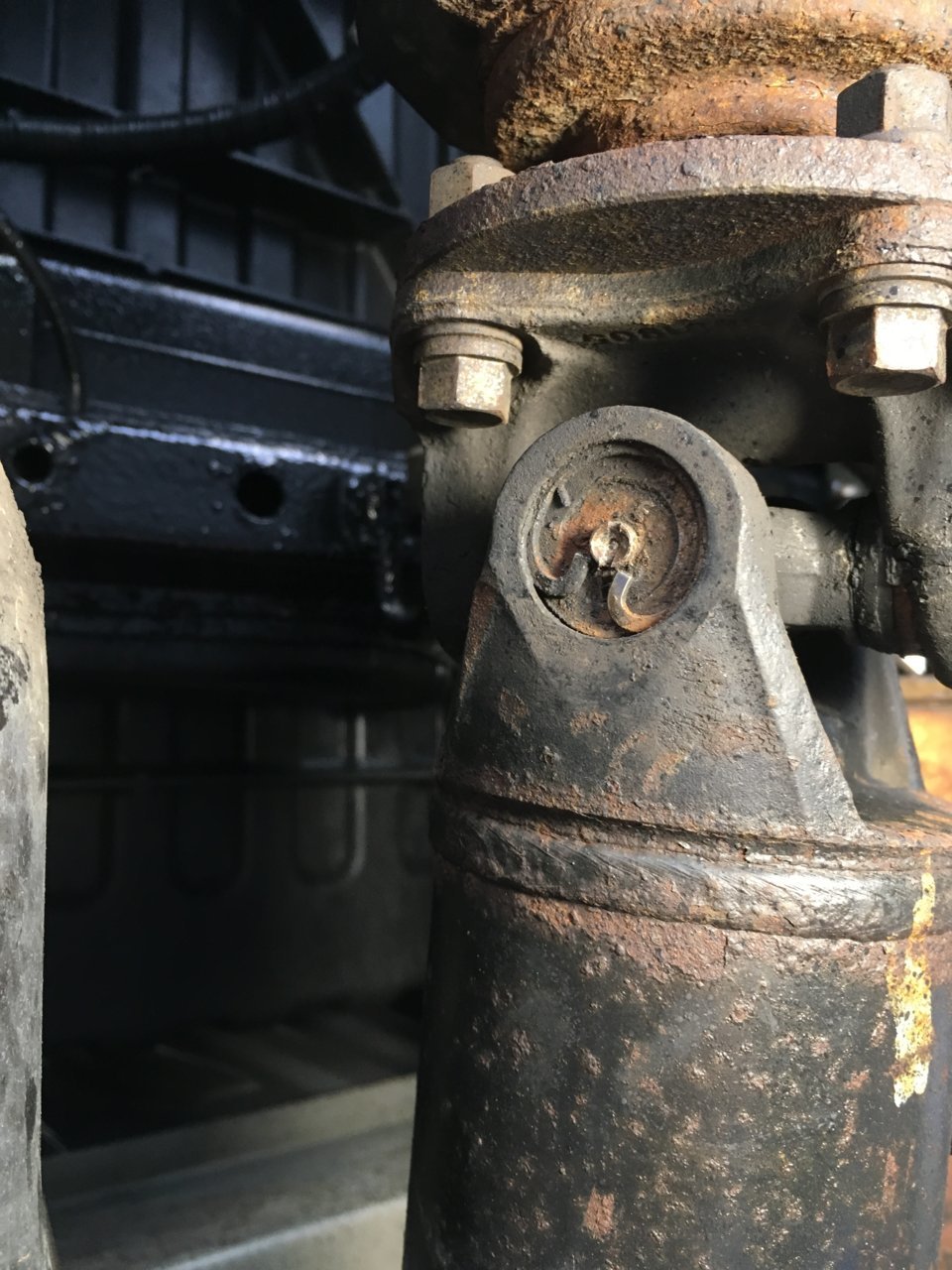

    Maybe it was replaced at some point with a joint without a zerk.

    Found this... Can someone confirm I can just unscrew it and put a new zerk fitting in there? Or is this a "sealed" u joint?
    Edit: Looks like this is a Moog replacement u joint. Must have been done by previous owner at some point. Guess I'll be getting an adapter...

    Any universal joint with a grease zerk is a flush style joint
    start research here : Spicer makes your driveshafts http://spicerparts.com/resources/lube-torque-specs
