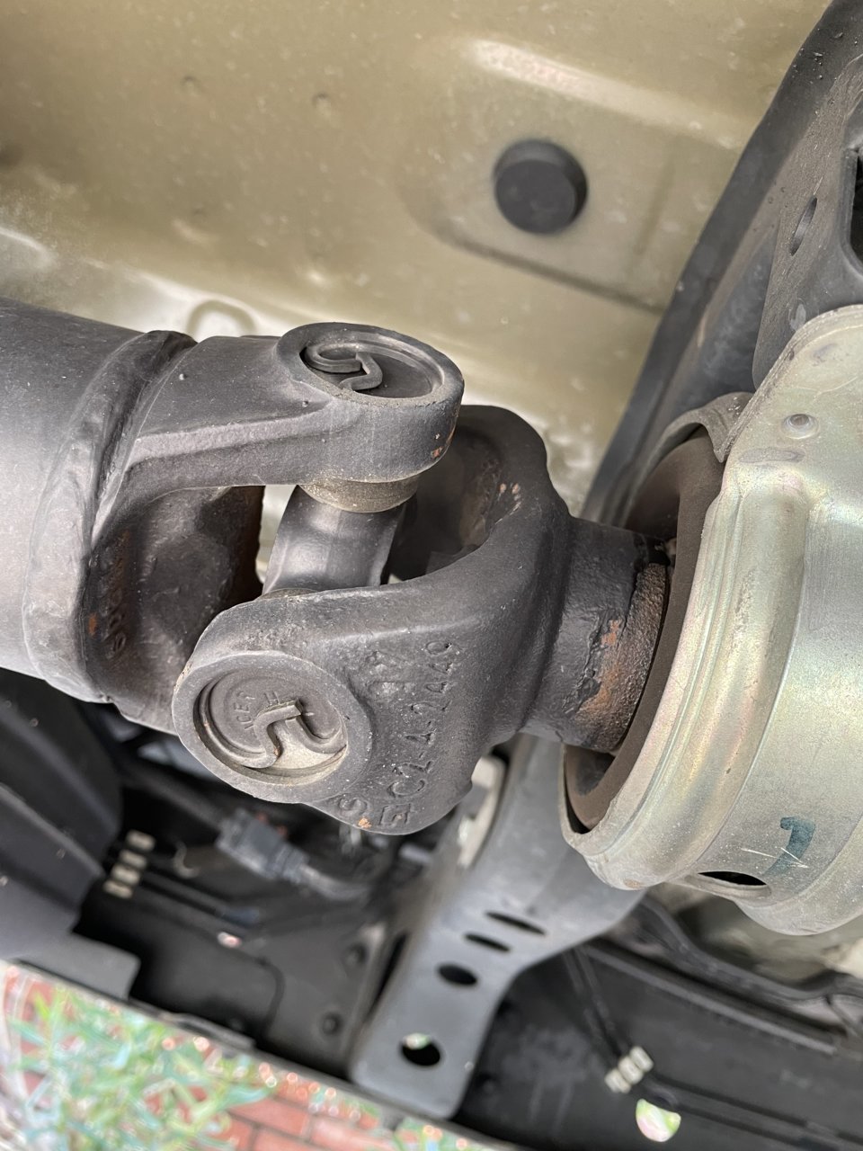

    Might be a dumb question, but is this something I need to maintain on my 2WD Pre-Runner?

    Does your vehicle have a driveshaft? If yes-does it have u-joints? If yes-do those u-joints have grease fittings? If yes to all, then yes to your question.

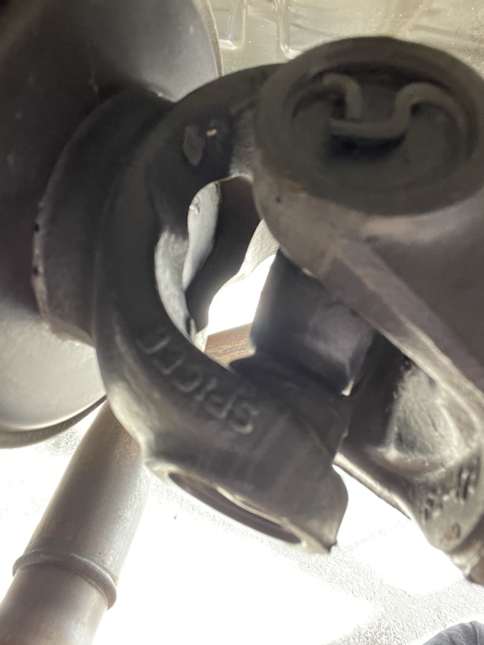

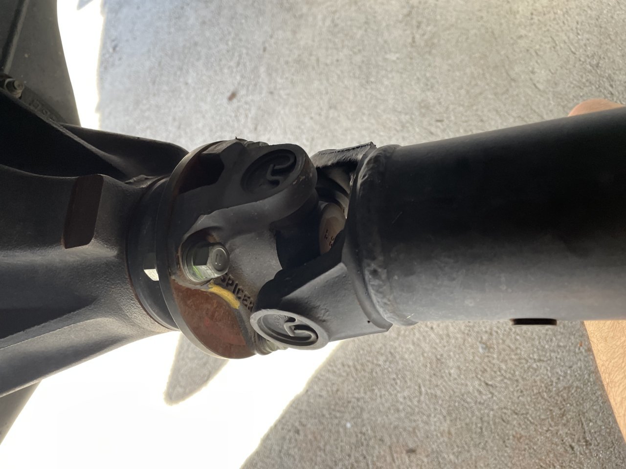

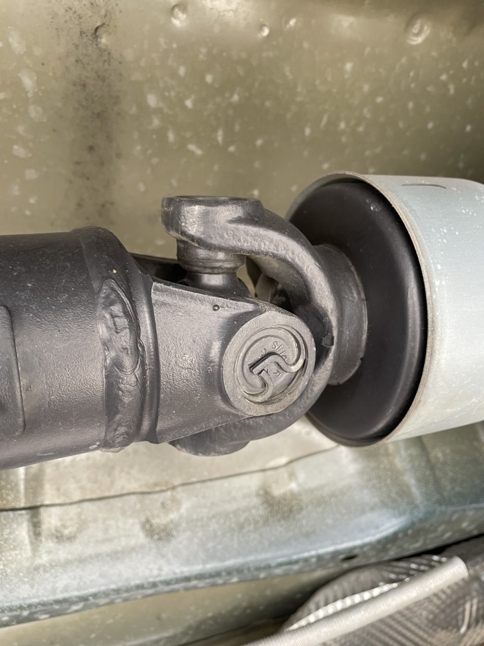

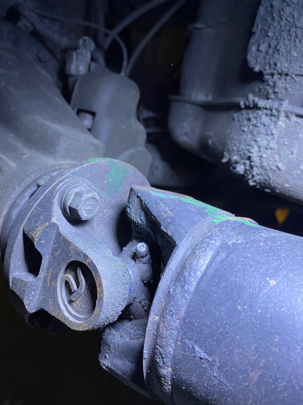

    can you help me confirm? Doesn’t look like I have any place to sync up a grease gun. Pics are front to back.

    maintenance guide says 4wd only so I think I’m good

    As a note--that is only for OEM--no issues putting a u-joint with a grease fitting in your vehicle.
    I don't see any grease fittings in your truck, but it sort of looks like your rear u joint is going to have issues soon. See second from the bottom pic. Is that paint or ground up rusty needle bearing oozing out?
    and although you likely already know--this is what you would be looking for:

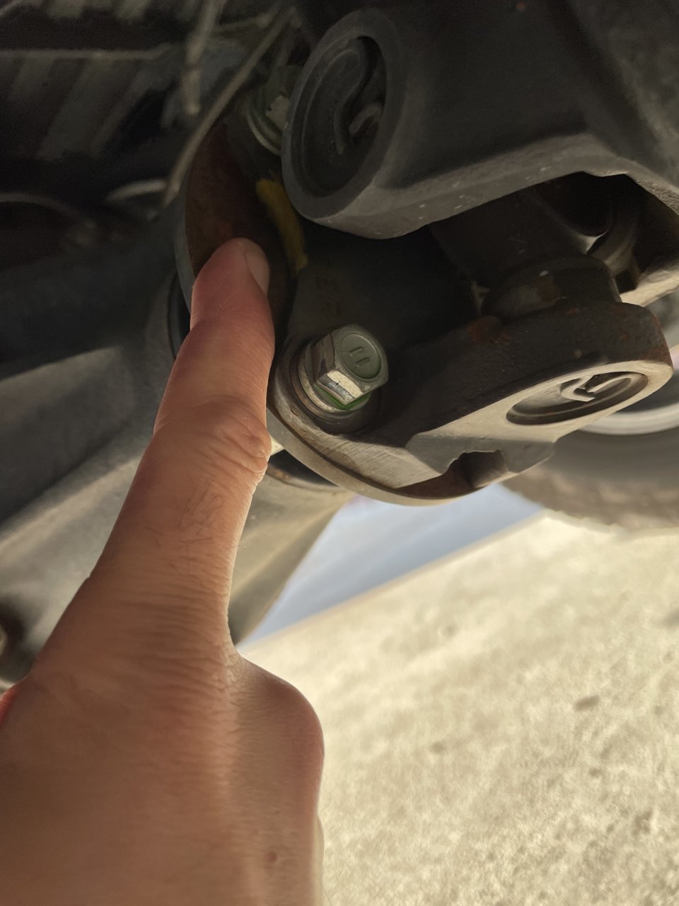

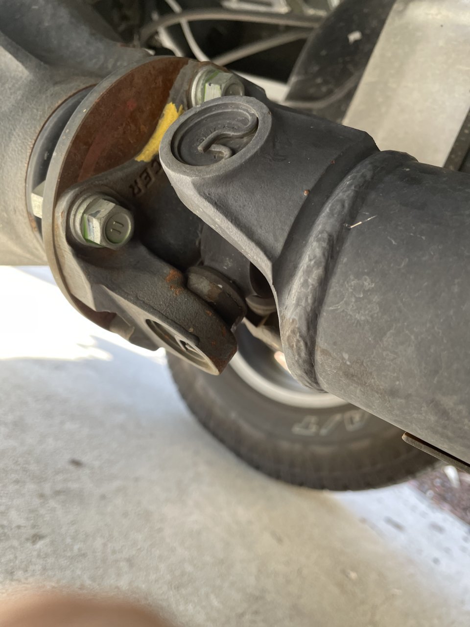

    Thanks! Are you referring to this (what I’m pointing towards)? It’s paint.

    This--what is that black stuff? If paint--cool.
