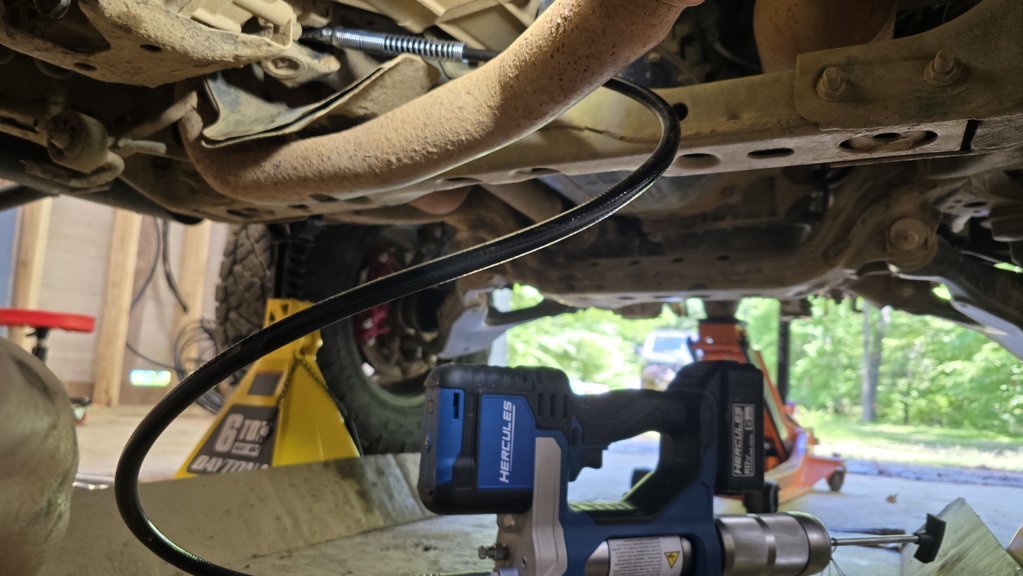

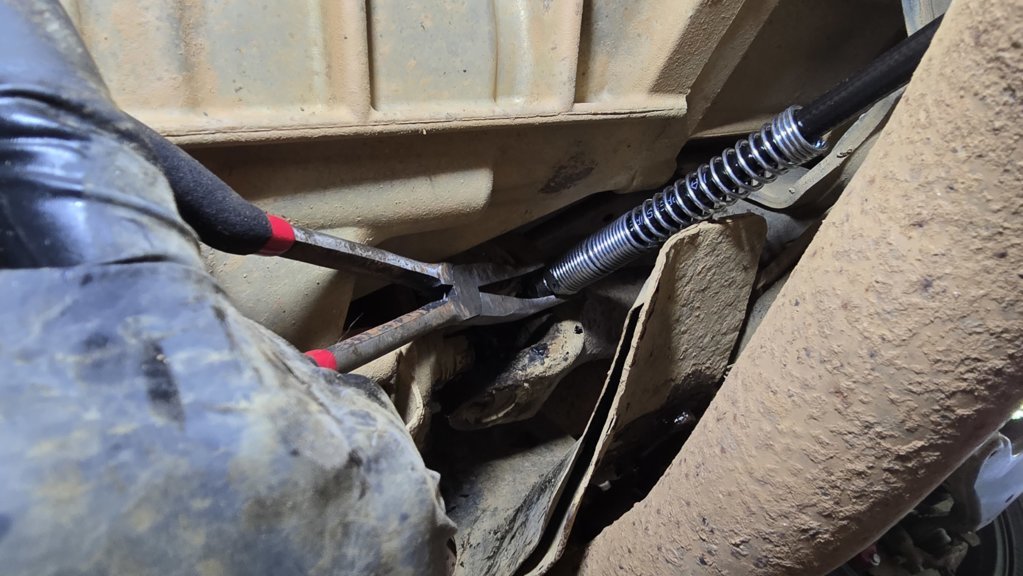

    Not sure how many will get this far in the thread, but figured I'd post a picture of how to grease the front driveshaft U joint as it exits the transfer case. I couldn't get the heat shield to budge, but managed without removing it.
    Then to get the grease tip off the zerk, a pair of long nosed, curved top pliers helped to pry it off.
    Micbt25 likes this.

    Even being able to remove the heat shield that zerk can always be tricky, nice job. The nice part about the front drive shaft is that it can spin free when not in 4x4 unlike the rear shaft without jacking up the tires.

    Its a tight squeeze under the front, so I jacked it up for a bit more room to perform my contortionist moves.
