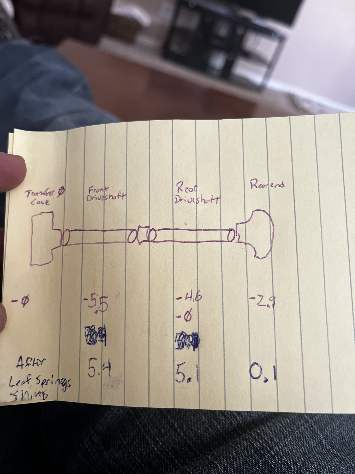

    So I had the vibration at 25 mph after I installed the Westcott Designs TRD Pro collar lift and a 1 inch block in the rear. The truck is a 2023 Tacoma TRD Pro. I did the measuring of the drive shaft, etc. and then tried a carrier bearing drop kit with no success so just decided that I was going to start from scratch with the Icon RXT Leaf Springs in the rear with a 3 degree shim and then see where I landed. I felt like the rear needed to be a bit higher anyway with the Westcott Designs lift. It came out perfect. Here are my angles before and after. IMG_4081.HEIC.jpg
