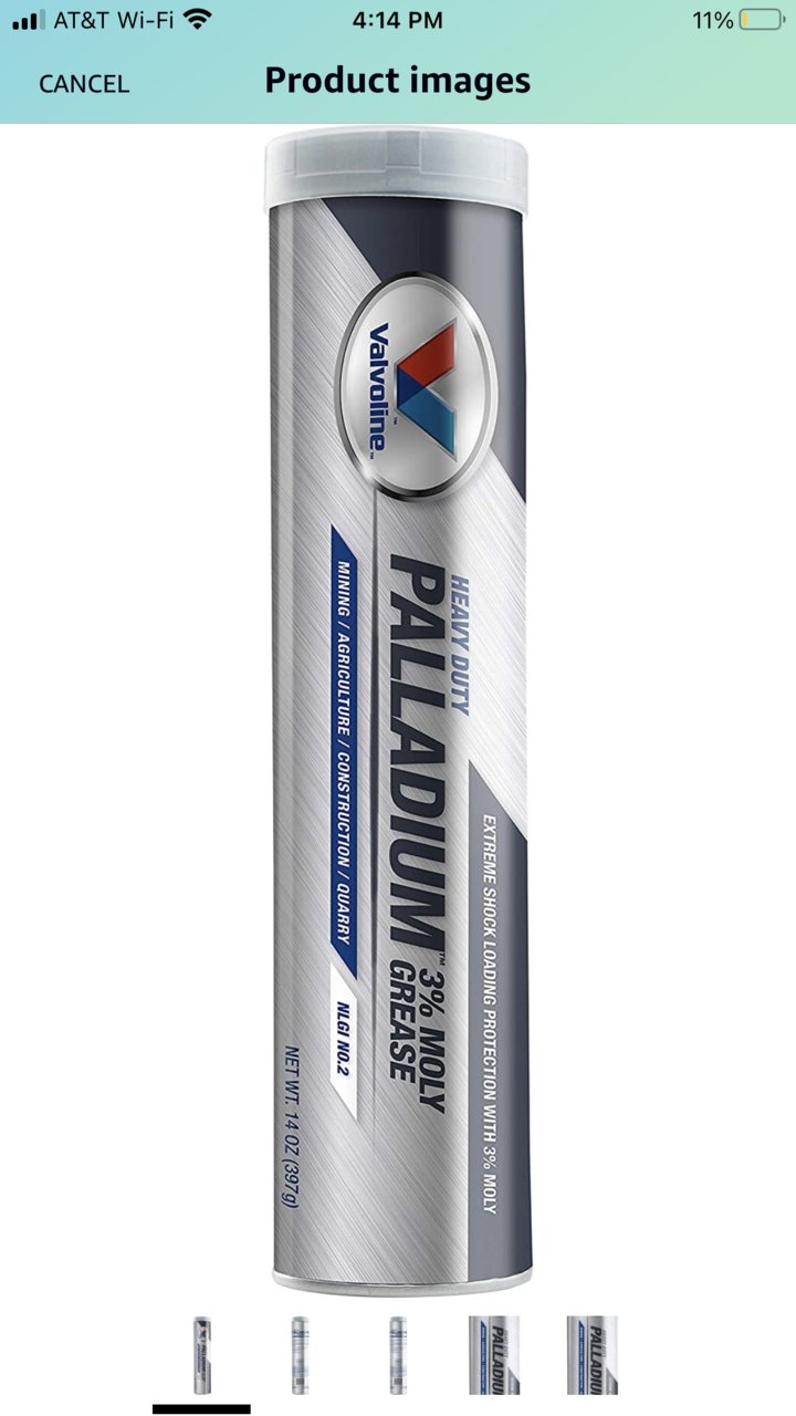

  15. Apr 25, 2022 at 3:17 PM
    ctheulen
    ctheulen Alaskan Assassin
    Mar 20, 2018
    #247822
    130
    Glenwood Springs, CO
    2005 Tacoma SR5 4x4 DCLB
    3 inch lift Toytec Ultimate Coilovers Deaver Stage 3 leaf pack Camper shell w/ Prinsu Rack and RTT Maxxis Razr MT 285/75/16
    I use this stuff on my SPC UCA ball joints. Wondering if it would be fine along my driveline too. Been using Red N’ Tacky NLG #2. Trying to save myself from swapping the gun out every oil change
    tacoman45 likes this.
  16. Apr 25, 2022 at 3:33 PM
    #16
    winkel
    winkel Well-Known Member
    Dec 24, 2015
    #173039
    2,663
    Corydon, IN
    2014 Spruce Mica, TRD Off-Road, 6 Spd Manual
    Sliders, Tailgate Liner
    I had a similar experience with Valvoline red. That crap separated constantly and left big red stains on every shirt I wore while using it. My grease gun always had a red puddle under it so I finally tossed it and switched back to Lucas. I have a tube of the Lucas Green that I'm using next.
    Somewhere along the way, I put in a tube of Fuchs that's kind of light tan in color. It is nice and stringy and really stays put. I reckon when it's empty is when I'll switch to the green. Of course, a tube of that will last me another couple of years.
