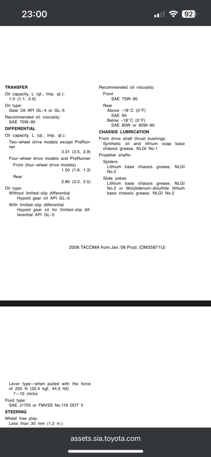

    Just replaced my Output Shaft Seal since I noticed it had a small leak of ATF and took advantage that the Slip Yoke had to come out.
    I saw several people use Ford Motorcraft PTFE Grease but my 2006 Toyota Manual states to use “Lithium base chassis grease, NLGI No.2 or Molybdenum-disulfide lithium base chassis grease, NLGI No.2” for the Slide Yoke
    based on this I used Mobil’s Synthetic Moly NLGI #2
    Has anyone else used a NGLI #2 grease for the Slip Yoke?
