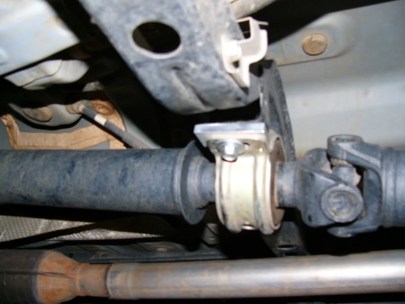

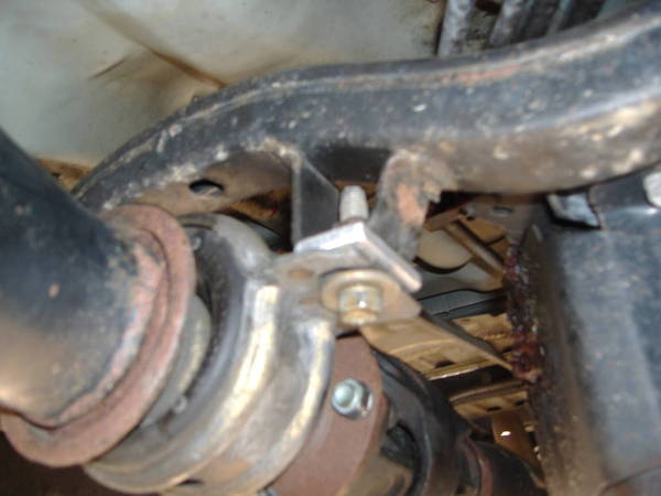

    i had some vibrations thru my driveline that were starting to annoy the hell outta me. the vibes thru my steering wheel were due to one or two of me steelies being slightly warped, but putting my stock wheels and a new set of tires on helped that. but i could feel the vibes thru the floor board a bit, especially around 40 to 45 mph, and around 55 to 65 mph. here is what i did............

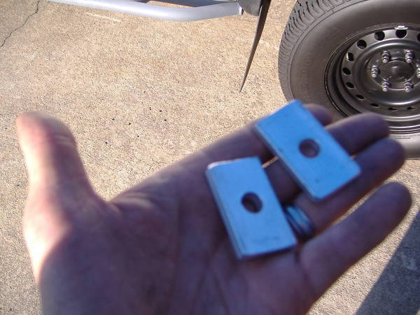

    took and cut 2 pieces of 1/4 flat bar aluminum and drilled 3/8ths holes thru the center.
    then........i unbolted the carrier bearing on the drive shaft, and put the spacers in place, and then tightened the bolts up.
    for my truck.....dropping the carrier bearing a quarter of an inch helped alot with the mild driveline vibrations. it may not work for all trucks with all the different lift setups that people have, axle shims may work a bit better............and you can stack washers if you wanted too, but the spacers i made seem a little more steady than stacked washers do. hopefully..............this will help some of ya'll out if you are experiencing some driveline vibes.

    Yep I should be making it down on friday night, late again b/c work, but i'll be there. The carrier barring drop fixed most all my vibes, I think it may have not completely fixed it because its the long bed but not sure. I'm happy with the low cost and easy 5 minute fix.

    i made mine. .35" thick and installed them tonight. wow what a difference this makes, i have absolutely no vibrations. the only concern i have is that the screw doesnt pop out of the top bolt very much so where do i get the same grade bolt but longer so i can put a washer and extra nut on top to insure it stays there so it doesnt just fall of while im driving.
