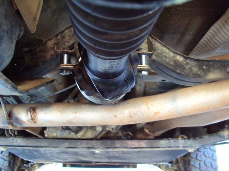

    I just installed my 2.5 inch hell bent steel spacer on my 05 DBL CAB TACO, and now I have BAD vibrations in the steering. I had an alignment done and everything aligned to factory specs just fine, so I am very interested in trying the spacer fix talked about in this thread. How thick should the spacer be again? Is there any harm in trying some washers of the same thickness and taking it for a test drive to see if the vibration disappears?

    Throw the truck in 4x4. If your vibe goes away you have the front diff vibe. Get under your truck and wiggle your front axles. Bet you $10 your drivers side one is loose and your passenger one is tight solid.

    New Front differential or Diff Bearing.
    But seeing as it takes even longer to replace the bearing, they generally just give you a whole new front diff.
    I'm booking mine in for an appointment pretty quick here while it's under warranty.

    I get the vibe at 10-15mph on takeoff...is this the same symptom? I tried the spacer s but it did nothing so I took it back out. I'm not lifted beyond the 4-leaf TSB which adds maybe 3/4" in the rear.
    Put it in 4x4 like you suggested and it goes away! I have about 25K on the truck now, would like to get this looked into if I know the right things to tell the service manager to get them to actually look at it...and fix it... and not just put me off with "it's normal".
    Oh yeah...I'm not really sure the looser axle shaft symptom is all that a-typical because of the way 4x4 works on this truck. The splined sleeve de-couples one wheel so it makes sense it should feel looser, or different at least, compared to the other one.

    If the shims or spacers dont work you may have a bad tork converter. Toyota should have a fix early 2012. check with your dealership and make sure. My dealer said around April... i have the heavy shudder from 30-40, 40-50 and some times at 60-70. I replaced complete axel with new carrier baring and u-joints. the problem is still there. I LOVE MY TACOMA!!! i'm holding out till April.

    That might be even better, since they are steel. I would never use aluminum in any critical part in the drive-line or suspension. Its very soft, and could deform over time. I've seen aluminum aftermarket suspension parts catastrophically fail while wheeling. Its nice to cut and drill, though, because of its softness. I guess there are different grades of aluminum, not sure.
    I'd do it for a temporary trail fix, but not a permanent one.

    Yep.......still look like they did the day I installed them. No ill effects at all.

    replace your ujoints mine was vibrating after my lift then i replaced the ujoints in my driveshaft and no vibration what so ever

    Another option is grade 8 washers, some longer metric bolts, and a couple 1" zinc plated steel spacers. Total about $7 from Lowes. They do carry spacers from 1/4" to 2" in quarter inch increments, so just about everyone should be able to get their shim correct.

    Hey, thanx for the followup. Nice to see it is still working for you.
    Are you using the stock bolts ? Seems to me they would be too short.
    Have you checked the tightness of the 2 bolts recently?
    Better safe than sorry.
