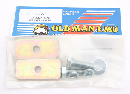

    I just ordered the old man emu FK29 kit to fix this. It was 12.35 from Low Range Offroad. Free shipping. Comes with longer bolts, regular washers, and lock washers. Oh, and the spacer.
    Figured this info would be grounds for a thread revival.

    I used washers to fix mine today. The vibrating is way less than it was, but now there is a new sound. Seems to be on small bumps and comes from the area of the carrier bearing. I checked the bolts and they were tight. Removed 1 washer from each side(it took 3 to make 1/4 inch) and the new sound seems to be gone, but the vibration isn't as dampened as it was.

    I ordered these are these pretty much the same? I am having the same problem and trying to figure it out thanks.

    I am getting vibrations between 43-46mph or so. Just ordered the OME kit from low range off road.
