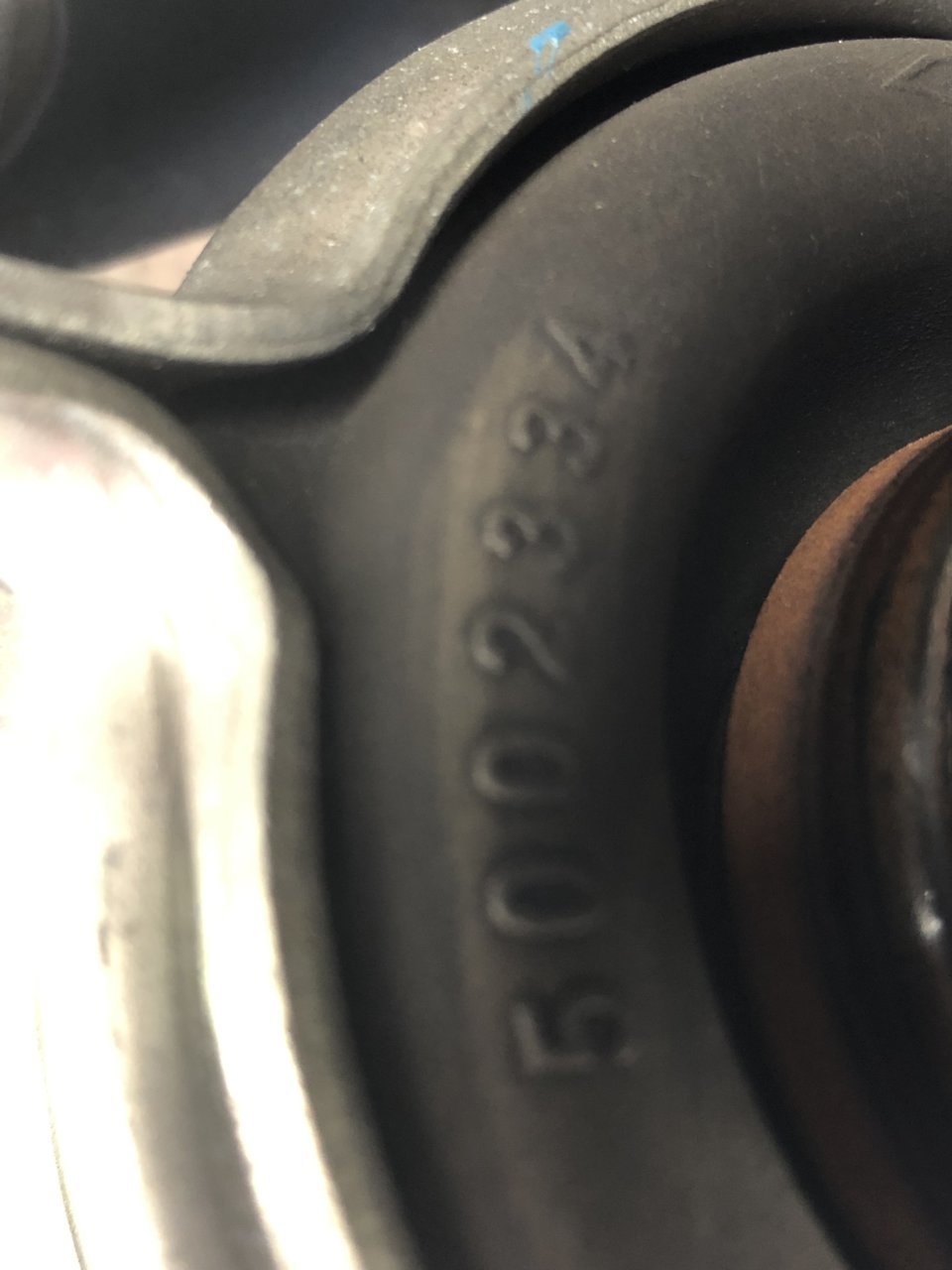

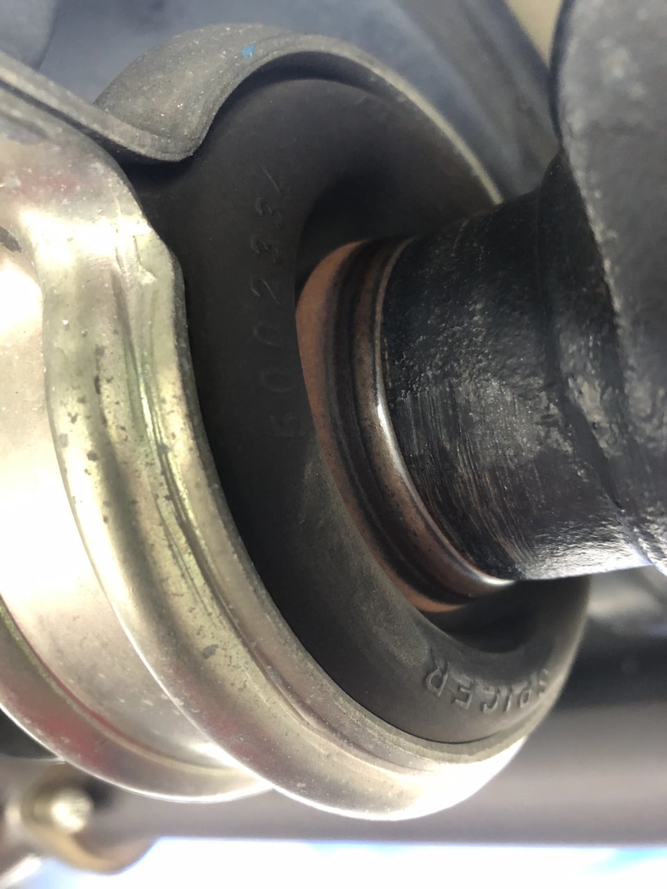

    old thread revival revival.
    I've been experiencing a vibration/pulsation type from 25 to 30 MPH under acceleration for the last 6 months aprox, Truck has 100.000 miles now, Never offroaded, never abused. I purchased the OLD MAN EMU carrier drop kit and its the same.
    Here are a couple of pictures of the center bearing, how do you know if the bearing it's broken??
