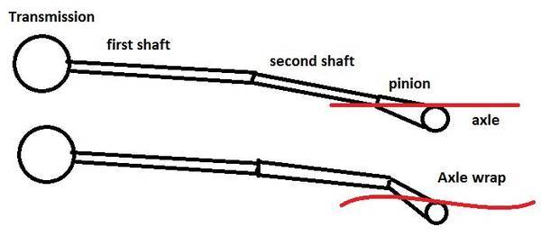

    Hmmm, I would keep in mind that when you accelerate your pinion is going to cant itself downward thus decreasing its upward tilt. 0-10 mph is 1st gear range which is heavy on torque, do you have the vibes when decelerating through that speed range in neutral? It is possible you may need to decrease/increase your pinion angle to account for what is colloquially known as axle wrap.

    I'm pretty sure its the other way around. When you are on the brakes the pinion will want to rotate down. When you are accelerating, the pinion will want to rotate up. Think about the direction of torque to the wheels...the axle will be reacting that torque and want to rotate the opposite direction. Same concept as a wheelie.

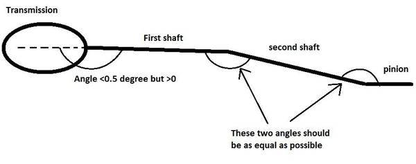

    The video that OZ posted is basically saying that the angle between the first and second should be the same as between the second and pinion, in order to cancel out U-joint accel and decel, while keeping the angle between the output and first shaft less than 1/2 degree because there is not mating U-joint to cancel it out. If the U-joint is working at 0 degrees, there will be no accel and decel. It will operate as a straight shaft. This might explain why I'm having vibes, because I put a carrier bearing drop which increased the angle between the output and first shaft. I'm going to take it out and see what happens.

    I also noticed that the pinion angle he measured in this video was positive 2.8 degrees, where the second shaft angle was a negative 1.8. His math was 2.8-1.8=1 The correct math is 2.8-(-1.8)=4.6. Just wanted to point that out. Its clearly more than a 1 degree difference between the pinion and second shaft.

    You're correct, that is my bad. Good catch :)
