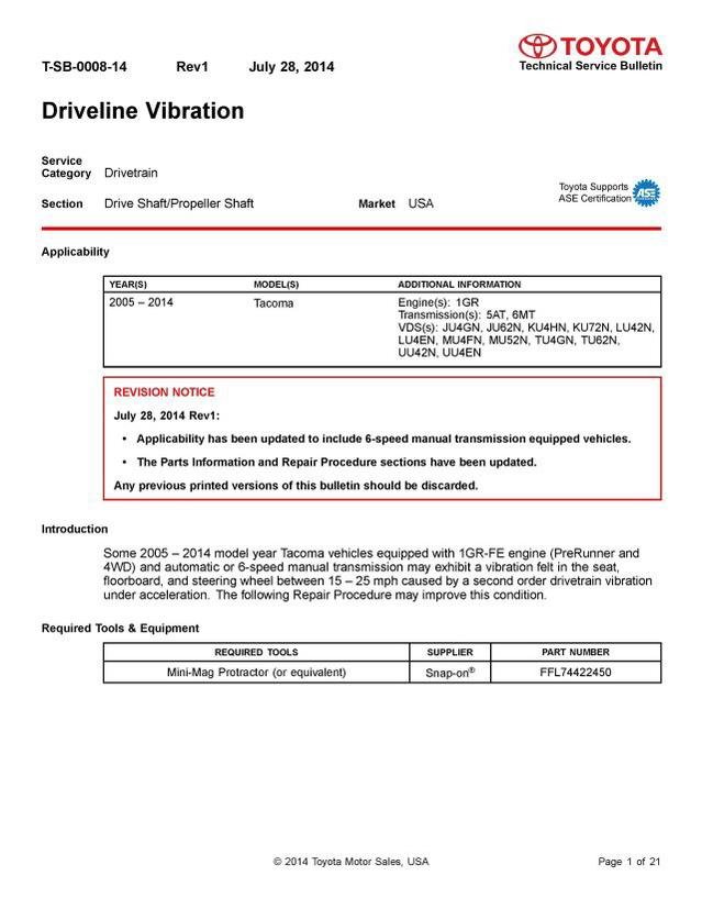

    T-SB was modded last month to include the 6 Speed.

    do you have the new TSB PDF?

    not a PDF but i hope this helps. i definitely have the vibe, and a 6speed. i just need to get to my dealer and see what they say.

    just wanted to see if they changed the part numbers etc

    i cant find the full PDF yet, but the thread where i learned that the manuals were now included is here. maybe 'Rambone71" can get the full PDF, as he provided the photo i posted above. i'd like the full version also so i can take it with me to the dealer.

    can OP or a mod change the title to this thread to say 'Driveline vibration TSB out, now covers auto and manual' ?? because this Rev1 is huge and significant to a ton of taco owners

    i was denied the TSB work a couple days ago. 20k miles on my 2013 6spd Sport. they told me the vibes weren't severe enough, the TSB won't fix them anyway, and wait until it gets worse. lol. i'm just going to throw some suspension on it and fix the driveline angles my self. my warranty is a joke. i doubt my truck will ever be at the dealership again.

    2+Overload.... I went in an tried at the dealer. No go. But it seems that the driveline vibration TSB, which I definitely have around 10-20mph when I punch it is another way of getting the 4-leaf pack.
    This all stems from the same thing for me, sloppy rear end and vibes up front. Seems like the leaf pack is just shit and I can get rid of vibes too.

    Don't recall if I posted after the TSB, but had it done about a week and a half ago. Zero issues, drives great. No more thumping. Get it done.
