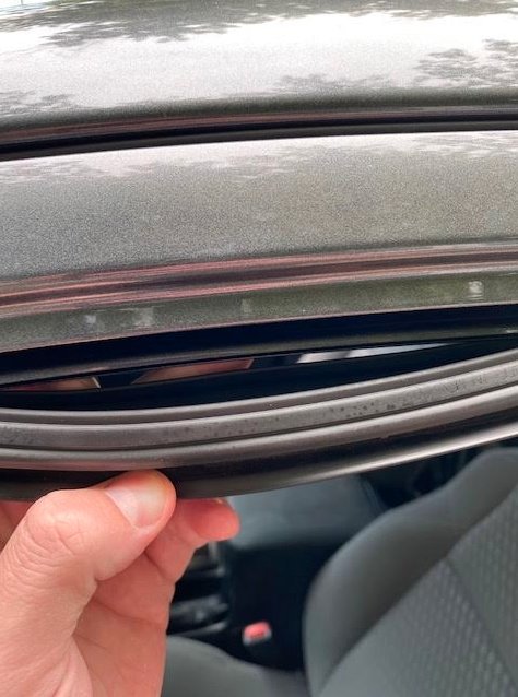

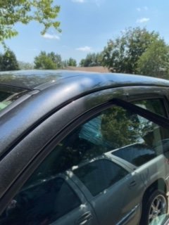

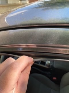

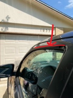

    Ugh. Thus started my own process of taping the entire door/window/jams to determine where the leak was coming from. Viola, the wind leak is gone. Took test drives up and down the highway, removing piece by piece until I determined the leak location. I discovered the leak is coming from around the top edge of the window seal, not where the glass actually touches, but where the rubber meets the door:
    This piece of electrical tape solved the issue completely:
    Now here lies my issue:
    I have two options, take it back to the dealership and have them replace the rubber window seal to see if a new one might fix the issue.
    Or I could simply use some silicone sealant in the crevice and close the window and let it dry. I am leaning towards the sealant just because it is quick and easy and should last a long time. Anyone see any issues with this?

    WAIT!
    Before you fill that with silicone.. try inserting a piece of soft plastic water line.. 1/4 in.. get the flexible stuff .. I used that to fix the hood whistle on my 2012 - it pushed the seal out enough to solve the issue

    Yeah I saw I was working on replying lol. However where would I place the tubing? This peice is not hollow like your trim was. its like a "W" shape:

    Try it in the groove your thumb is in first... this can be a temporary solution until Toyota fixes it with a new seal or whatever they need to do.
