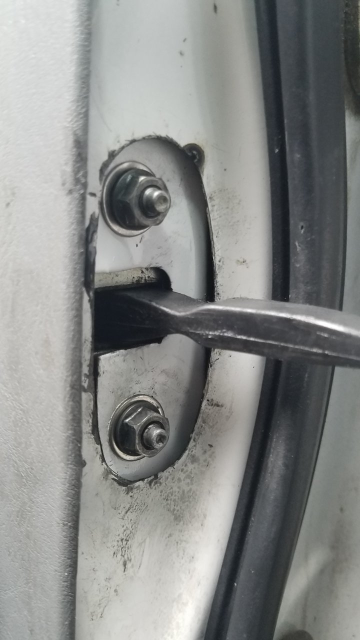

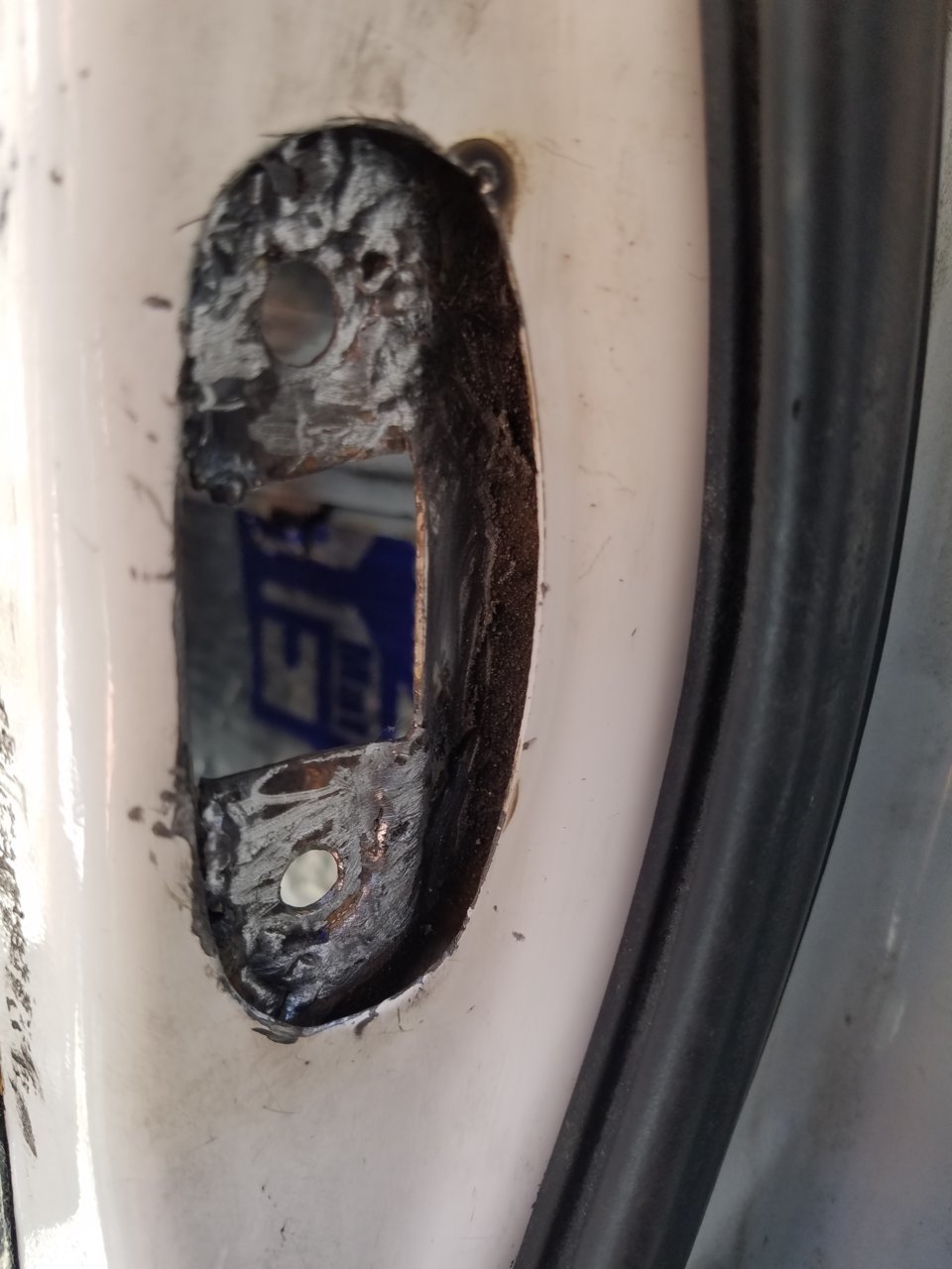

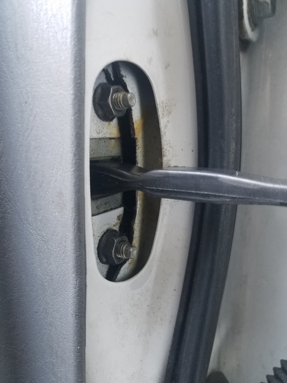

    20210331_151357.jpg 20210401_144306.jpg Mine just openning door wide last 11years
    Hope yours not like this .Pain in the ass to repair
    Added plate with jb weld then bolted

    I basically have the same exact breakage issue. How (from where) did you shimmy the new plate in?

    With door check removed it slips in from outside bolts up to the door check. As you can see theres less thread exposed because of the plate I made
