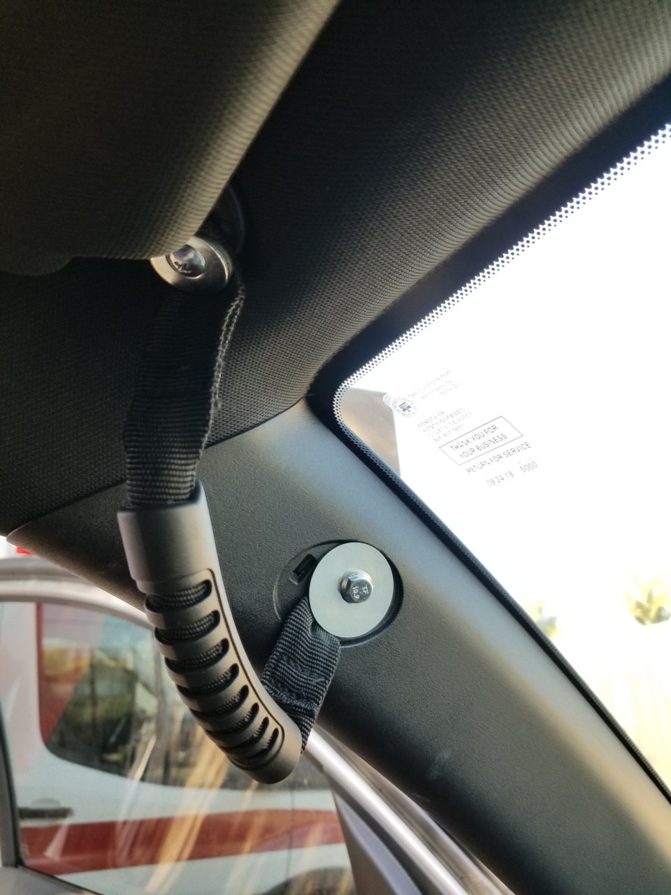

    Here is what I came up with for mine. Going to paint the components so they blend better but it works well and was easy to do.20180602_092038.jpg

    Interesting! You think the visor bolt will hold the pressure of you going in and out of the truck?

    Yep I checked it the bolt goes into the metal in the roof not just plastic.

    Even better than mine. I dig it.

    Yeah I did go to home improvement and get slightly longer bolts for both the A-post and visor to make up for the extra space. Still trying to come up with something for the A-post so that is has a cleaner look.

    Yeah that’s what I’m trying to do as well. I wonder if someone has done this already, I believe having the mod done from the A post would look a lot cleaner.

    The A pillar molding would have to detach if the curtain air bag deployed. With the grab handle mounted through the molding and into the A pillar, this won’t be possible.

    How did 2nd Gens work with an airbag and grab handle there and how does the passenger side airbag and grab handle work, or do you just mean some custom job?
