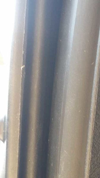

    I've had and incredibly annoying wind whistle above 55 MPH since day one. I've finally tracked the source down. The gap between the mirror trim and the window seems to be letting air in. Slapping some tape over the seal completely eliminates the noise - clearly a temporary fix. Potato pics:
    I'm taking it to the dealer Sunday so they can figure out a permanent fix but I want this documented in case anyone else has this issue. Will update on what they come up with.

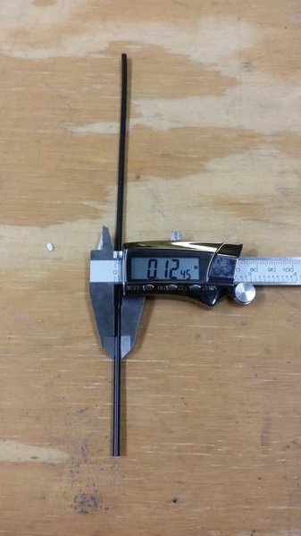

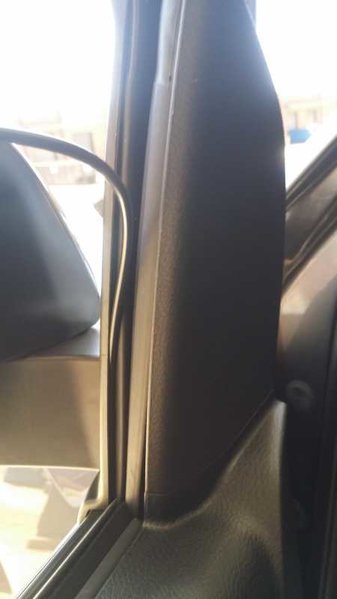

    So I took it in this morning and the service advisor tells me that Toyota is a aware of the problem, is working on a fix, and has instructed them not to attempt to fix the issue until the official fix is released. I asked if there was some kind of bulletin stating this and was told there was not but "they just know". Bullshit sensors overloaded.
    On the bright side, I came up with a better fix than some tape.
    I used some 1/8" rubber tube.
    And I ran it between the exterior mirror trim and the exterior rubber gasket.
    This made the exterior seal press into the window and the noise is completely gone.
    This has prevented the exterior seal lip from going over a small internal flange so I'm not sure if it may slowly let water into the door but at least I can focus on finding the rest of the rattles from the dash and the rear doors. Hope this helps someone.
