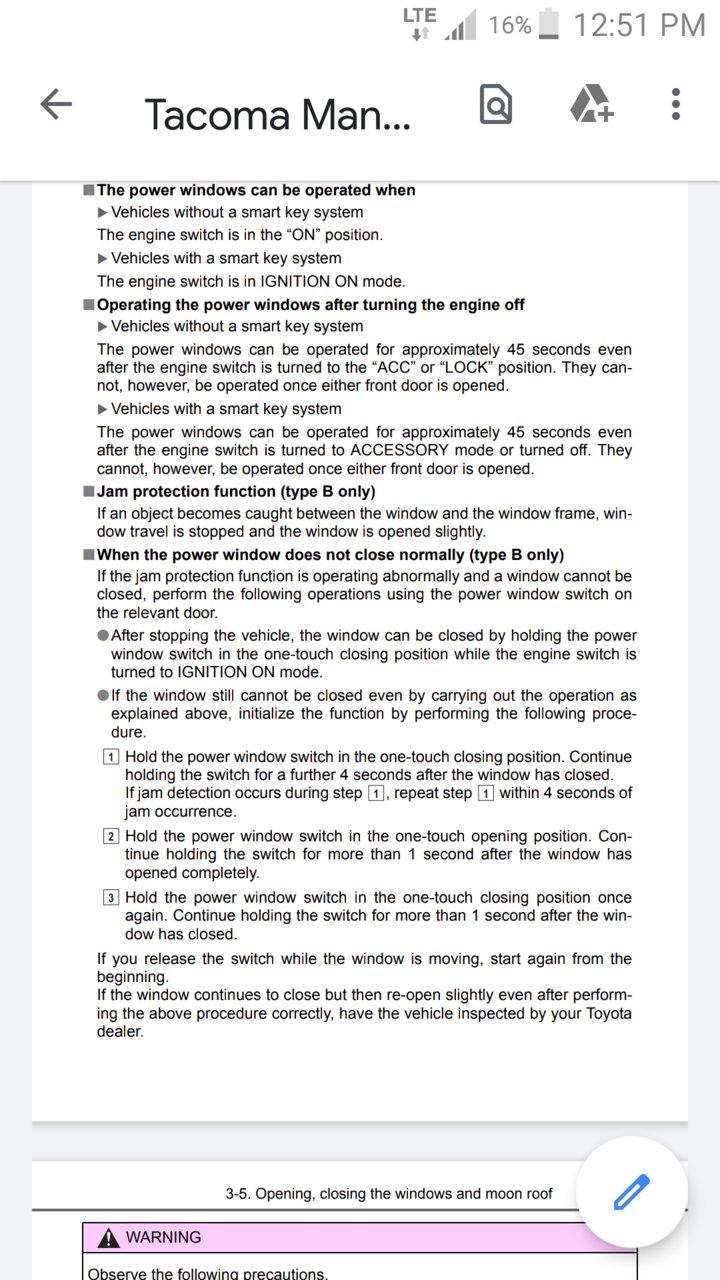

    If you're unable to get the passenger windows to roll up/down by using the driver's button panel, but the passenger windows function correctly using their own buttons, then it's likely that you need to do a master-reset of the window functions. Yeah, it sounds screwy, but it happened to me.
    Look at the instructions on this thread; I had to do this procedure on all 4 windows, from each window/button location.
    https://www.tacomaworld.com/threads...king-after-dead-battery.634463/#post-21809995
    Little Lion and Toki[OP] like this.

    I'm going to try this. Thank you.
    This makes sense I think I can find a buddy to test this on.
