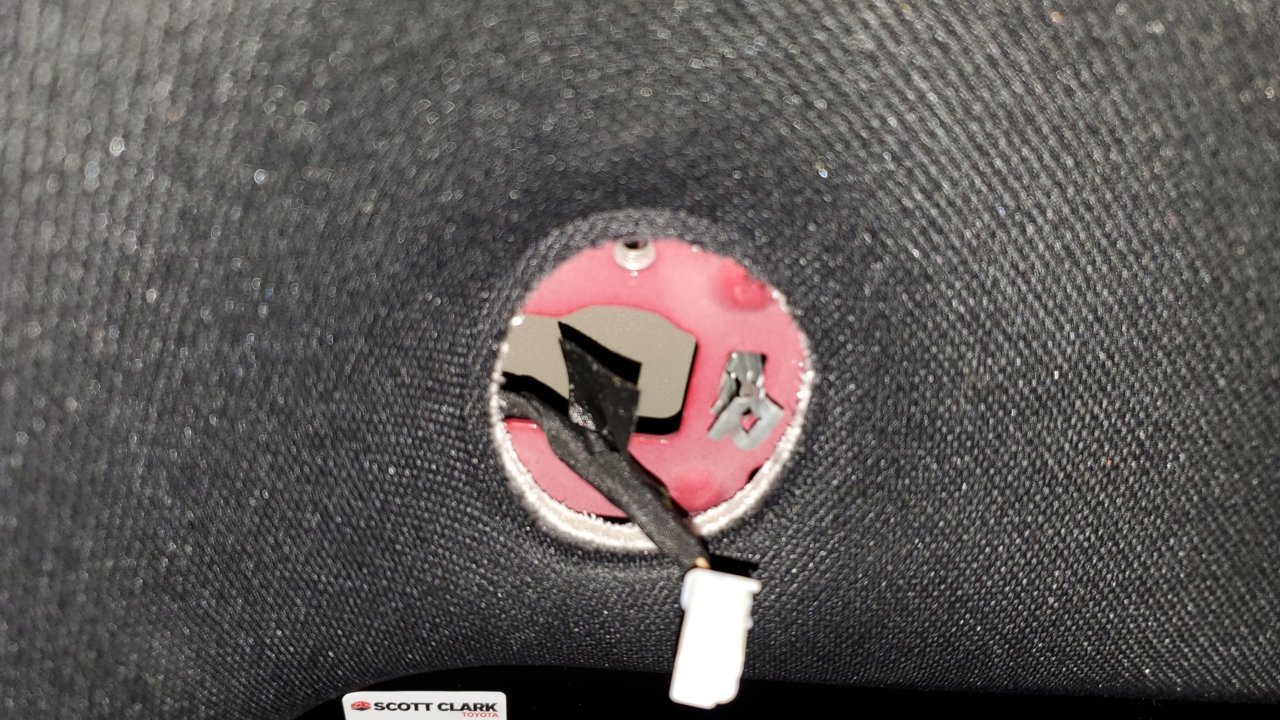

    I was driving the taco today and had the sun visor pulled out towards the driver window. I made a quick left turn onto the interstate and the visor swung into my face.
    Does anyone know how to stiffen it? I tightened the two screws holding it to the roof but it did not seem to work.

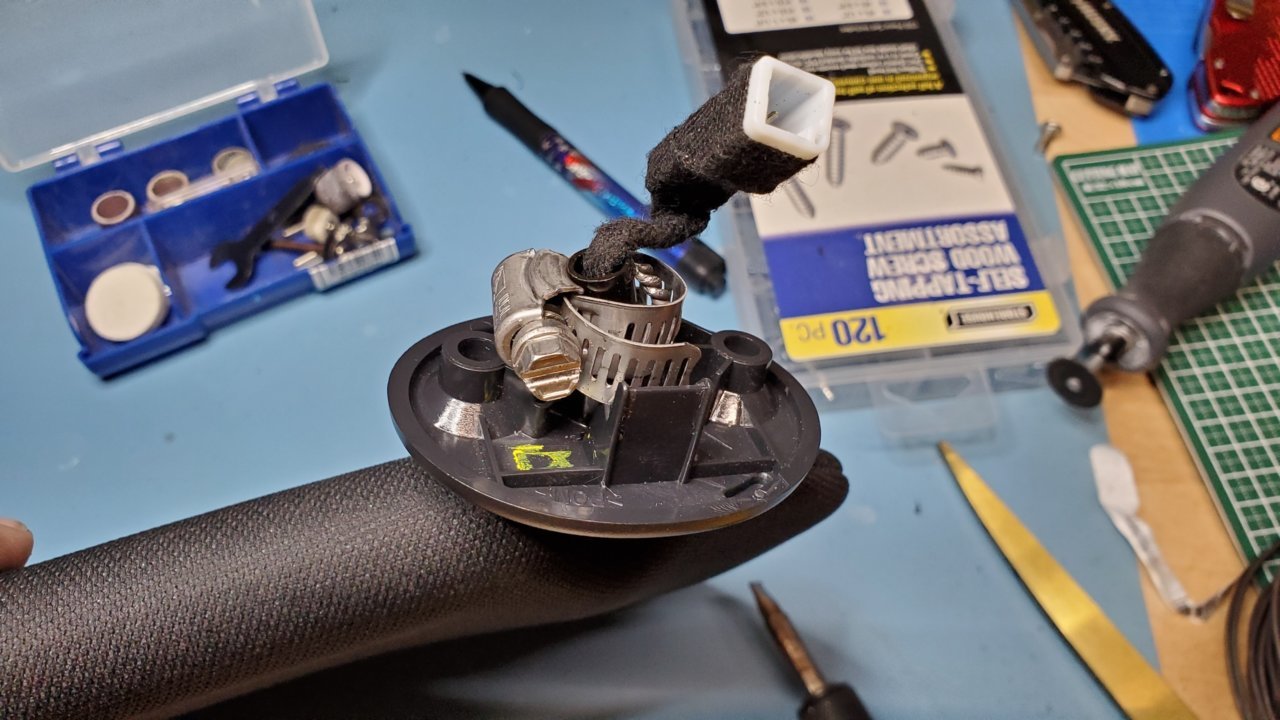

    Hmm. It is cracked. I'm going to try a hose clamp. Anyone know where I can find the plastic piece?

    Can you fit a zip tie around it, and pull it real tight?

    I tried but the surface is too slick and it slips off. Also tried a tiny hose clamp but it has the same problem. I'm going to sand it some.

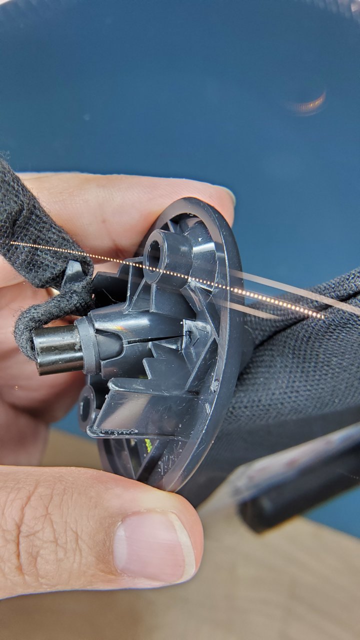

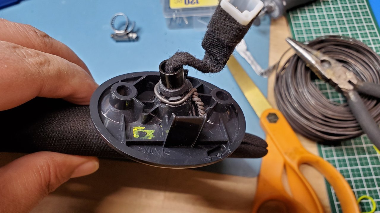

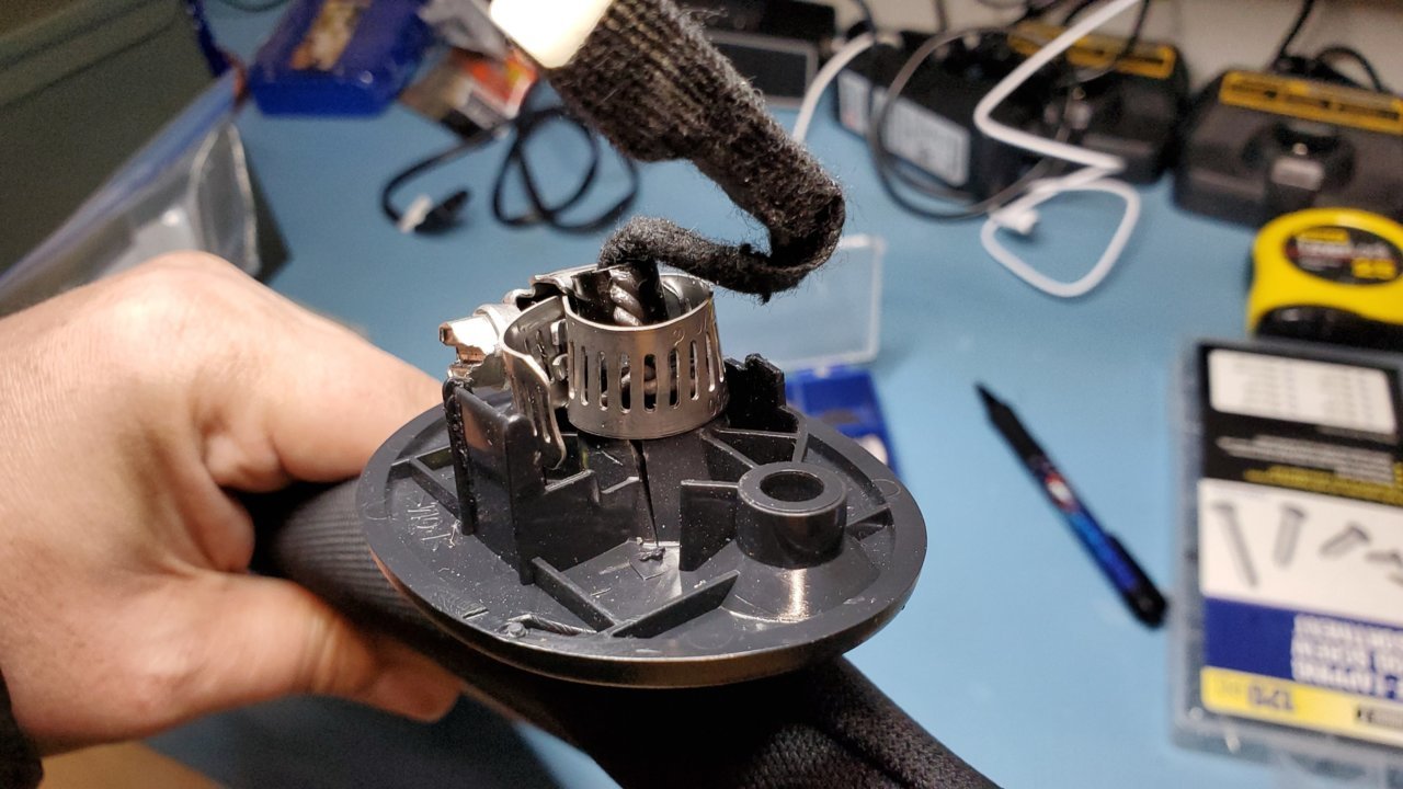

    OK. So I tried a few things and the only solution that semi worked was using some stiff wire. After I reinstalled it it feels stiff enough to not move when driving but only time will tell. If anyone knows where to find the plastic piece please let me know. I am unable to locate it on https://parts.toyota.com/. I would hate to have to replace the whole sun visor. I love my decal. :)
    I initially tried to use mini zip ties but the surface was too slick.
    So I used a small Dremel to make a few grooves in the plastic but the zip tie was not tight enough.
    I then tried to use the smallest hose clamp I found at Home Depot but it would still slide off the plastic.
    I then used a stiff wire and twisted it really tight but it was not tight enough.
    I tried to use the smallest hose clamp over the wire but it did not work because the diameter was too big for it.
    Then I tried to use a larger hose clamp, and that got it really tight, but then would not fit in the hole on the roof.
    Finally I decided to give the wire a few more twists and call it a night.
