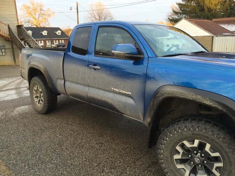

    Some asshole. Busted every car on the street that had locked doors
    This pic was the same day. Wasn't exactly clean when they were rubbing all over it

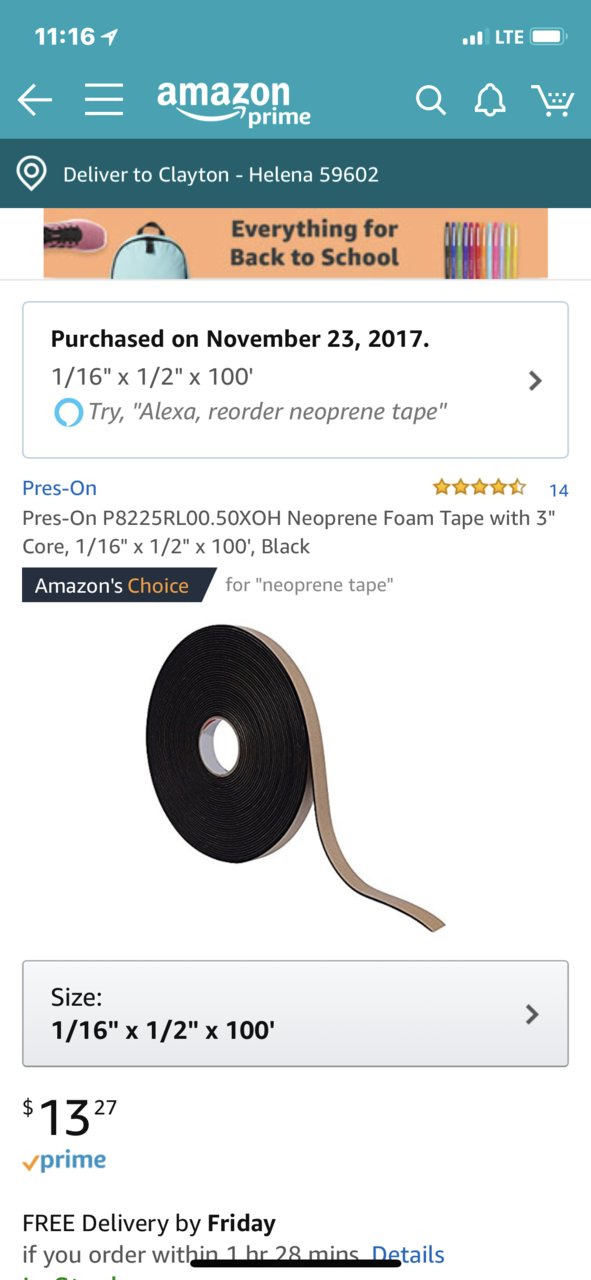

    Pics of this channel or part number from the work order? Or did they install it?
    Pulling mine apart soon and want to know what Im looking for.

    I added this product on the inside of the rubber molding around door. No more rattling

    Thanks for this tip. I added some foam between the outer weather strip and the window and it has thus far fixed my window rattle.
