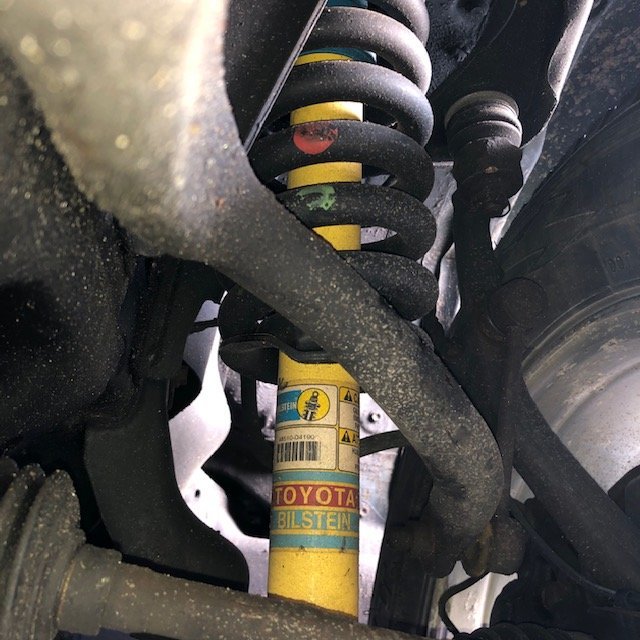

    OK so on the Driver side the end of the coil at bottom is facing front of truck, passenger side end of coil is facing rear, could this be my issue, Do I need to have the shock and coil assembly rotated on driver side so the bottom end of coil is facing the rear? as in picture above?

    dots on driverside are red / green, and are facing the front of truck, Dots on passenger side are red/ blue and facing rear of truck, I think the drivers side assembly needs to be turned around 180 degrees so the bottom of coil is facing the rear of truck like passenger side... correct me if I am wrong please

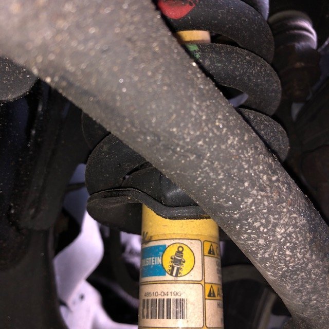

    here are a couple picture of the front coil assembly taken from the front of truck, is it installed backwards? and if so would this give the 1" lean in the rear that it has?

    Yes coil is correct but it’s not seated correctly. The bottom end should be facing the rear of truck not front as pictured

    Rotation of coil does not matter so long as its actually seated in the bottom of the spring seat properly.

    Turning it won’t matter
