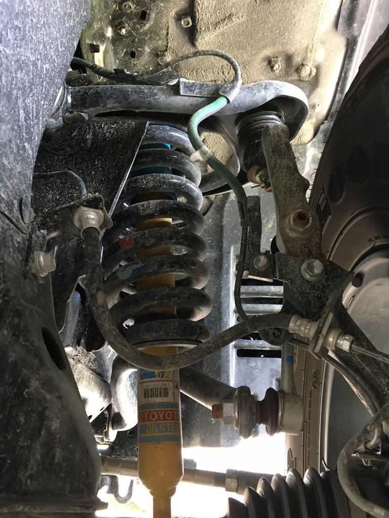

    I just picked up a preowned set of the stock Bilstein shocks and coils off of a 2016 TRD Off Road DCSB but trying to figure out which side is which. I dont think the back ones make a difference, but I think the front ones do. Does anyone know which color dots are for which side? Or if someone could be so kind as to check on their 2016 OR front coils to see which dots are on which coils. Got one with red and lt. green dots and the other with red and lt. blue dots.
    I am hoping someone here on TW would be able to answer this. I have attached a picture of the front shocks/coils for reference.

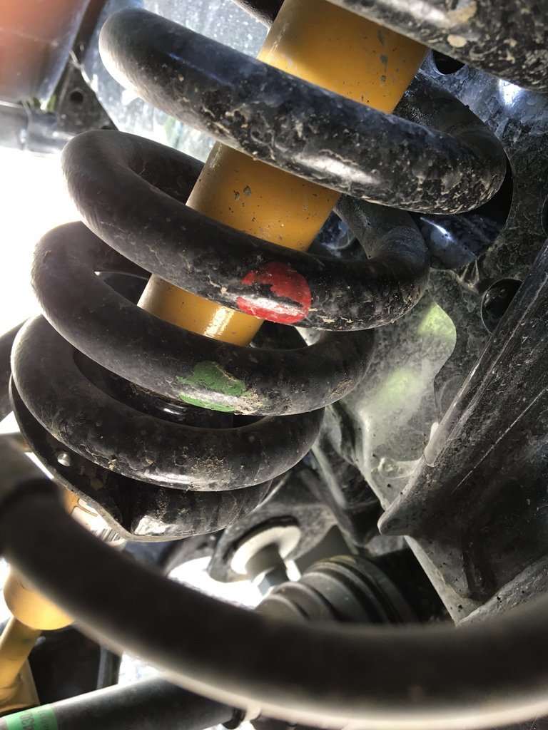

    I just checked my 2017 OFf road.
    Here it shows driver side with green and passenger with blue.
    Hope this helps.

    Checked mine too:
    Red & Green - Driver Side
    Red & Blue - Passenger Side
