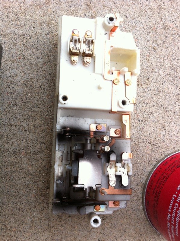

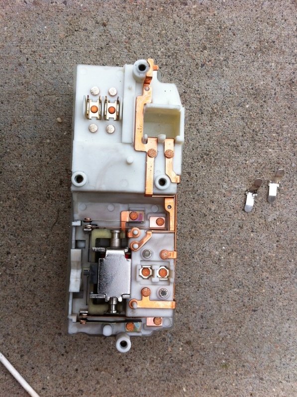

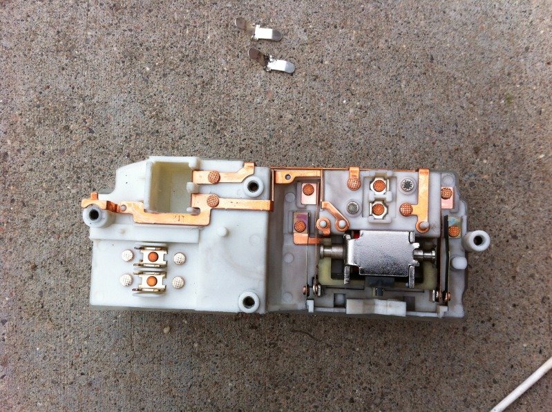

    What he said. Driver’s side up is often the most engaged contact on the master assembly.
    I had the same symptoms. It was just dirty contacts.
    Take the master switch assembly out and clean it with electric contact cleaner. The two large fins, pictured on either side of those plungers, are the contacts for the driver’s side FYI

    Is that picture from the switch in your door handle? I just took mine out and cleaned it up, but it doesn't look anything like that.

    Yes. That’s the master switch assembly found on the driver’s door.
