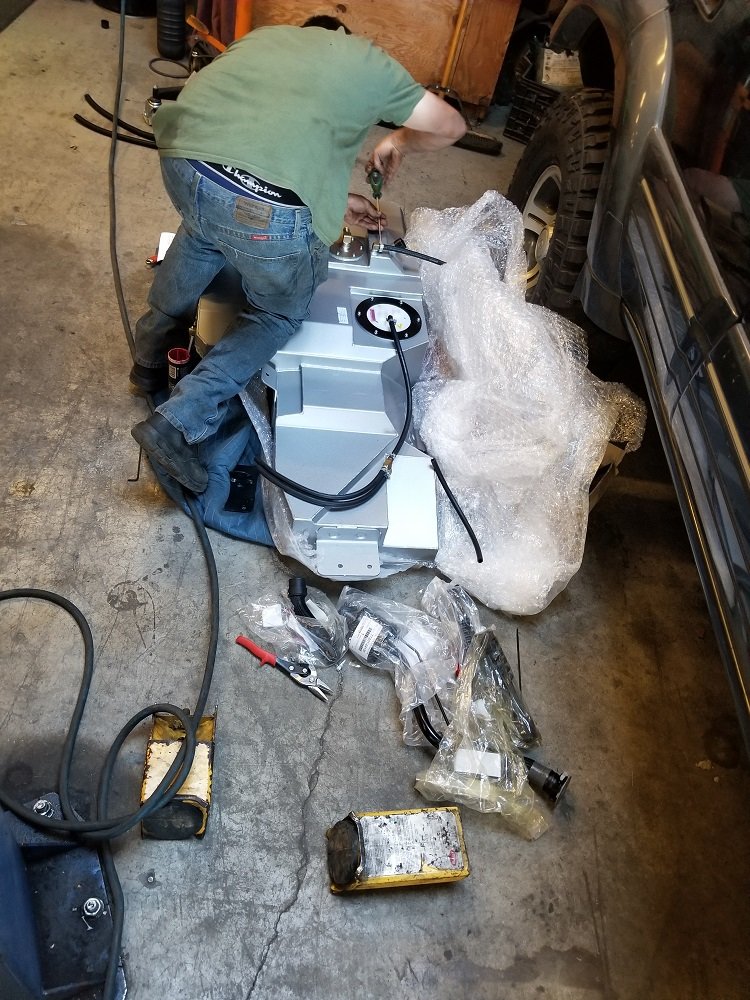

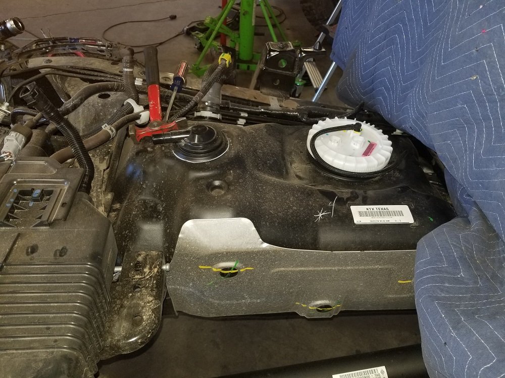

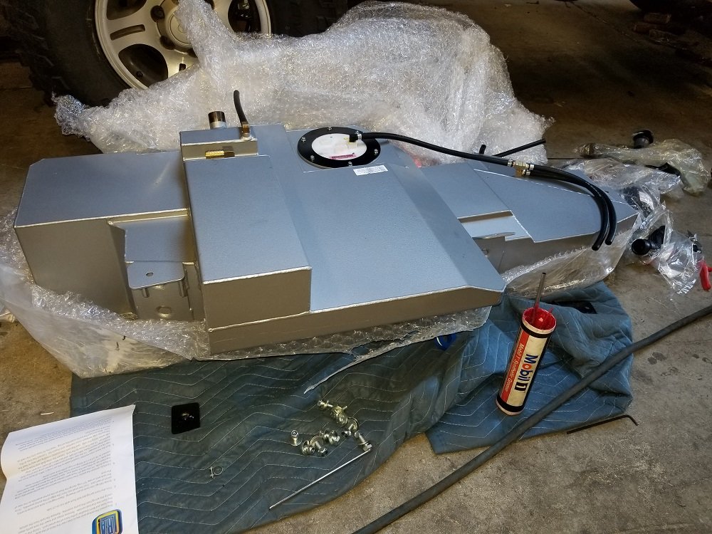

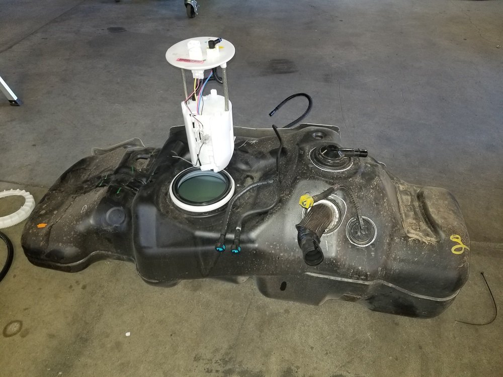

    showing the old tank
    Removing the fuel pump
    Installing old fuel pump into new tank

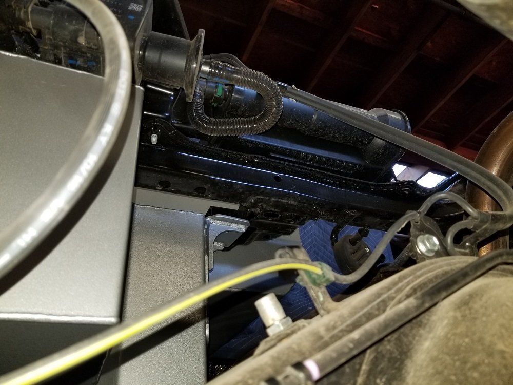

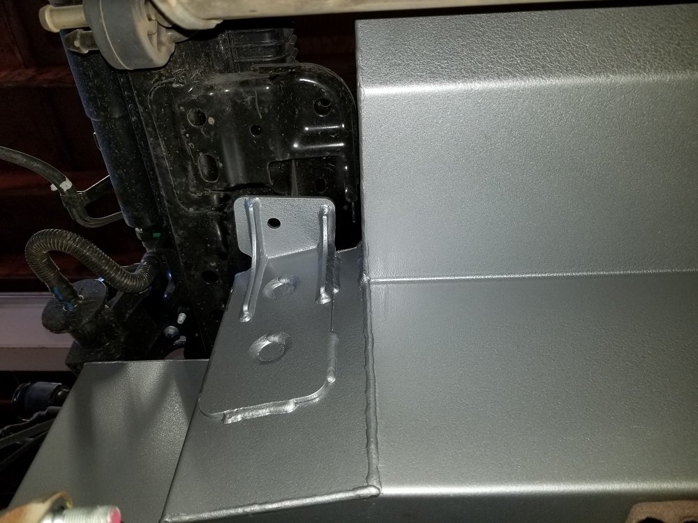

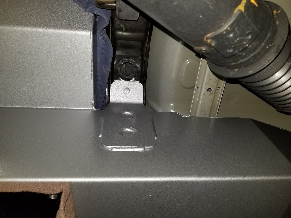

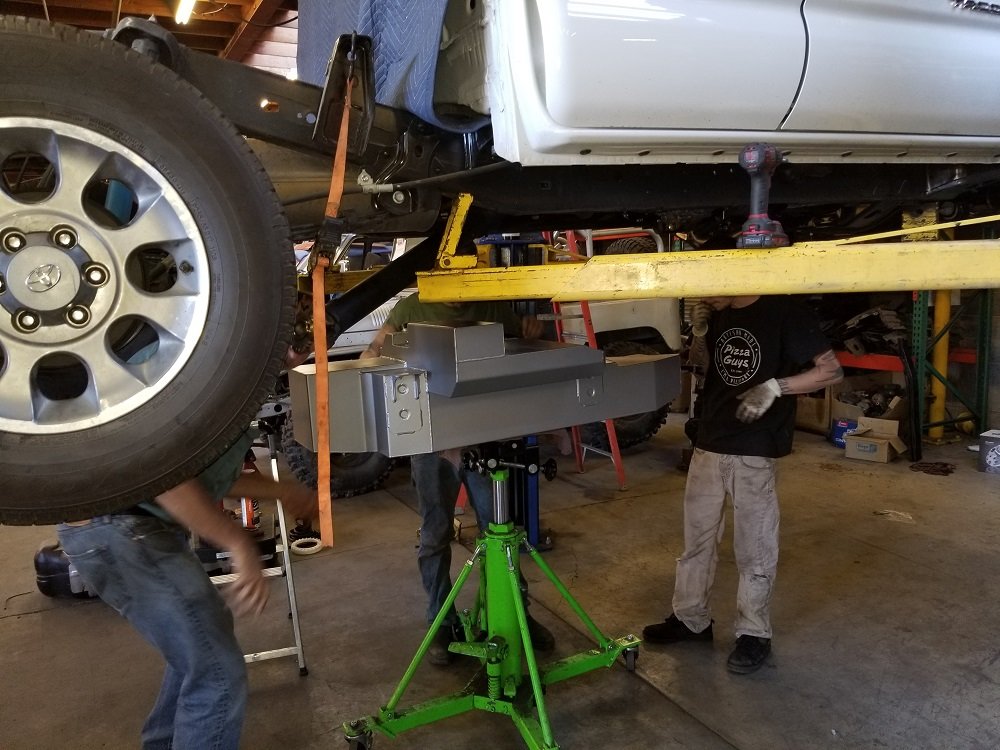

    New tank being installed
    The following mounting plates fit perfectly
    One of the mounts that needs a extender plate is not shown. I'll take a photo later

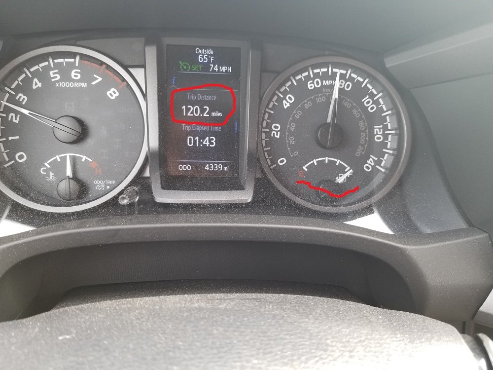

    Cool! I'm hoping the load E rating will resist punctures but we'll find out. Either way we'll be carrying an ARB tire repair kit.
    Here's a cool photo, 120 miles after fill up with the fuel gauge still above full! The only thing i've noticed now is that the distance to empty is about 50% too short, oh well
