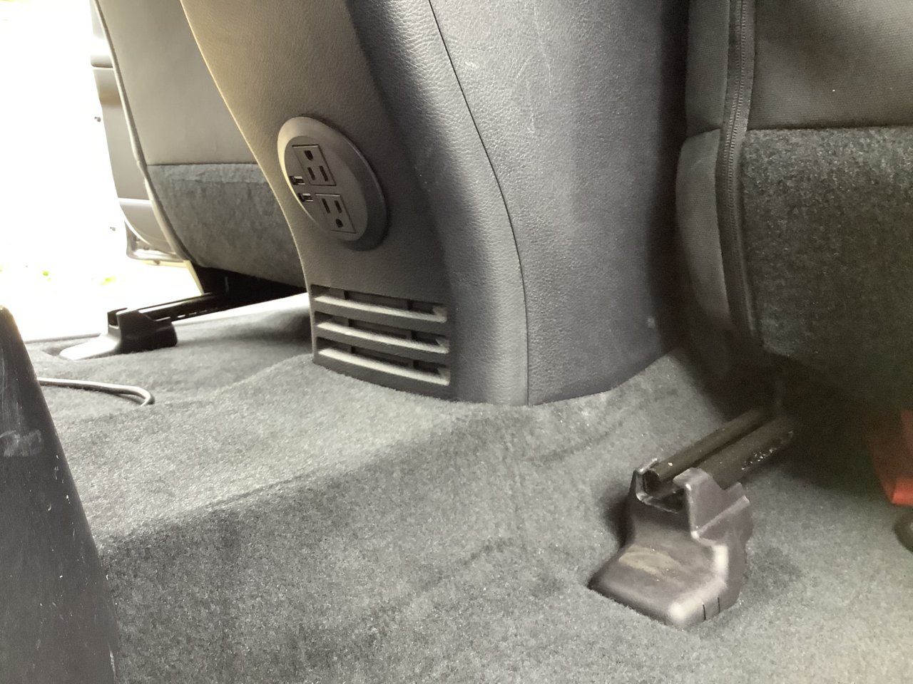

    Never could figure out why Toyota put an inverter in the cab of the truck but not an AC receptacle. So I figured why not add one as it will probably come in handy charging a laptop, toothbrush, whatever while the truck is running. ED3AF17E-17D8-405B-9C69-4C2184759A39.jpg
    Many thanks to @Grossomotto for his ideas on exactly what receptacle to use as well as how to do this on the manual transmission truck as the AT version is a bit different.
    This thread was used to allow my outlet to have 400 watts of output even when the truck is running, overwise you’ll be limited to 100 watts. https://www.tacomaworld.com/threads/3rd-gen-ac-outlet-in-cab-and-400w-anytime.505598/page-5
    Here’s another good thread:
    https://www.tacomaworld.com/threads/how-to-ac-outlet-in-cab-400-watt-anytime-mod.322320/

    Awesome! Looks like factory OEM :thumbsup:

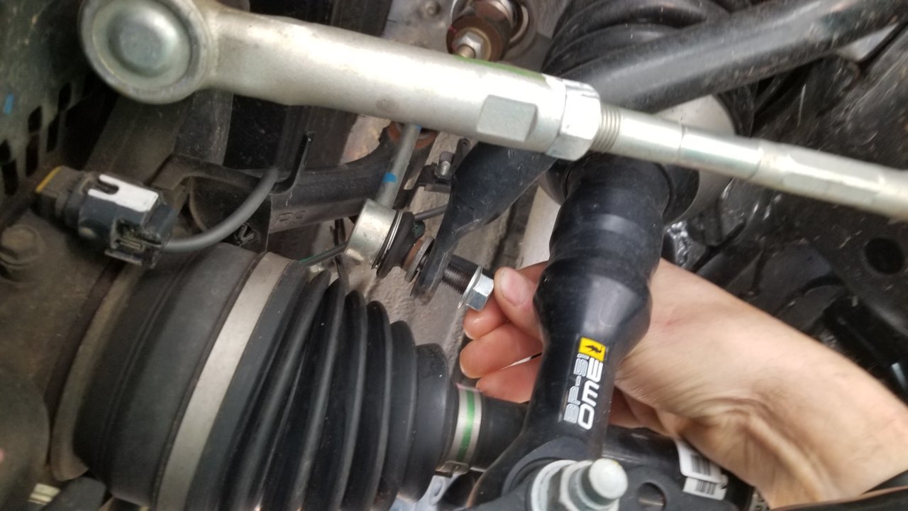

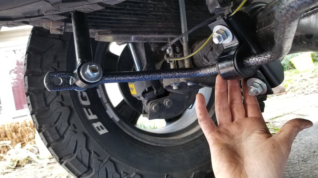

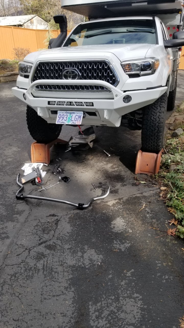

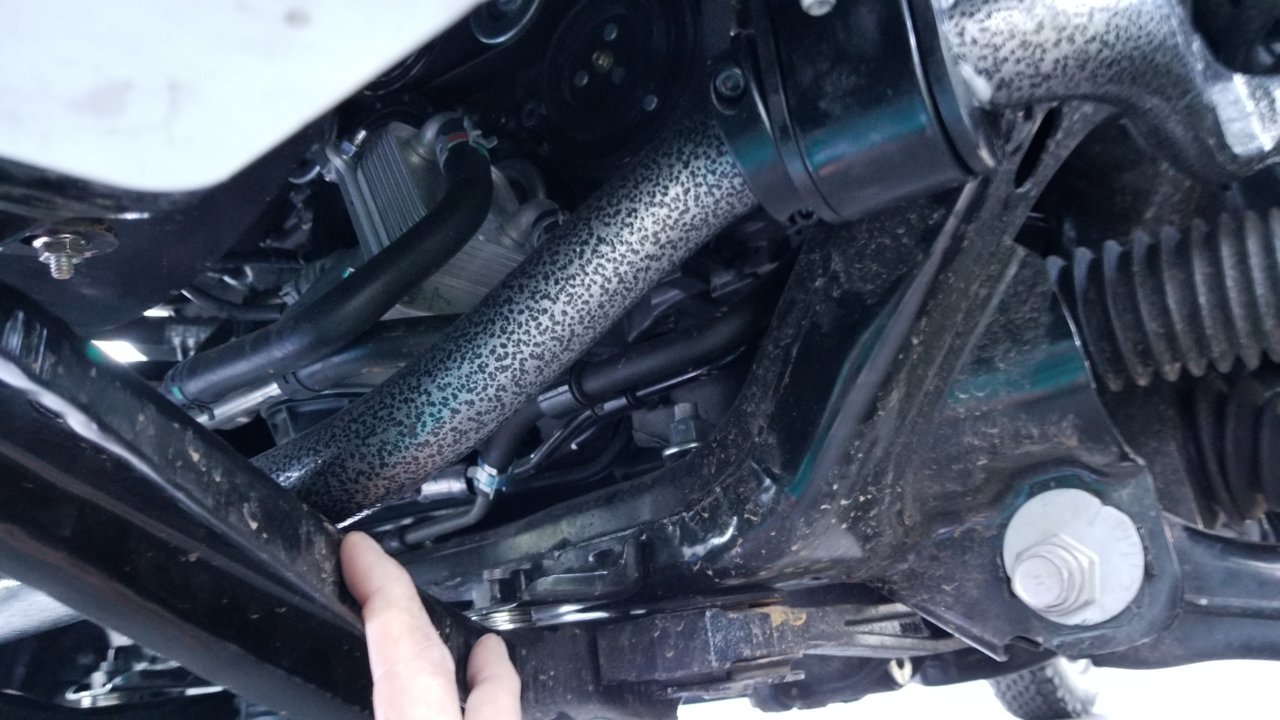

    Recently finished the install of Hellwig front and rear anti-sway bars. Took about three hours to figure it out/ install as the installation guide is not super clear. But the results are great. I now have little to no sway on corners. I’d highly recommend doing this if you’re carrying a bunch of weight. Cost was about $500 for both front and rear. Almost thinking that I don’t need the Hellwig front bar. Before there was a bit of side-to-side motion and now it’s eerily flat around corners.
    And now the completed rear sway bar installed.
    Basically the install is to make sure that the bar to the left of my hand is parallel to the ground and the vertical shaft is perpendicular to the ground.
    Notice the 10 leaf Deaver springs in the background
    THe front install was a bit more complicated because I had to remove the front splash guard, two bolt-on frame extensions, and the existing front sway bar.
    Here’s the frame member that needed to be removed. Unfortunately the slightly larger sway bar was rubbing on the frame member where my finger is pointing so I had to remove it and grind on the sway bar.
    Some bolts were a little challenging
    Overall super happy with the sway bars but did add about 20 lbs of weight.

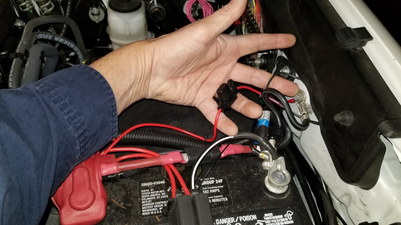

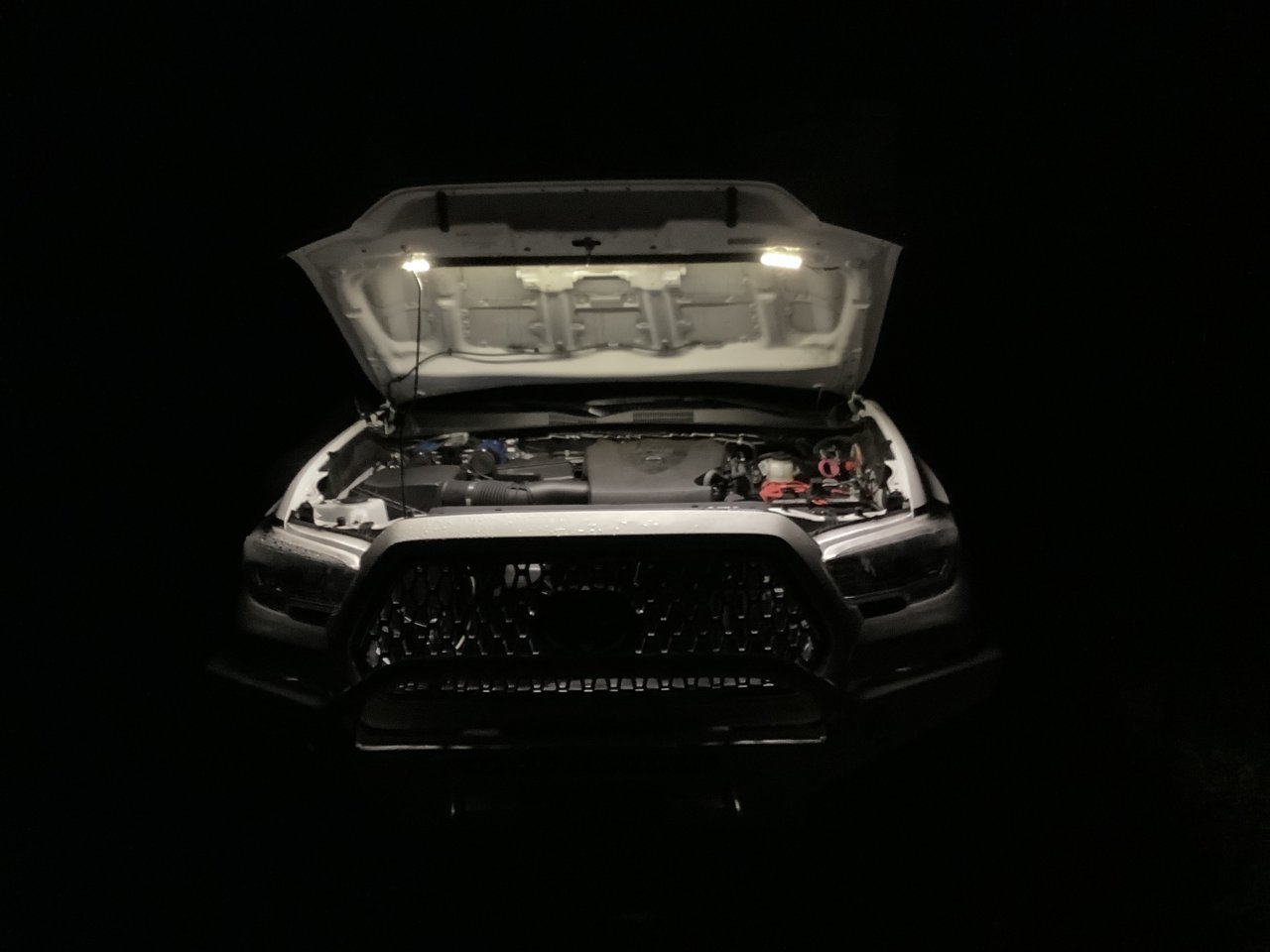

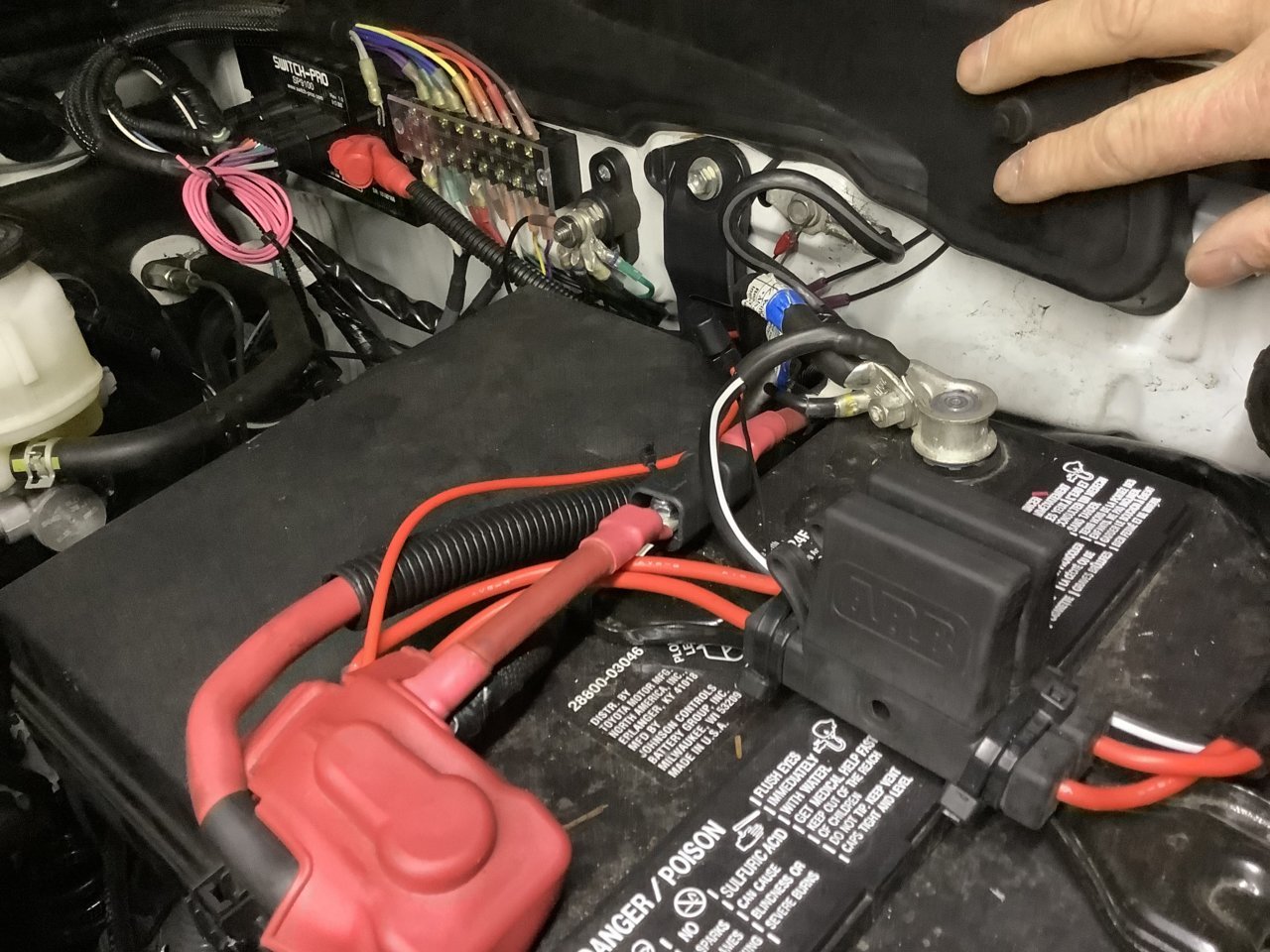

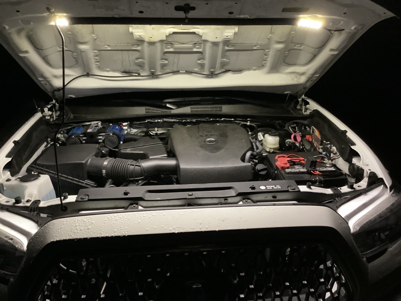

    Recently added a Matt Gecko hood light. Took about an hour to install. Looks super clean and lights up the engine compartment really well.
    It evenly lights up the entire engine compartment. With it mounted immediately behind the rubber gasket on the bottom part of the hood there’s no glare in your eyes.
    I permanently mounted the supplied switch in the plastic cover. Works slick. I highly recommend the light
    Here I’m holding the supplied fuse, my middle finger is pointing to the ground. mounted switch is off further to the right in the middle of the black plastic

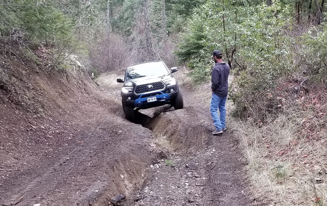

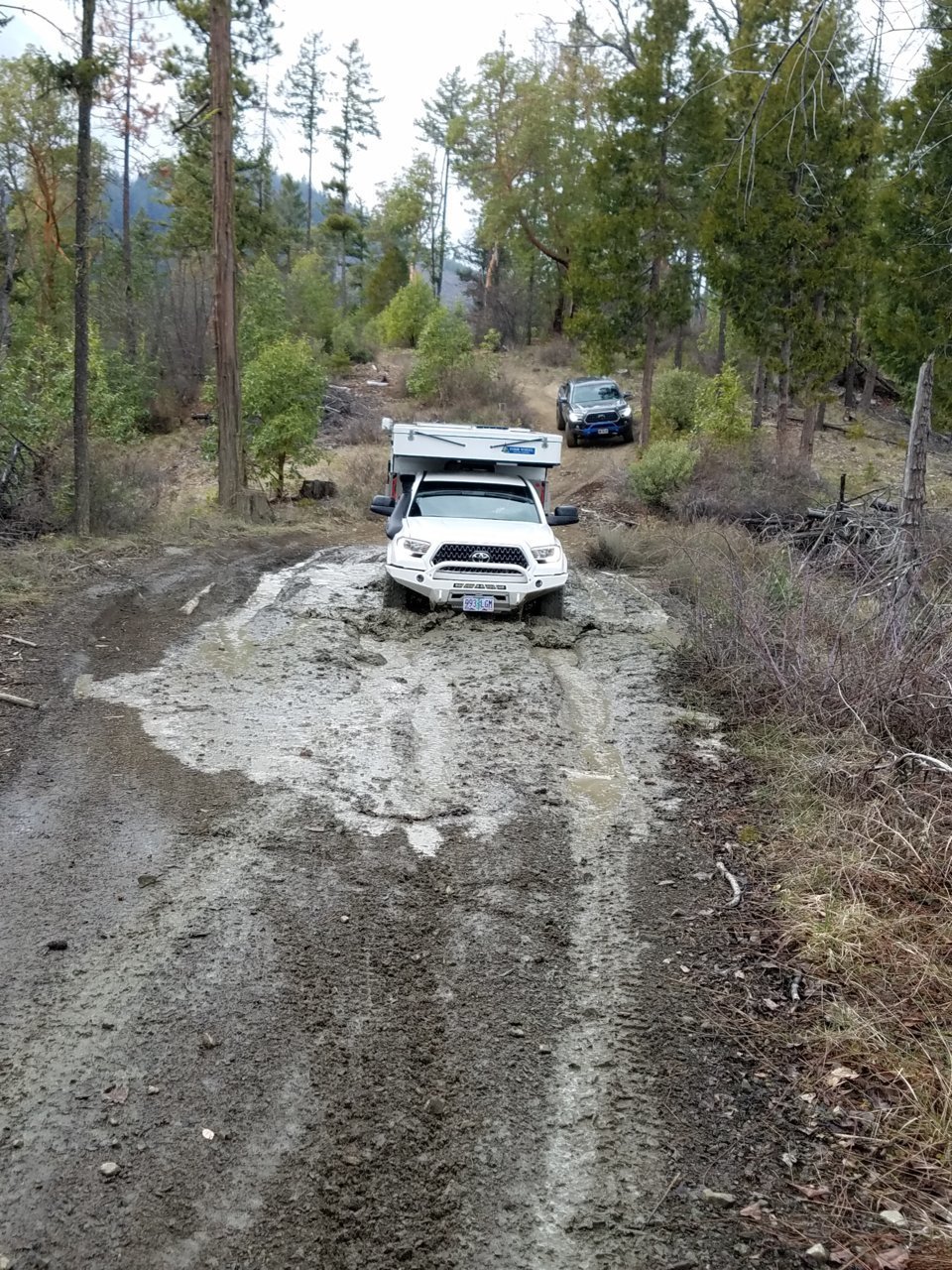

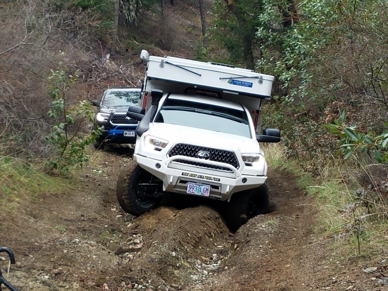

    Did some wheeling today with @Taco Roofer and @gemiv19 and had a great time in the hills west of Medford Oregon, snow and all.
    Going through a small but pretty deep mud hole with the rear locker engaged.
    This was the crux of the trail and i slipped in and was hung up for a couple of minutes. Thought both lockers would allow me to just crawl out gracefully but no had to give it a bit of gas.
    Was partially dragging my rear diff in the dirt
    After using the gas to power out i popped what i thought was the first of two pretty tall wheelies. The front driver tire felt like it must have been 18” off of the ground, just a bit of a pucker! This photo by @Taco Roofer is showing just the tail end of the wheelie.0F601D16-EFD1-47BE-AA71-612712F517E4.jpg
    Here’s @gemiv19 showing how it’s supposed to be done.
    A good day.

    Honestly you were getting closer to a 24" wheelie haha! I was saying nice job but thinking oh sh*t! Lol
    Great build bud, can't wait to see what the future holds for you and your rig!
