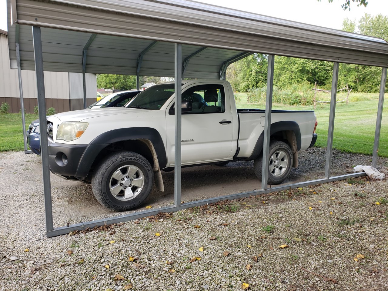

    I have a 2nd gen 2.7 on 265s. It doesn't drive bad. It's a 4 banger so your not going to go anywhere fast but it gets the job done. It's not worth it getting a regear if your just going to run 265s.[​IMG]

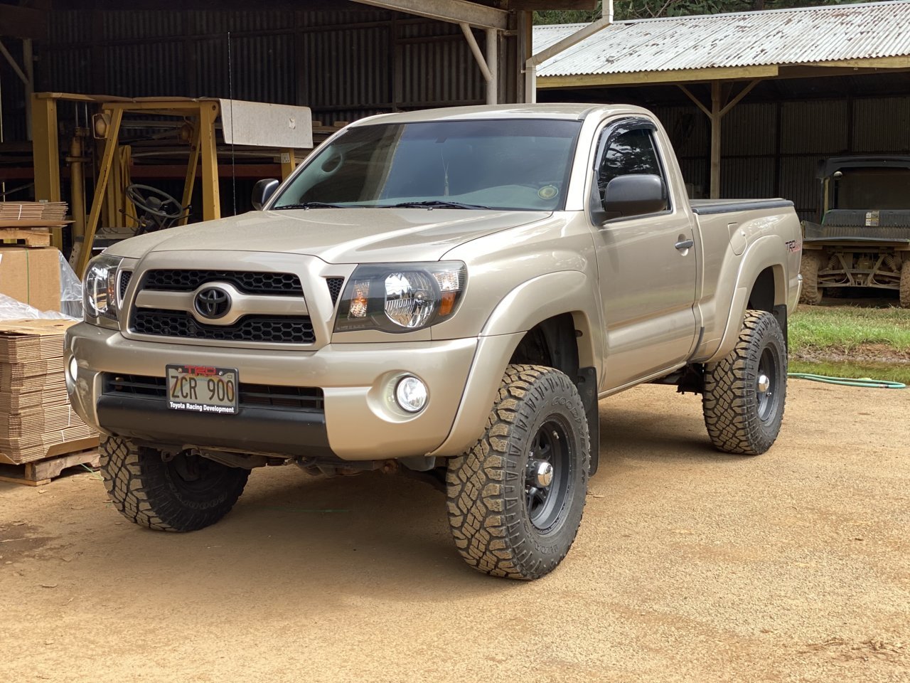

    I have a 2nd gen 4cyl 5MT. When I stepped up from 245’s, I definitely felt and noticed the heavier 265/75 Duratracs for the first few days. For me, the change was purely aesthetic.
