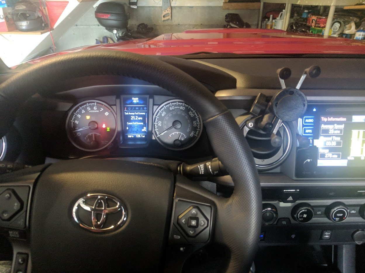

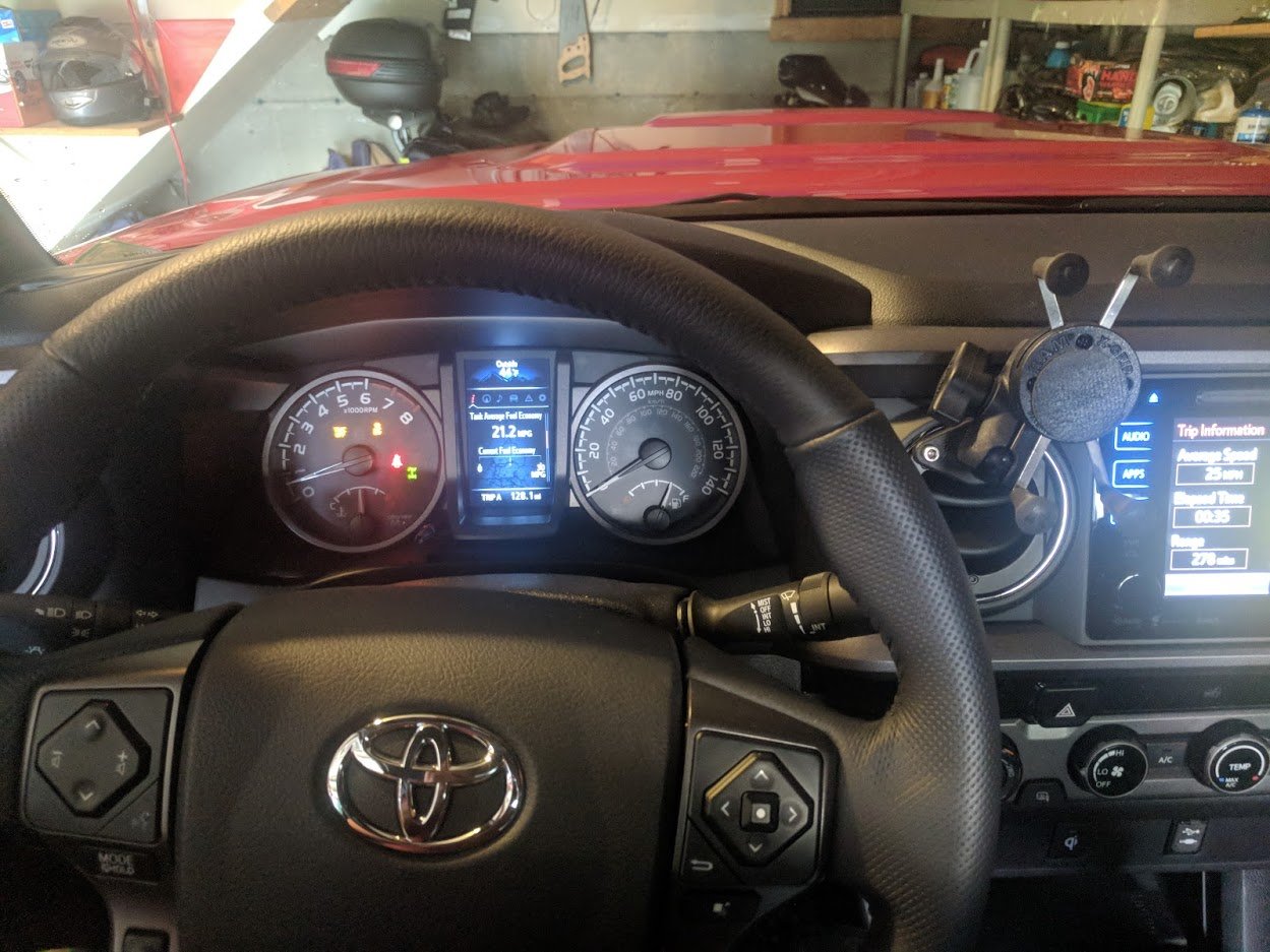

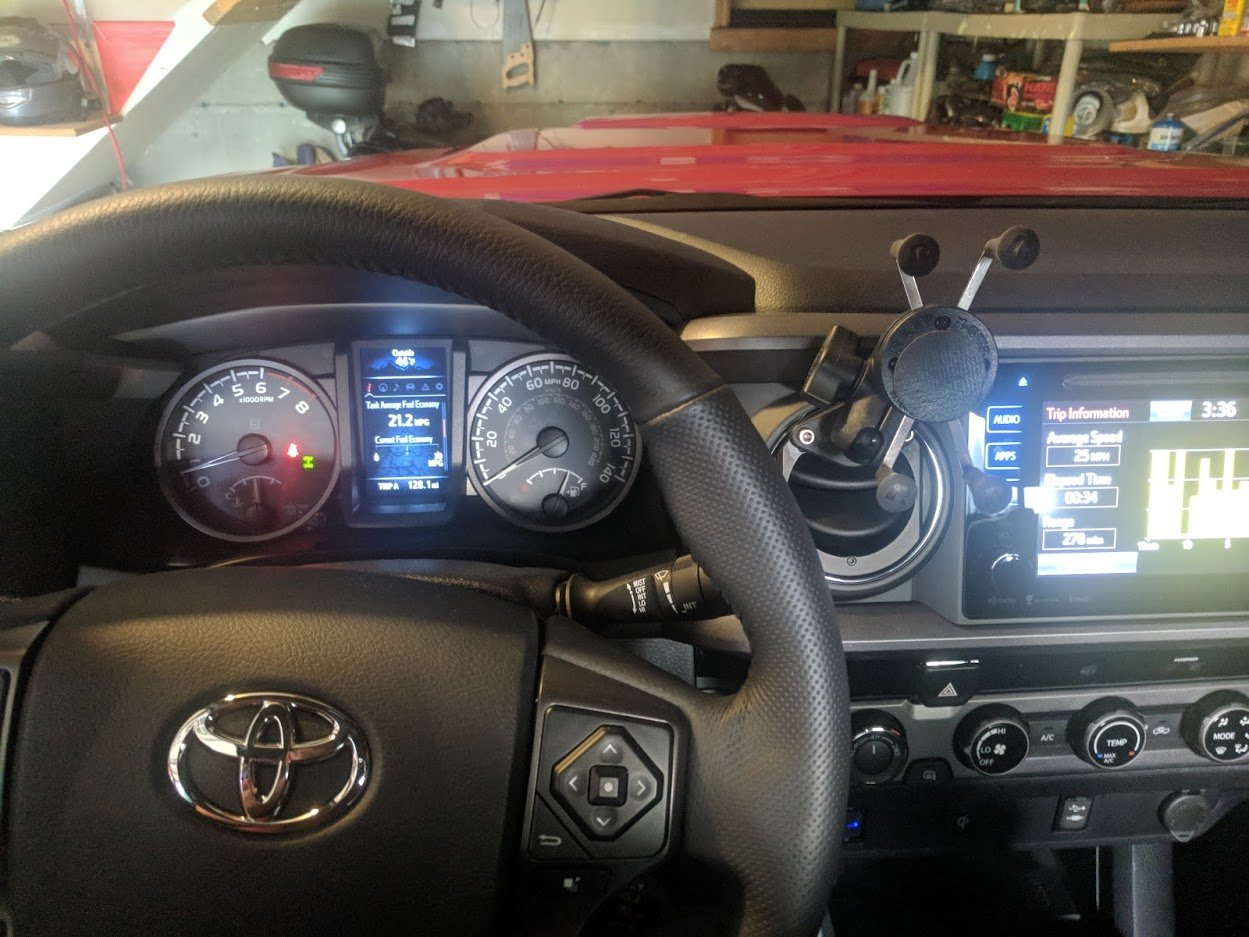

    You might have been going for the simple answer here, but the system does have steering wheel angle and yaw sensors. It will try to react and correct in a slide. But like you said, the available traction many not be there to actually do anything.
    Edit: I confused 4Hi and 4Lo defauts. You are exactly correct. My bad!
    It can be toggled with a Short Press of the TCS Off button, as well as a Long Press while stopped to turn VSC Off.
    https://www.tacomaworld.com/threads/3rd-gen-traction-control-modes-explained.530695/
    For my Sport:
    4Hi Default:
    4Hi Short Press:
    4Hi Long Press:

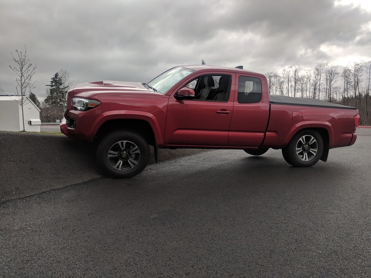

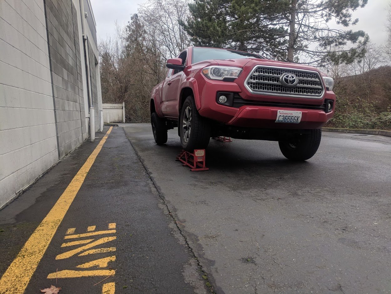

    Well, I'm usually an RTFM guy, but the manual was really weak in this section. A bunch of us worked to get that sorted out. Of course, it did take some mall crawling to figure it all out.
    A couple ramps was a no go:
    But, this spot worked out well:
    The non-OR / non-Pro models will move with wheels off the ground.
