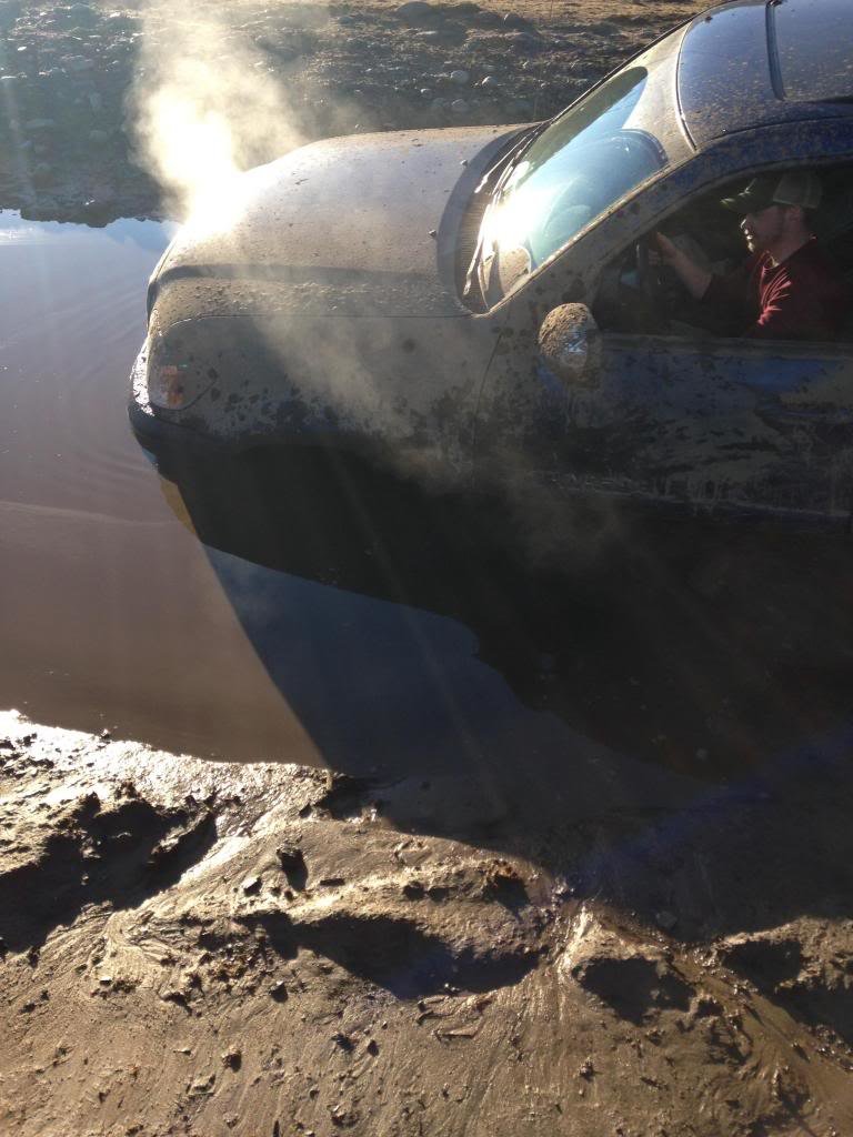

    I got stuck in a mud hole and it was probably 2 or 3 inches up from the bottom of the doors and I got nothing in the cab. You could see the water line on the door jams and it was clearly above that. I spent probably a good 5 minutes there too until I got out lol
    Here's my buddies tundra stuck in the same hole
