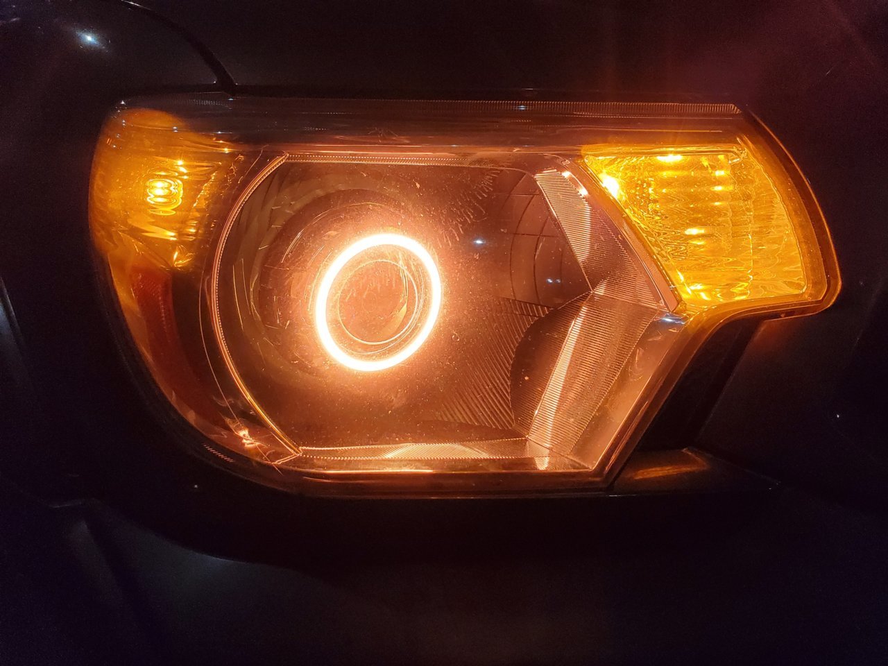

    I did a retrofit and I noticed how hot the DRL lights are getting, when parking lights are on. Was thinking about led. Wanted to get some opinions. Any special resistors or anything special to make this work?

    How often do you use your DRL? Unless you’re flaunting your halo’s. The DRL dims when your headlights are on. And yes, LED’s require resistors

    The system is stock and works as designed. The mild heat is a non-issue.

    I put LED's in for my turn/DRL because a guy at work with an older 2nd gen Tacoma (2011 I think) had issues with his headlights due to heat from the DRL's. As said before, the issue isn't a concern with the new headlight design.
    If you do use LED's, you need resistors and you also need a CK LED. Non-CK LED's will blow the turn signal fuse. I used 6 ohm, 50 Watt resistors mounted to sheetmetal nearby. The resistors will get hot and mounting them to sheetmetal will act as a heat sink. I'd have to look to see which wires I connected the resistors to.

    I would go with LED's. The heat from the incandescent DRL's can cause the lens to fog inside over time. (I had this happen to my factory headlights. There was a smoky haze on the inside of the headlight lens around the DRL bulbs. The bulbs were factory.) When I upgraded to retrofits I went with amber VLED Tritons during their Black Friday sale last year.

    I'd be interested in any more info you have on this and if you have any part numbers for the resistors you used. Lots of options, big size and mounting differences. Thanks.

    Grundle (never thought I'd be typing that here), check out 50W 6 ohm resistors on Amazon. They're about $5 or so and the same as the ones you get from diode dynamics but about 1/4 the price. I'll look on the truck in the morning and see which wires I connected it to. I'd go right now but the trucks outside and its pouring down here. I found the info online but it's easier to go to the truck.
    I attached them to the radiator support using a thermal adhesive but you can use screws. I've been running them since 2015 with no problems.

    Thanks for the reply. I think I have two of those left over from my old truck. With the DRL (Canada spec) they will be constantly on and probably produce a serious about of heat. I wonder if there is any other load resistor with a more efficient heat sink or way of consuming power? Off to the interwebs!

    I looked at the truck and after I made connections I taped it, I didn't really want to take that apart so I checked my notes. I've kept track of everything I've got since about 2004, every fillup, every mod, mileage calcs, etc, so I checked my notes!
    My notes said I put the resistors between light blue and white with black stripe on one side, and yellow and white with black stripe on the other side. The 3rd wire present is green, basically don't connect the resistor to green.
    You are correct that they'll be on constantly if DRL is on, US just has the DRL switch position. They do produce a lot of heat, that's why I have mine attached to the metal radiator support with thermal adhesive. It's been that way for 5 years and I run my DRL's on too. I hope your wiring colors are the same being Canadian. If you have a multimeter you can check by looking for pulsations, just stick the probes in the terminal and you should see voltage fluctuations while flashing.
    Remember you need CK type bulbs as well for the front.
    For the rear you don't need a CK type bulb and there are only two wires. Since these are only on intermittently and even then only operating at 50% duty cycle, they'll not get nearly as hot. In that case, I honestly was lazy and just connected the resistors and let them hang. I tried testing the flasher while holding the resistor and it wasn't getting hot enough to cause me concern.
