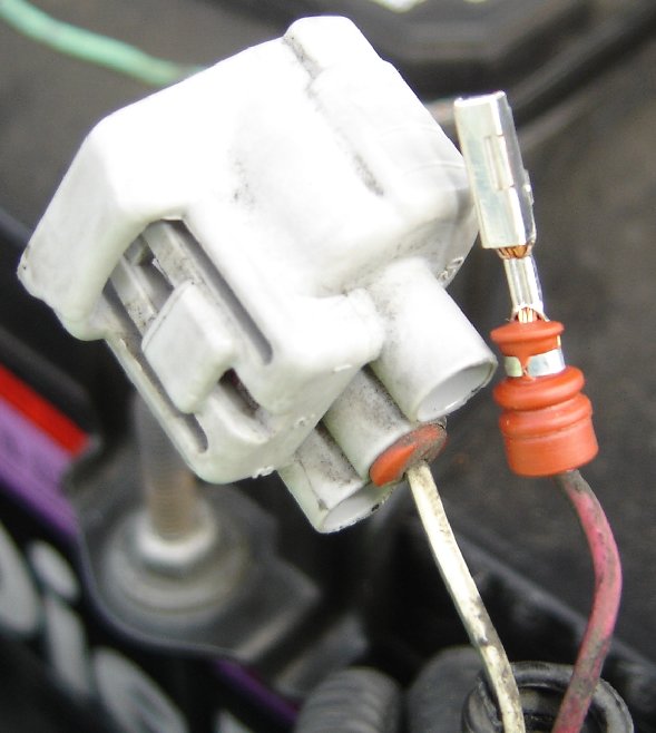

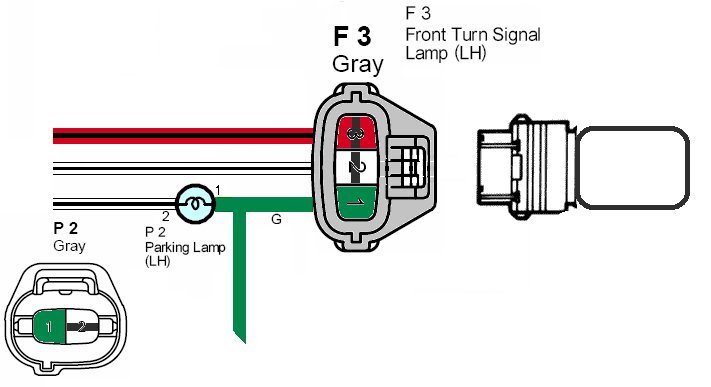

    For the turn signal sockets, there’s only 2 terminals in the socket. You need to add a 3rd terminal and wire it so it’s energized when you turn the key on.

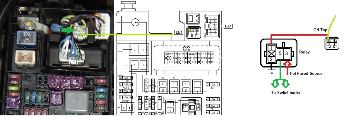

    So... you tie your third wire to the ground of the park/mkr light for switched power?
  11. Nov 1, 2020 at 8:12 AM
    Muddinfun
    Muddinfun Well-Known Member
    Apr 17, 2017
    #216500
    7,489
    If you tie your 3rd wire into the park lights, your new white DTRLs will only light when the park or headlights are on. If you want true DTRL, you need to wire it to a key switched source.

    Or cut the nipple off the firewall grommet, and run a wire to 1 of the several good places in the underdash fuse box. Then you don’t need a relay.
