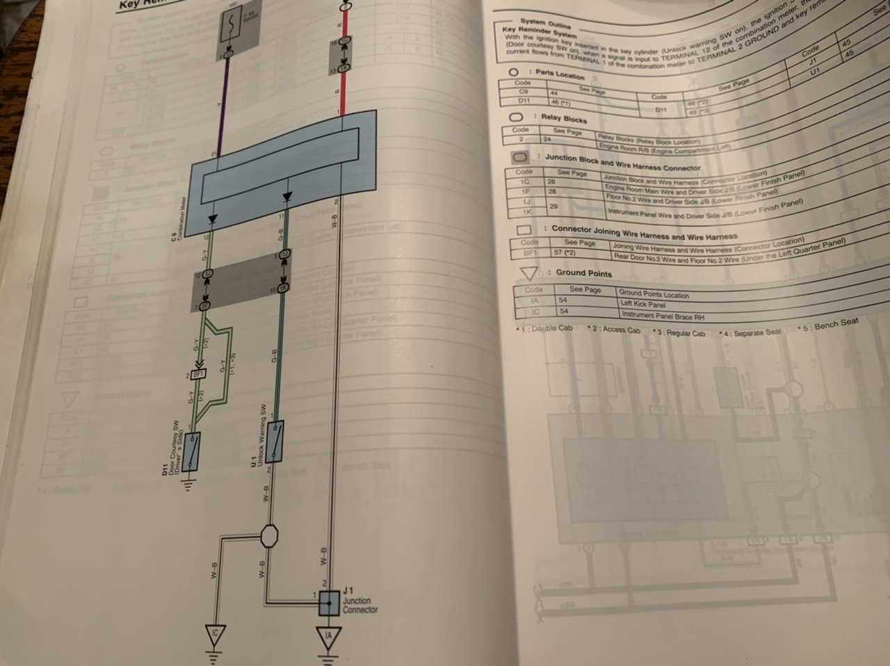

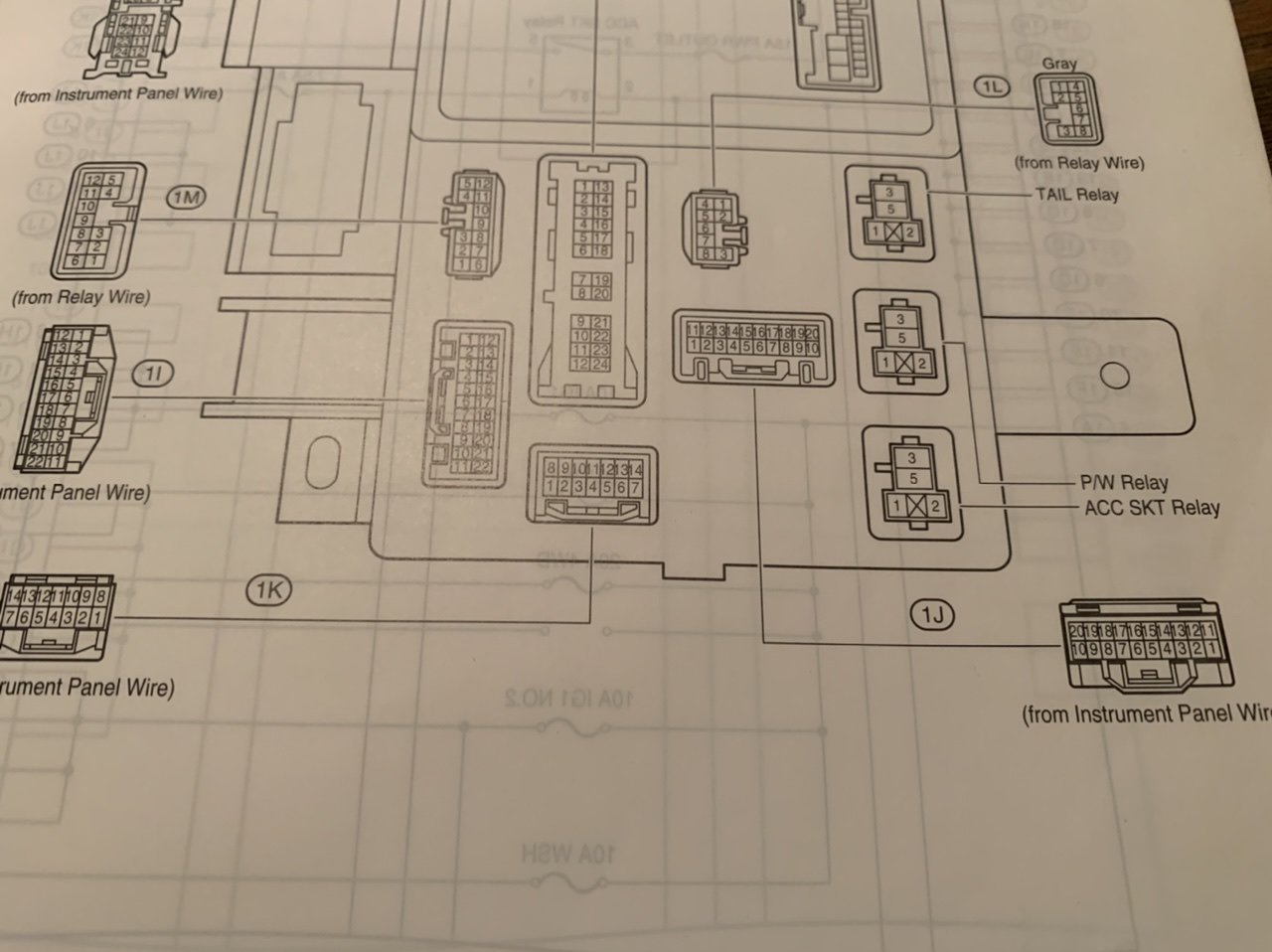

    Update: I think if you depin 1J pin 5, it will silence the beeper without any side effects.

    Took #5 pin out and it’s back together no beeping. Yay! Thanks!

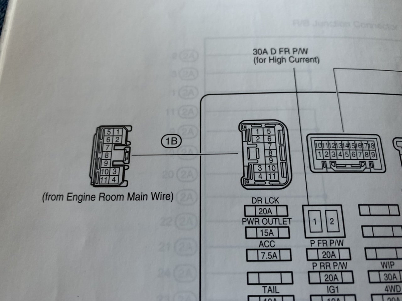

    Impossible to predict what went wrong, but if the rear is working, the flasher is doing it's job. Without the grey plastic jumper block, you would only have rear turn signals. The jumper block ties the rear turn signals to the front. The only thing that comes to mind would be a bent pin on the fuseblock or a connector not plugged all the way in. The left front turn signal output wire is a red/black wire at 1B pin 7.

    Thank you for the all the help your giving I really appreciate it. I will take the fuse block back out tomorrow evening and check that pin

    That pin is on the side closest to you. Just poke the terminal with the test light.

    Ok I have right turn signal flashing on pin 5 grey wire that goes to right turn But nothing on pin 7 yellow wire that goes to left turn signal?
