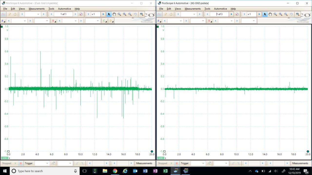

    No one forgot. This is the pic that the OP provided.

    They did not scope a stock truck with the same results, they did some test regarding probing the same ports on the body ECU and removing the DRL relay on the stock truck.
    Today they will be scoping my truck, at my expense, with each aftermarket part unplugged one at a time. Once I have those results I will post them up here for all of you (good or bad).
    The results of today’s test, which again I AM PAYING FOR, will determine my next course of action. If the signal noise is still there after all parts are removed, I would expect Toyota to repair the headlight under warranty. If the signal noise is not there, I will remove whatever part was causing the failure and repair the headlight myself.

    This is more a general statement about diagnosing this issue.
    The part of this that makes me believe that it is not an aftermarket part is the bottom part of this graph. This truck has a DC electrical system. So high voltage and 0 voltage. And many voltages in between. It doesn't have negative voltages. Now I am no Electrical Engineer, so if I am wrong on that then please correct me. Now with that in mind I see negative voltage spikes on the graph. This to me says A/C voltage. There are only 2 sources of A/C voltage on these trucks. The Alternator and the Inverter. To me the alternator is a better source because diodes in it can fail and they do some funny stuff to the DC voltage control systems in vehicles when they do fail. Just my 0.02 cents.
    I definitely have an interest in knowing the outcome of this problem for the purpose of knowledge.

    For whats its worth (didn't read the book of a post word for word) but as an electronics engineer it sounds like it could be something as simple as a grounding issue. Drill a another ground point to the frame/body of your car attach to the negative terminal of the battery. Then if that does not work make sure the devices that are shorting have a heavy enough gauge of ground wire. This would also explain the noise. Fixing grounding problems can cure a lot of electrical demons in newer vehicles. Either way, never quit modding

    I am also not an EE, but your analysis makes perfect sense to me. Hopefully someone who has a background in this stuff can chime in with their thoughts.

    You can pick up noise like this on DC systems. I bet you a dozen crispy creams the guy has a grounding problem

    Thanks for the confirmation! It will be interesting to see what the results of the test are. The only part with a ground that is not just plugged directly into the factory wiring is the raptor light harness.
