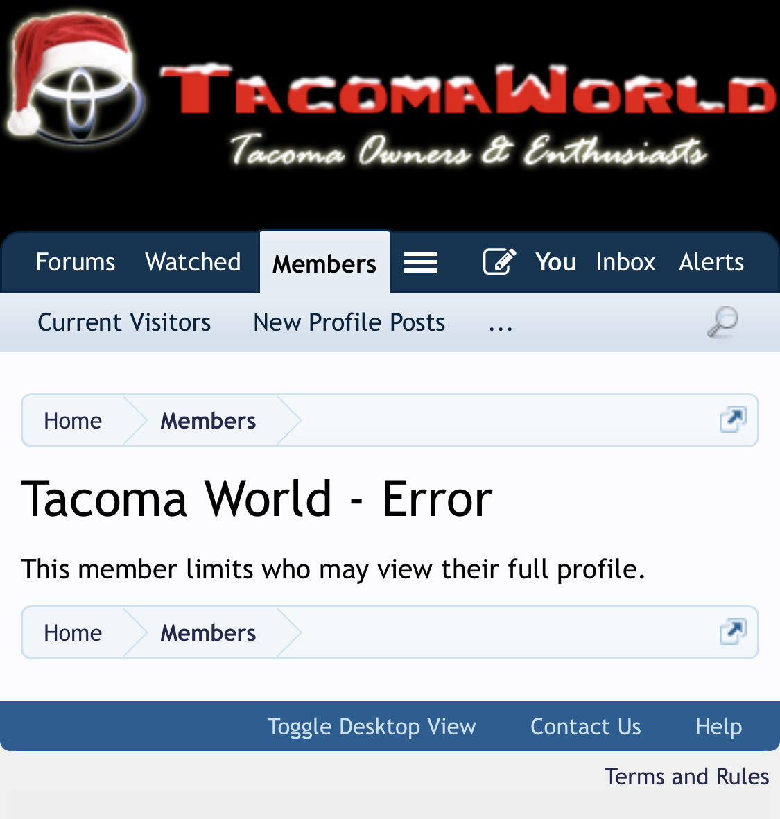

    this dude blew out his headlight cause his aftermarket LED bar was shorting out the circuit, I think his getting a lawsuit against Honda corp. right now cause they wont replace it for free, he wants them to troubleshoot the LED bar for him so they can implicate themselves.[​IMG]

    Hey @BillsSR5 how about unlocking your profile so I can check our your builds and off road adventures and what-not? Always interesting to see that kind of thing!
