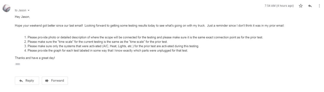

    I do not. I did email them this morning to request that the test be done under the same conditions as the prior test:

    Nice man. Almost makes me think you're an engineer. Definitely written like an engineer haha.

    Just a lawyer who has been working on/modifying cars for his whole life.

    Interesting. I can see how as a lawyer you have to be meticulous and pay attention to the details.
    That's the biggest thing about taking data and comparing data. A repeatable test plan with every variable accounted for. If you had presented the first data and the second data (while unplugging the aftermarket lights) without listing all the things you put in your list, it would get shut down right away here. I guess Lawyers are smart.
    Taking the correct data, then presenting the data so it's easily understandable. Hence the time scales, the labels, everything.
