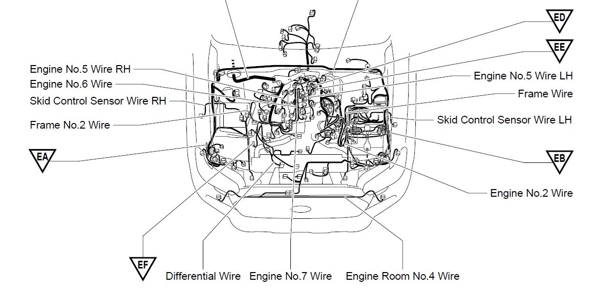

    That ground point and the one on the other side of the engine bay are actually wired together and have a lot of things grounding to the same point:
    RH Headlight
    LH Headlight
    RH Fog Light
    LH Fog Light
    ABS Actuator
    Heater Relay
    Air Pump
    Trailer Wiring
    Windshield Wiper Motor
    Radiator A/C Fan (Mexico-spec)
    Jeff

    EB is that particular ground.
    I wonder what a faster sampling rate might show.

    EA is the other ground I was referring to.

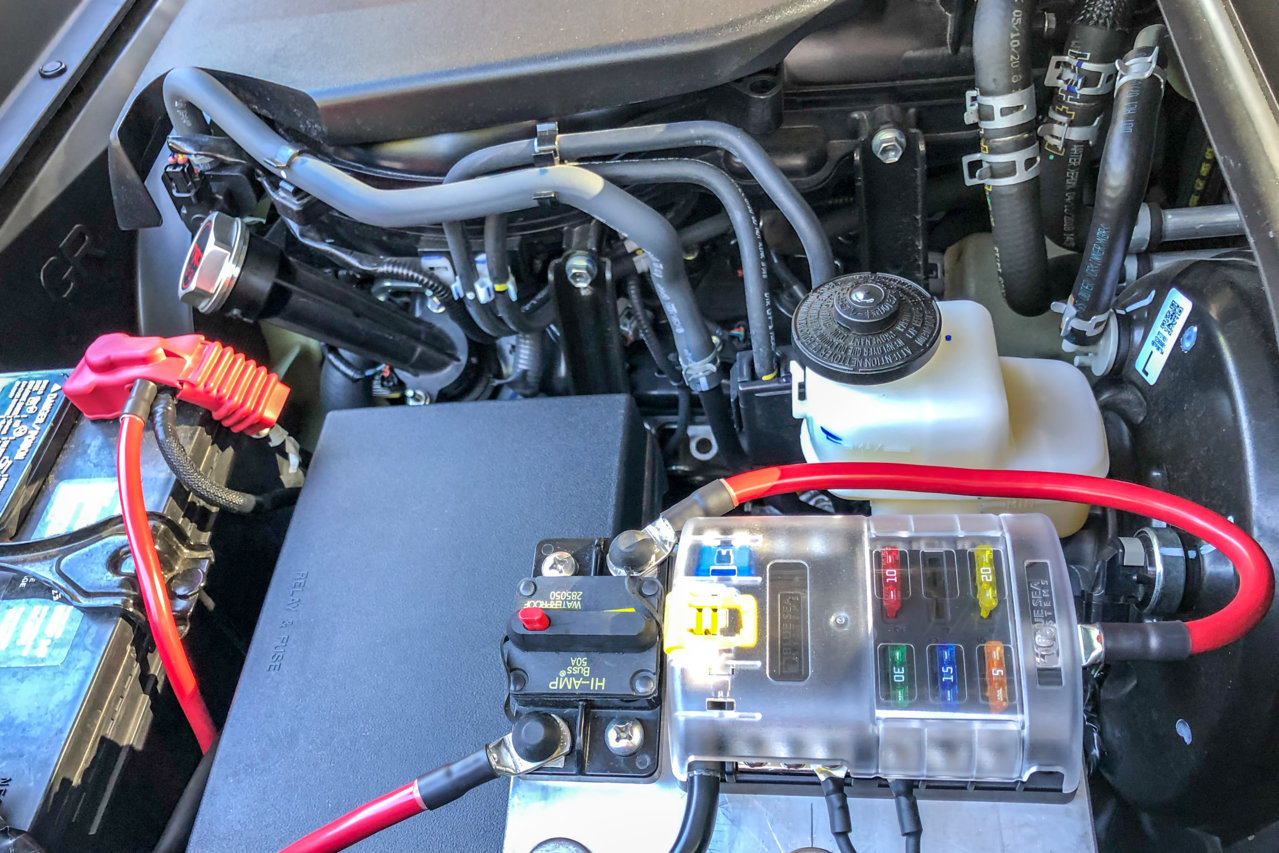

    Thanks, another member JUST PM'd me the same diagram. I just ordered the whole kit from Powertrays with ground bus, fuse panel, circuit breaker, etc. Hopefully just having all aftermarket parts grounded directly to the battery will solve this problem but unfortunately, I fear that there is a bigger electrical gremlin at play here.

    I'm not a fan of grounding directly to the battery post.
    https://www.w8ji.com/negative_lead_to_battery.htm
  13. Dec 16, 2019 at 2:48 PM
    #453
    therealprotaco
    therealprotaco [OP] Always Skeptical
    Jan 3, 2017
    #206408
    1,312
    Gilbert, AZ
    2021 Lunar Rock Tundra TRD PRO DC
    Would you recommend creating a new chassis ground or grounding to the same chassis ground that the batty is grounded to? This would be for the new ground bus in the blue seas panel.
    1992SR5V6 likes this.
  14. Dec 16, 2019 at 2:53 PM
    #454
    splitbolt
    splitbolt Voodoo Witch Doctor
    Mar 7, 2010
    #32761
    7,858
    NW Arkansas
    2016 TRD OFFROAD DCSB MGM
    New chassis ground.
    The link I provided is a good read...;)

    Glad you got a resolution. The Blue Sea fuse panel does a great job. I have everything running thru it except my Morimoto fogs, they are a direct replacement. I run the ground from the Blue Sea to the same frame ground the battery uses. Also get the 12 circuit model, I thought 6 would be plenty, but now I only have 1 free more circuit.

    I wish there was a resolution. At this point I think everyone is still guessing. I ordered this kit from Powertrays:
