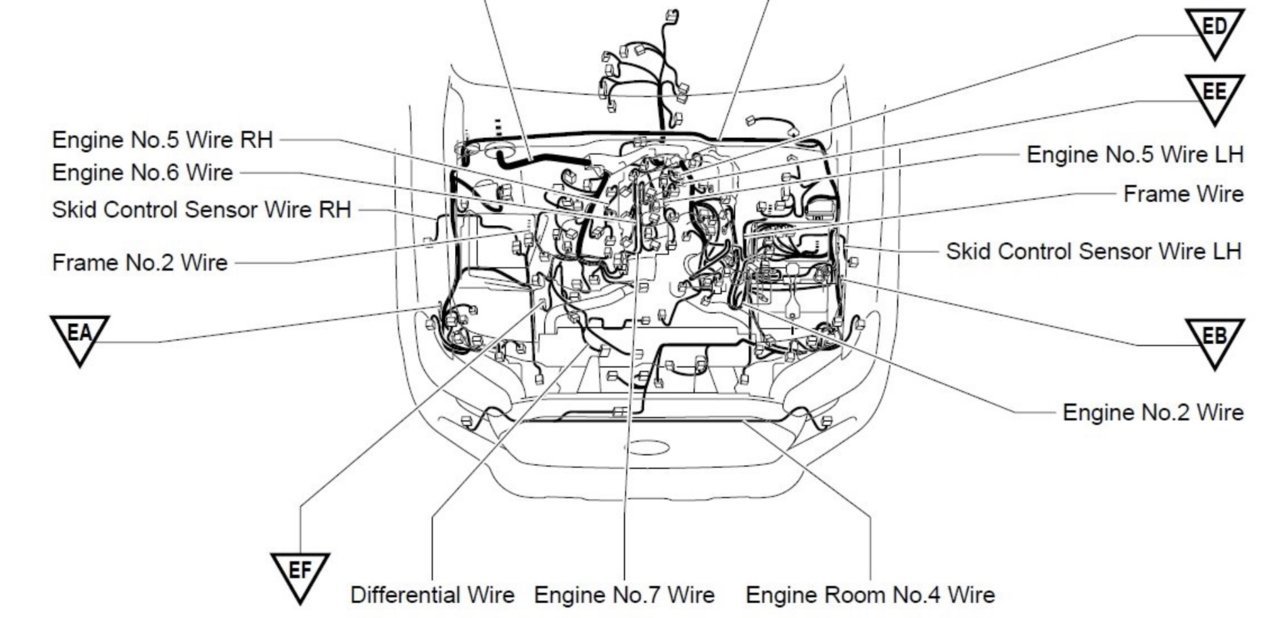

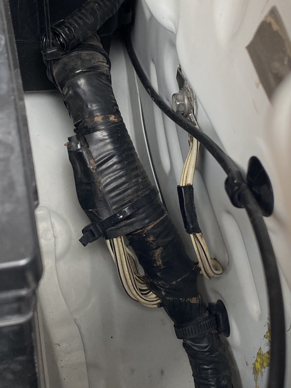

    Does anyone have a photo of the harness coming off their EB ground? Does it look like a birds nest of white(ish) wires? Just trying to see if maybe the dealership I purchased from started modifying something and then stopped. It just doesn’t look “right”.

    EB?

  18. Dec 23, 2019 at 8:40 AM
    #558
    CttAznRanger
    CttAznRanger Crazy NE Asian with the Cali Lean (temporary)
    Dec 3, 2018
    #274702
    4,748
    Brandon
    Boston, MA
    2018 Tacoma TRD Sport
    Could you post a reference picture of yours? I would also like to see if there are any differences.

    I'm pretty sure mine is identical to that. With the little plastic caps on the end of the wires.
    Although idk if mine has tape on it
