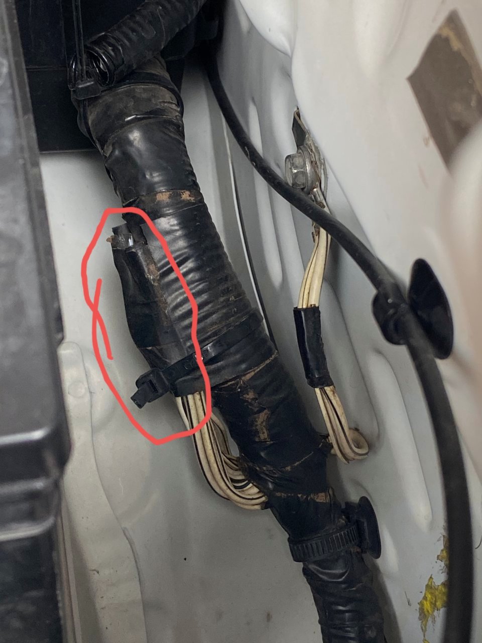

    Are those your zip ties?

    Not 100% sure, but I usually cut them off.

    Mine is the same as yours
    Exactly the same as my 18 sport.

    Same.

    Thanks!

    These junctions on the vehicles I work on can occasionally be a source of issues. This looks like a ground termination connection. Grounds from multiple sources joined together and then grounded to the chassis. Sometimes they don't seal or get soldered correctly and cause ground fault issues.
    Also that zip tie should be cut flush! The person who cut it like that deserves to have his hand dragged across the razor sharp end!:annoyed:

    You think a ground bus bar connected to the chassis ground there and then each of those grounds individually would worthwhile?

    That is a lot of work, but if Toyota doesn't find a fault and you have to repair yourself, then it may be worth while to open it up and make sure there isn't a problem. A ground block would be good.

    I'd peel that tape back and make sure there aren't any Pierce marks from them probing.

    Older post now, but for the record, Toyota does not use solder in wiring harness or junctions. I'm not sure what method Toyota is using in this particular case, but in similar junctions they're either crimped, or using some form of cold pressure welding/adhesive technique that is then covered with anti-corrosion grease and a rubber cap.
