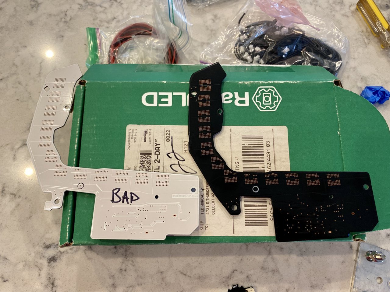

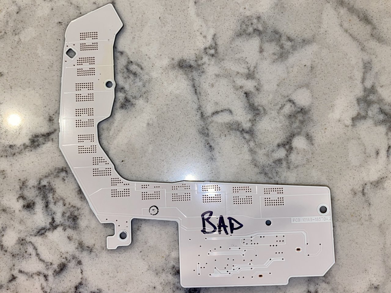

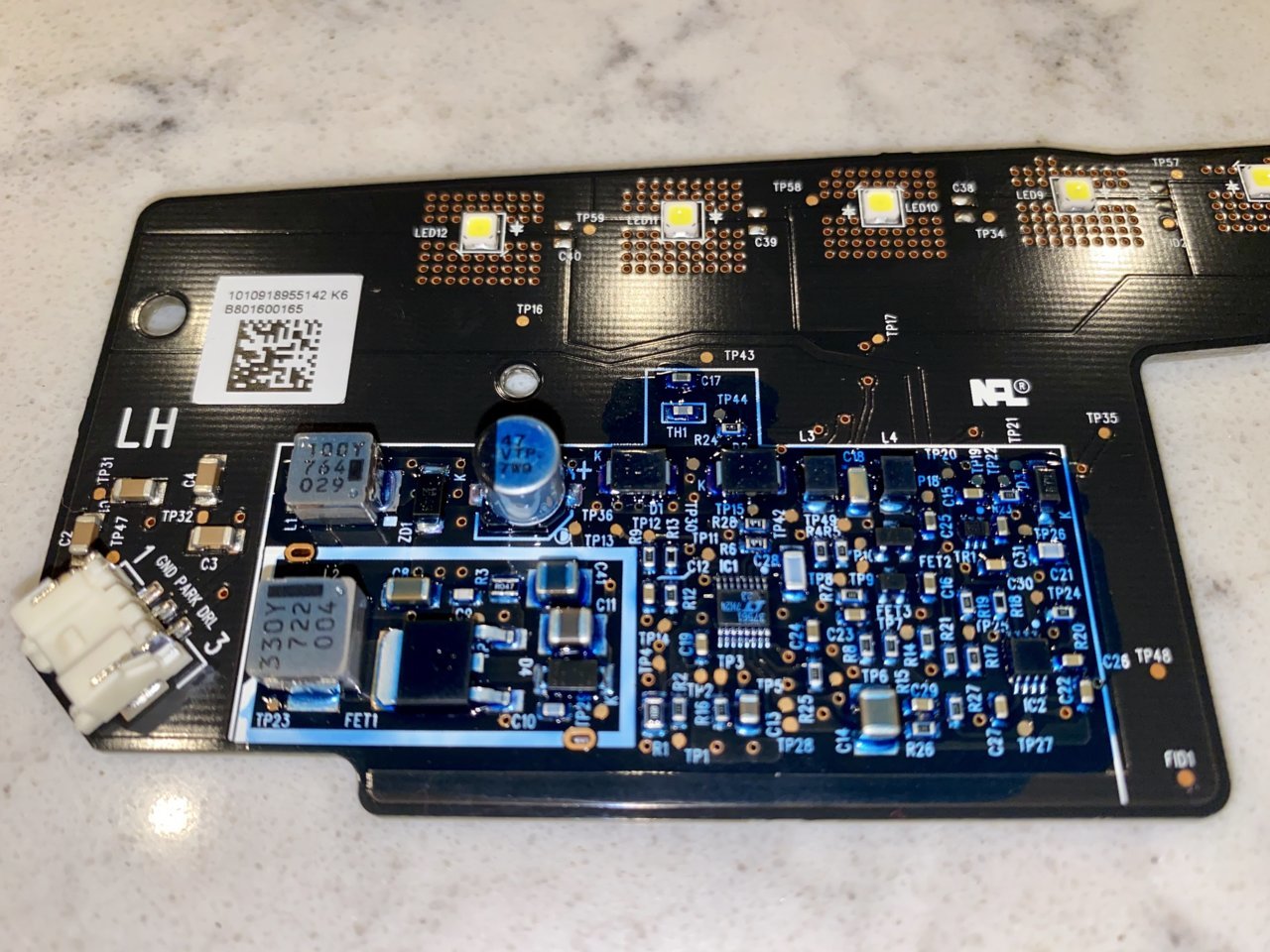

    Well, first thing you notice is the boards are different:

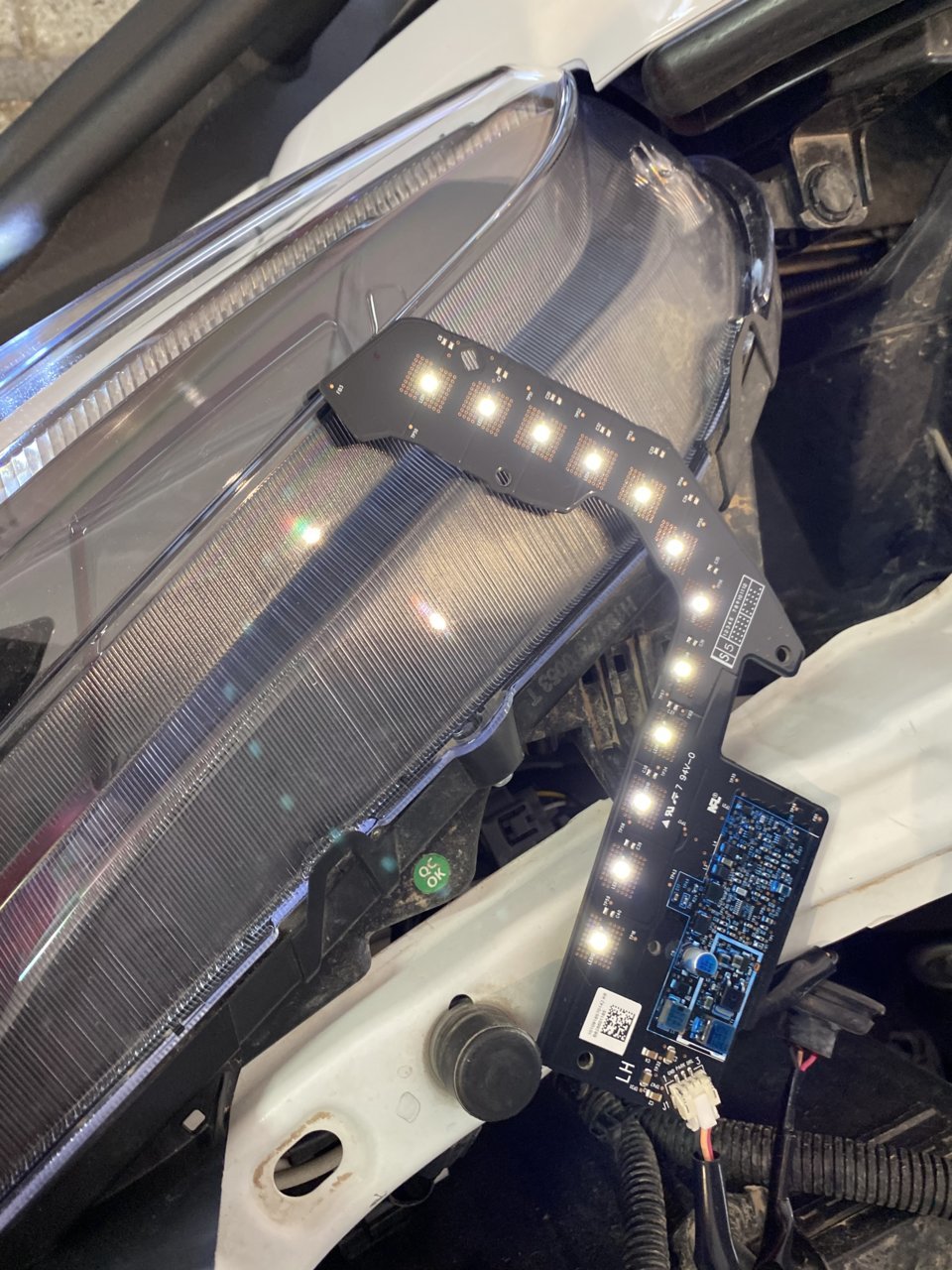

    Also...the new board works:
    More to come.

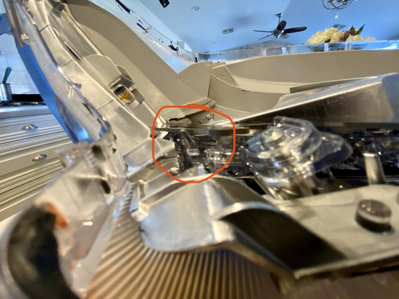

    Tested each LED chip on the old board and they all worked. Must be the driver, nothing noticeably damaged though:

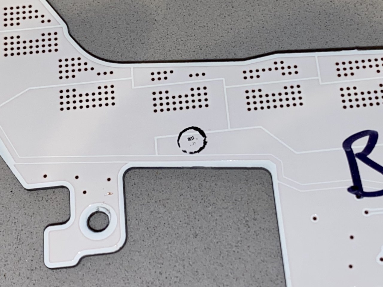

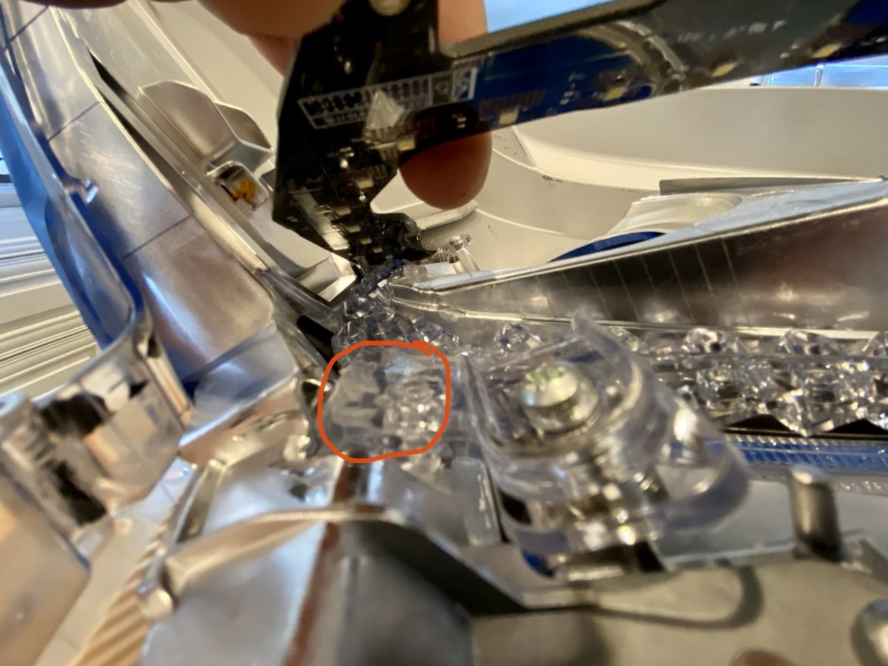

    This is the only “potential” visible defect on the old board:

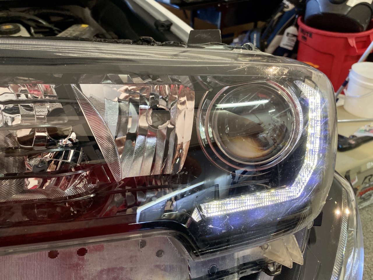

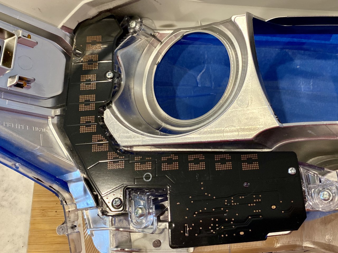

    Had to remove a little alignment tab to get the new board to fit. Didn’t seem necessary anyway. Each chip fits in the optic properly, each screw fits, and the other alignment tabs still function:
    Did a hack job opening it up, and used a TON of retroseal rubber to seal it back up. Still need to polish it out but the new board works:
    Not sure what testing I can do on this old board, if any, but I would be interested in finding out why the boards are different and if they came from different suppliers or different batches or something along those lines.

    pros have different boards from what I understand

    I wonder if the pro board is functionally different in any way?

    Got a good pic of the other side of the white board?

    The pins on the boards look to be the same old to new. It just appears to be the colour. Is it possible that the black would be for the dark style headlamps and the white is for the chrome style headlamps. It also could just be manufacturing changes. I will check my truck in a bit and see if I can see what colour the board is.

    The pins do appear to be the same, but it’s clear that there are different batches of DRL boards now. I wonder if Toyota did any actual testing on my previous failed boards or can track them to a specific batch/supplier/factory/etc.

    Oh. Both black on the LED side. My theory is bunk. Please ignore it :rolleyes:

    The new board also seems to have a similar “circle” so that leads me to believe it’s not the failure point.

    Circle looks like a qc stamp to me.
